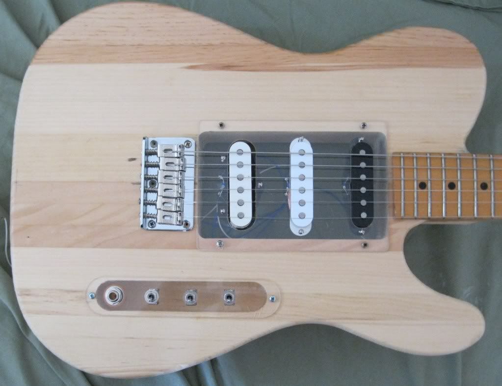

I have been wanting to try out some different pickups and control layouts, so I am building a hard tail dedicated to that. The rear access plate will allow pickup changes without loosening the strings. The pickup cavity is sized to allow P-90s, or anything smaller.
When I want to change the controls around, I will just plug the holes and re-drill. You may be able to see that I have already plugged one hole as I changed my mind about switch location.
Since this will always be a work in progress, I used no fancy wood, and I am not going for the ultimate in cosmetics. I did do my "gut cut" rear contour.

Almost ready for the first pickup audition -- a pair of Duncan P-Rails, with a Gibson T-top for comparison of the humbucking sounds. The P-rails have 2 pole 4 position switches for p90, parallel HB, series HB, and rail.
Body material is poplar. It has one coat of clear shellac and a couple coats of amber.

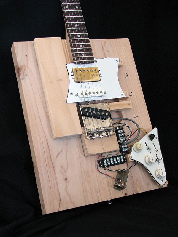

I built this one this past summer. Works great and pretty much the same idea.

Here is my question for Guitarbuilder: Do you think the test guitar gives a good idea of how the pickup sounds in other guitars?

I don't know yet...I haven't put the pickups in any guitar yet... I gave most of them away to friends and the two humbuckers I made during that winding session are still in the guitar..... I would guess that the isolation of the pickups from the surrounding body have an impact on the sound somewhat but like everything on an electric guitar, all elements contribute to the end result, not just the pickups.

Discovered the key to fast pickup changes is to glue the springs to the pickguard, or use rubber tubing instead of springs. This way the springs don't go flying when you reach for the screw driver
Added a terminal block for solderless connection of the pickup wire
Up now is a set of noiseless single coils with a couple of real Fender pickups for reference. Needless to say there is a lot of magnetic pull on the plain G. Neck pickup location is +/- stock, but I had to mess with the spacing to get all 5 pickups to fit.
