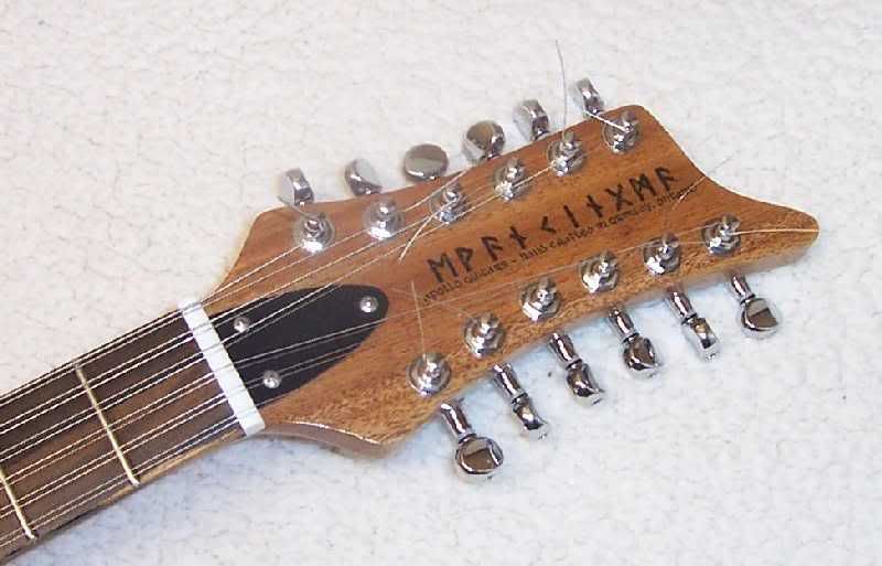

This is the headstock on the one and only 12 string I did.
Well, my son and I did it... his guitar... his design... looks pretty good IMO.
I like this. Looks like you kept things nice a tight so the headstock wasn't real long and has a curve. I might go this route. I'm thinking trying to have half on the side and half on the back using the slotted headstock might be more than I can handle cleanly.
