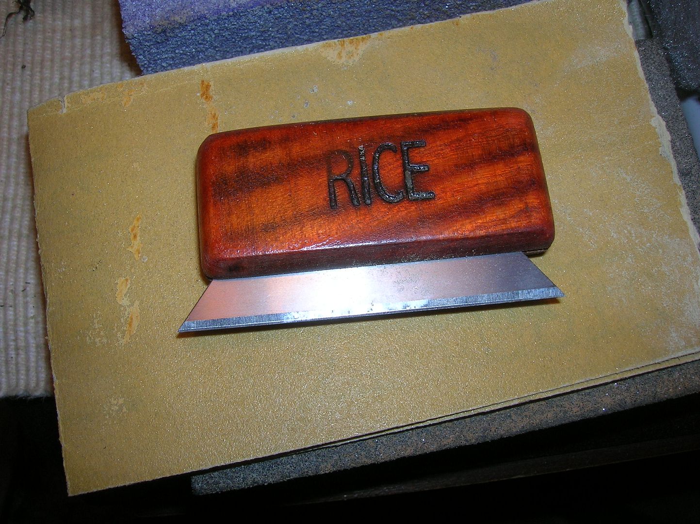

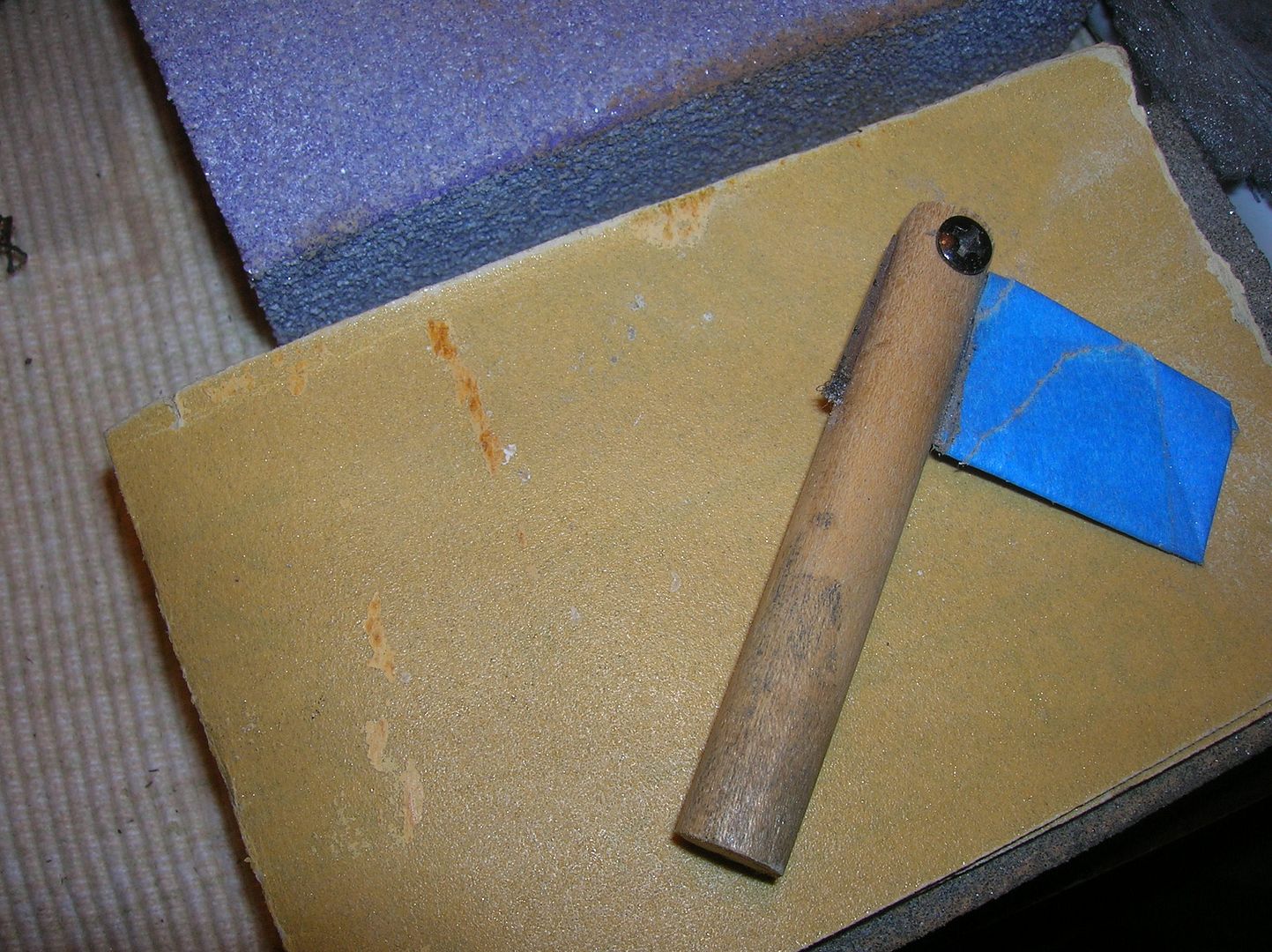

I bought a cheap set of scrapers that proudly display "Made in China" on them. They were nice and shiny when I got them, but once I wiped the oil off, they tarnished in about 5 minutes. I just file the edge flat to 90 degrees and run a screwdriver or drill bit across the edge to make a small hook. Works for me.
Also made a high tech binding scraper ala Buckocaster
Took about 30 seconds to make. One cut in the PVC with the bandsaw, slap in a blade & tape the parts you don't want to cut you. It's one of the best tools in my shop
