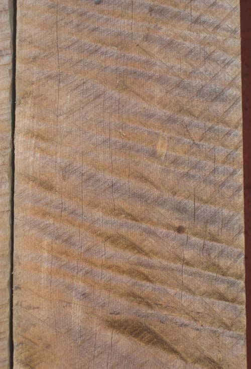

i bought 2 100 year old reclaimed tiger maple neck blanks from oldwoodworkshop that came from an old barn. they are both 30 x 4 x 2
here's a pic of 1. they were not cheap either.

Ok, so here's the barn from which I'm harvesting the wood. It's been there since the early 1900s - when we were still known as Indian Territory.
There was some newer wood in there as well, though I don't know how new. I found face boards pretty easily, but was having difficulty finding something for the bulk of the body. I wanted to find something that was already loose as opposed to pulling something off that was still attached. I ended up going to the loft and found a few pieces.
Here are the clapboards I brought back
And here's the rest. The 2 boards look quite a bit newer, but not "new", but the older header board is about 2 1/2" thick and is really old. Pretty sure it's original to the barn.
Now I need to make sure and get all the nails pulled, get my body stock milled and ready to glue, and get my face boards milled as well. They'll need quite a bit of stabilization because they're so weathered. Once I get some nice edges jointed on them, I'll probably inject some glue into the major cracks and see if I can get them to close up any. Once they're glued onto the body, though, I think it will all be ok.

Here's the body blank gluing up. Before gluing I took a wire brush and just cleaned everything up. My wife being a microbiologist was happy to see me wearing a dusk mask while doing so
There are quite a few small nails that I can't get out in one of the boards, but I've managed to position them so that all but one will be cut out in the waste, and the one that remains will be safe in the lower horn where none of the tools will come into contact with it.

This piece was 11 1/2" wide, but as you can see, it curled on the edges. So I ripped it down to 7" wide to get rid of the curls.
I don't have a riving knife or splitter on the ts, so the thought was to get close to my line with the band saw and then use a guide with the router the clean up the edge.
Bad idea. The wood is so weathered that it splintered pretty badly. Luckily I didn't do any real damage. I resorted to my hand plane and my plate glass/sandpaper rig to finish the edge. Here's a teaser (yes, I know the grain is facing the opposite way on each half ).
