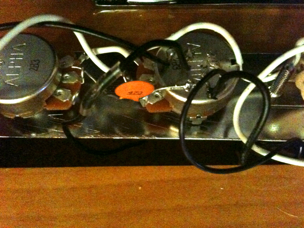

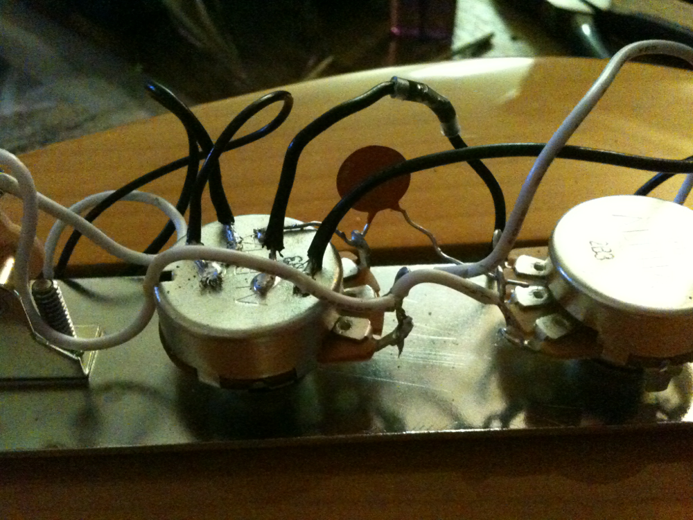

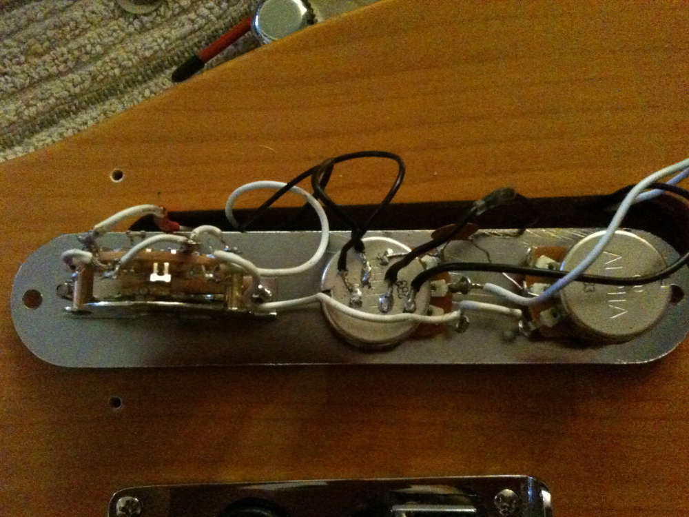

Well guys, you asked for it, so here you go. I got frustrated today. Took out the pots, and put it brand new ones... Might as well start from scratch. Pictures below:
I also recorded what the guitar sounds like... You'll have to turn your speakers up, but what you're hearing is me pressing the control plate and letting go, on and off.
http://soundcloud.com/jaredcohen/tele-ground-hum -- sorry, I tried to just have it play the MP3 here in the post, but it kept giving an error.
I'm now using the standard Tele wiring, straight from Fender, with the addition of the bridge ground added to the Vol pot. Both pickups give signal, and strangely enough, the ground hum is loudest in the MIDDLE position, but it occurs in all 3.
I copied the wiring from the "60s Tele"... but should the metal casing on the neck pickup be grounded? It's the last thing I can think of. The switch and pots are all different since I started this project, so I think I can rule those out as the culprit.
Thanks again everyone. I just want this thing to work...
jaredmcohen is offline   Reply With Quote

Normally the metal cover on the neck pickup is connected to the negative = ground.
How is the bridge plate grounded? With a loose wire pressed between the bridge plate and the body? (That connection can turn bad, leading to hum.) Or is it soldered?
Have you done any shielding of the guitar?

Thanks Lars, you know, this guitar didn't have the neck pickup grounded when I bought it and the 60's Tele wiring diagram doesn't show the neck pup grounded... should I throw in a neck ground anyway?
I haven't done shielding... but it's feeling more and more like I'm going to have to try. It's just frustrating because there was no ground hum before I got the brilliant idea to do the rewiring myself.
As for the bridge plate, it's a Squire Affinity body, so the ground wire comes up through the pickup cavity and rests in a cut-out under the bridge plate. That's all, just contact, no solder.

The cover on a Tele neck PU is grounded by the tabs that fold over the plate or by a ground jumper. There's no need for a separate ground wire. That would only be needed if you were isolating the ground for phase reverse or some other custom wiring.
Also, since touching the bridge or strings quiets the guitar, your bridge ground is fine. If it weren't making contact, the hum would stay the same.
I listened to the clip you posted and I didn't hear anything unusual. Some hum is normal until the player is grounded thru the strings. If it's so quiet that you can't record and listen to it without cranking up the volume like I did to hear it, it may be just the normal hum associated with single coils or some level of gain in the amp.
I also reread your OP. You said you replaced a PU. If this new PU is higher output, you might have a higher level of hum that's different enough from the other that is leading you to think something is wrong. Maybe that new PU is faulty or wired backwards. I say this because the hum gets worse in the middle switch position...it should get quieter.

My MIM tele makes absolutely no noise. Ever. No hum, no nothing. Maybe my expectations were just too high?
I can definitely hear the hum, but if that's normal-ish, then I guess I can take comfort in the fact that I wired it right!
Thanks for all your help everyone.
