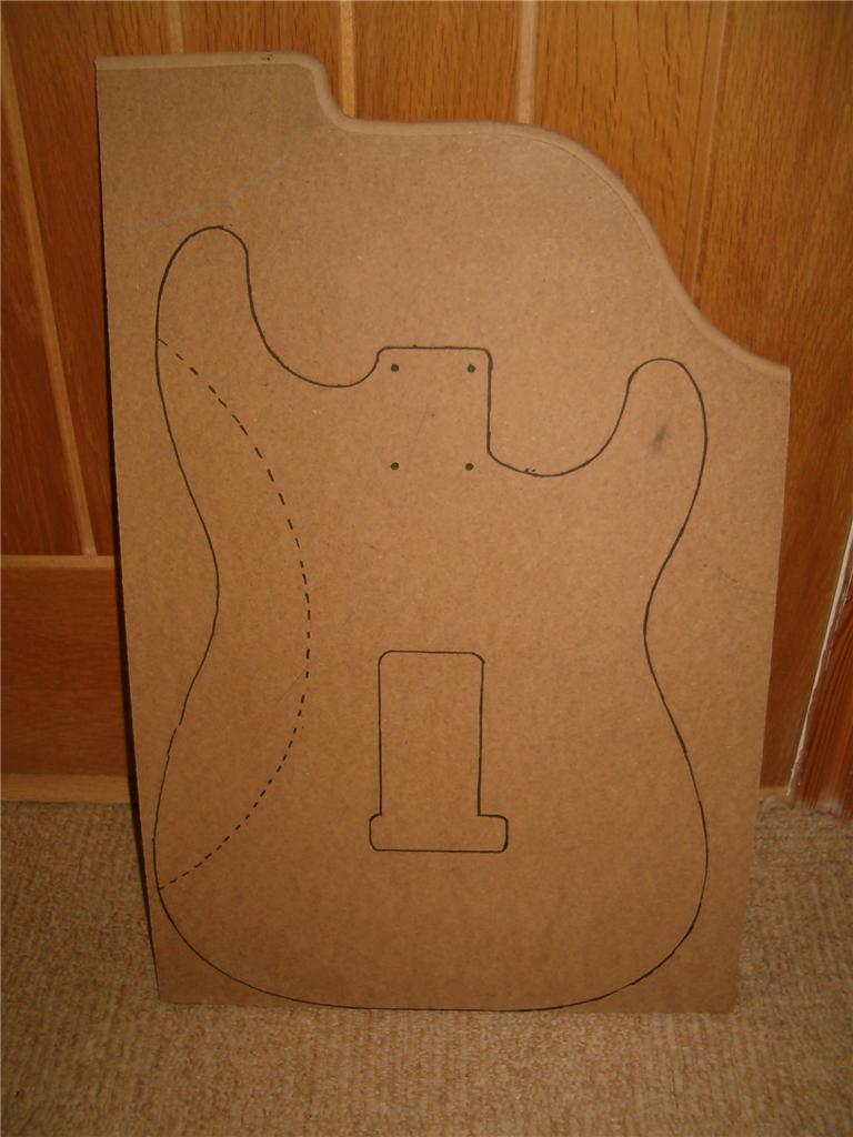

MDF template Build Process

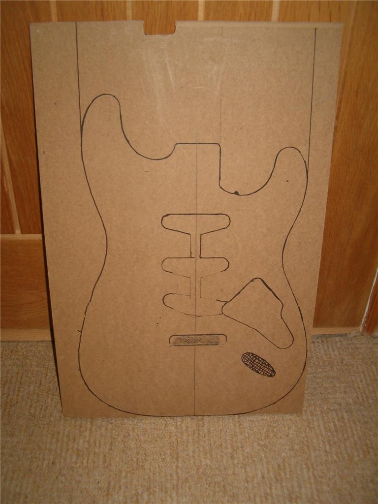

Hello to all, i'm relatively new here and have been enjoying reading the hundreds of threads that tdpri have to offer. I have built guitars my whole life, partscasters and scratchbuilt. But have decided to enter the inevitable realm of jig building so i can build guitars more efficiently in future. I thought i would document my builds in hope that someone else will find them useful.
First build is mdf strat templates, (with no master to work from, and limited tooling) I'm making vintage strat templates from an online blueprint.
First pics are the templates drawn out onto mdf, apologies for my poor scribbling skills, but i understand it well enough ;)

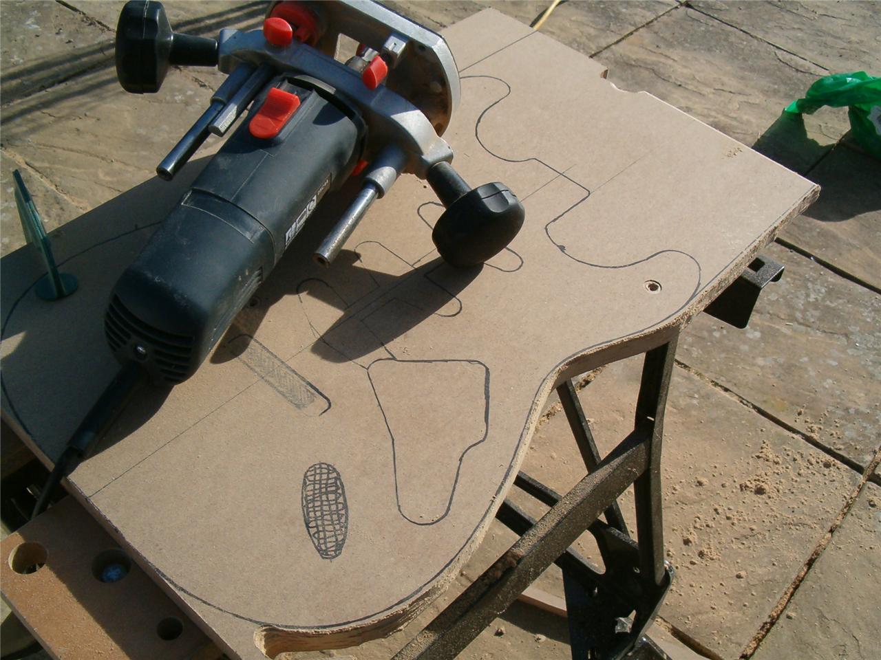

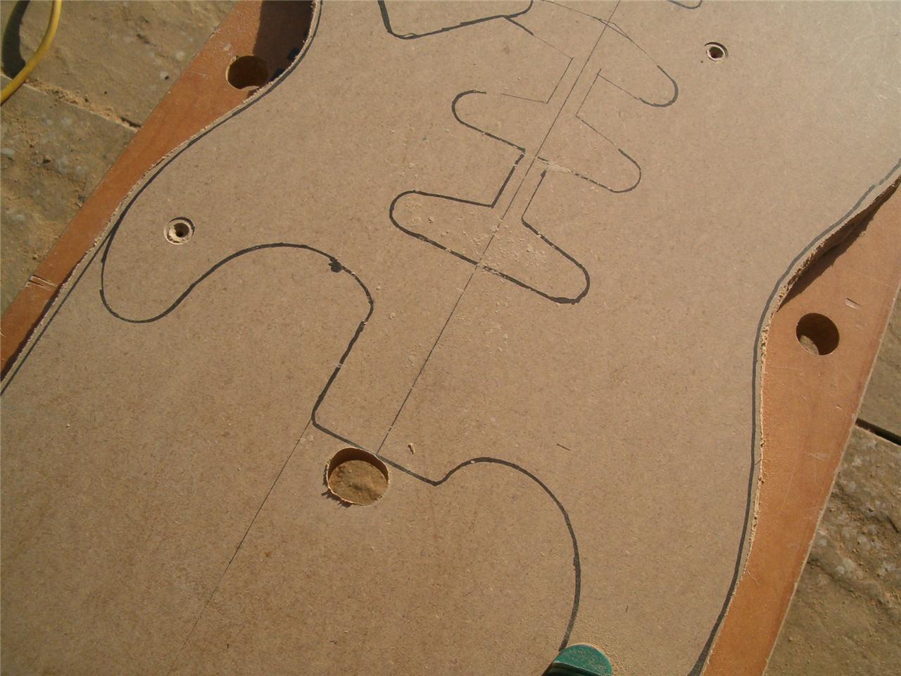

Began today
Today i began on cutting the template, i'm doing it whenever i get a spare few hours and in a particular order to ensure accuracy. Tasks achieved today: Outer shape rough cut, holes drilled and countersunk for tempalte attachment.
Holes drilled with a hand drill and countersunk with a router bit.
Using the router to rough cut as i have no band saw and refuse to do it by hand ;)
Shape now roughed out and ready for precision cutting tomorow, i routed a big hole near the neck pocket for a purpose. I am going to attach the template to a guitar body that i allready own, i will use a flush trimmer to cut the template neck pocket to ensure perfect dimensions on the template.
Thats all i managed today what with breaking a drill bit and the usual interuptions! Back tomorow to update on shaping and flush trimming.

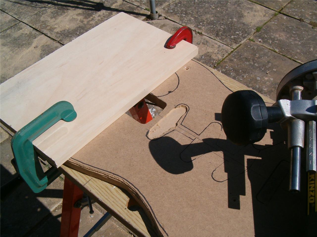

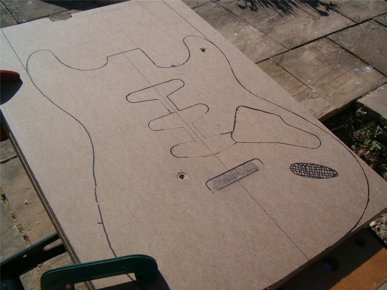

Old May 8th, 2012, 12:22 PM   #14 (permalink)
Join Date: Mar 2012
Location: England
Posts: 5
...fate has struck again.
Hello again all,

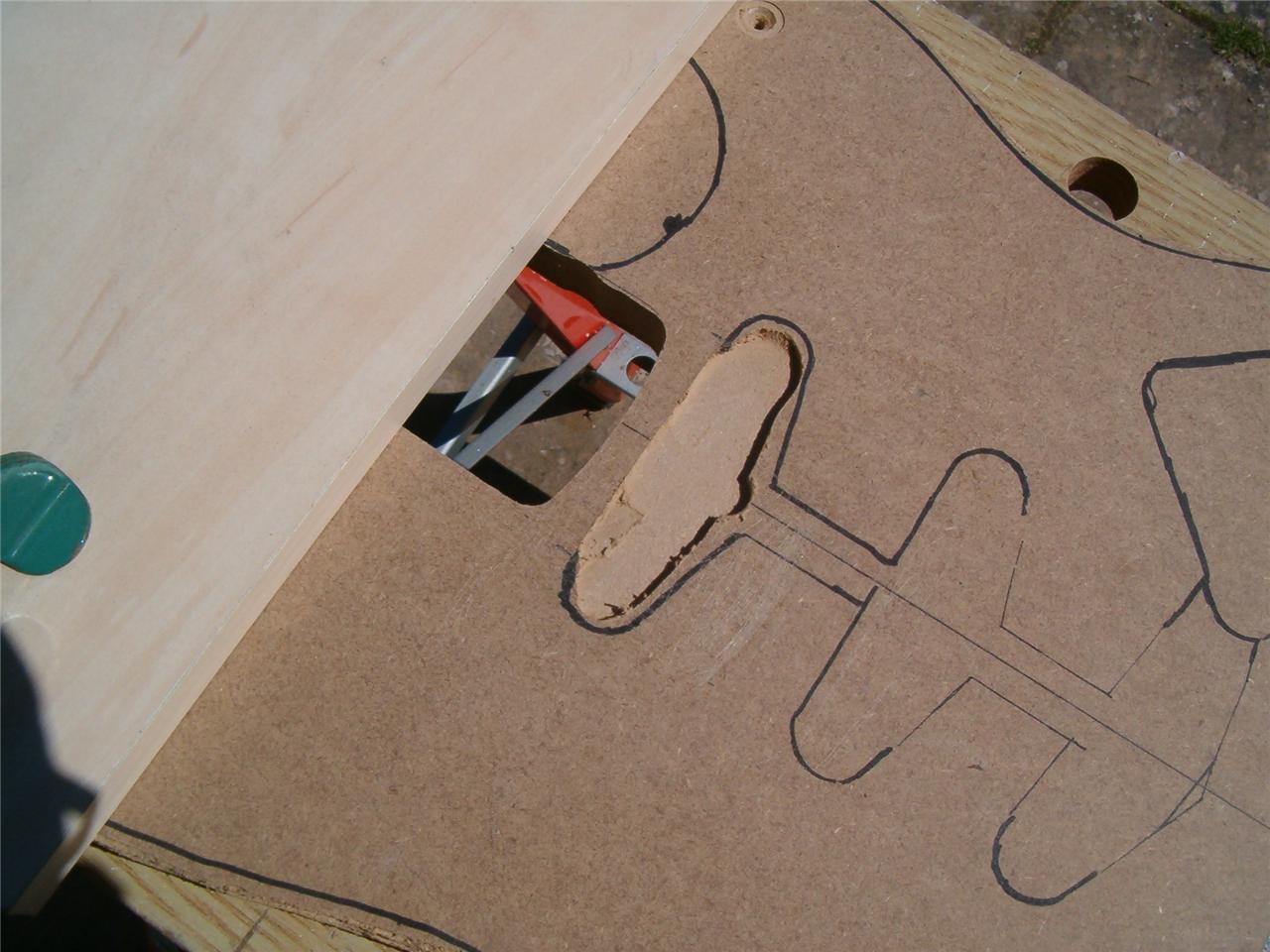

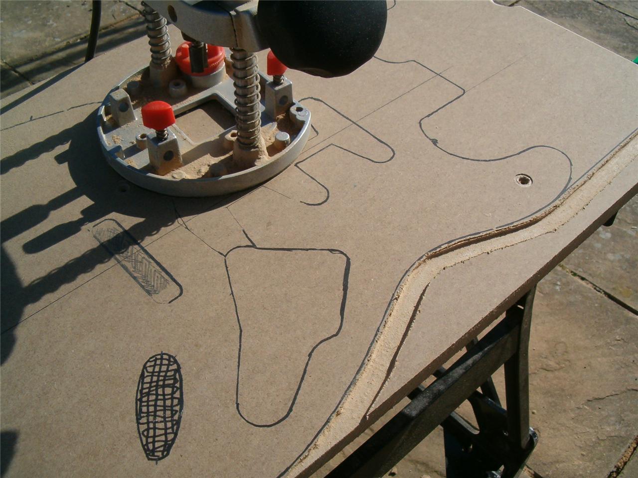

Finally the rain has eased off and i have finished slabbing so today i could dedicate a few hours to my template build. (Or so i thought)

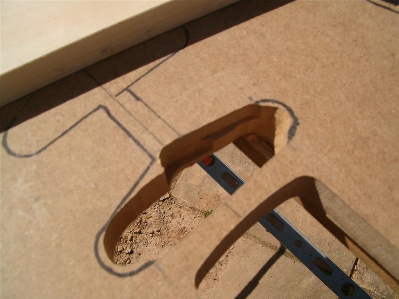

I Picked up an alder body from guitarbuild.co.uk a while back, (Strat shape and neck pocket allready cut, saves me time in the long run). So my idea was to attach my template to the body and use my router to flush trim the neck pocket from the pre-cut one. Well i didn't get any photo's of that process, i was a bit focussed on getting that right, but it came out perfectly, my mdf template now has a perfectly aligned and cut neck pocket. (As you will see in the pics).
I also decided to start on the pickup route, with no master to work from, getting nice straight edges is my main hurdle; i overcame this buy clamping a piece of wood with a straight edge, parallel to the straight line i need to route along. Now all i have to do is run the routers flat side along the wood and it routes perfectly straight. :)
Above you can see the complete neck pocket, and the top of the pickup route has a nice straight edge, after a few more passes the edge was done. Next i was going to happily do the same to the two bottom angles of the pickup route, just got started on the one side and the router conked out; the bearings are...(As we say in the business)...shagged. Well new bearings shall be picked up soon then i can get it completed. This is where i got to.
Now to get the bearings asap, ask the man upstairs for good weather and get the template done. Sure would be easier with a master to work off, but i do like to suffer.

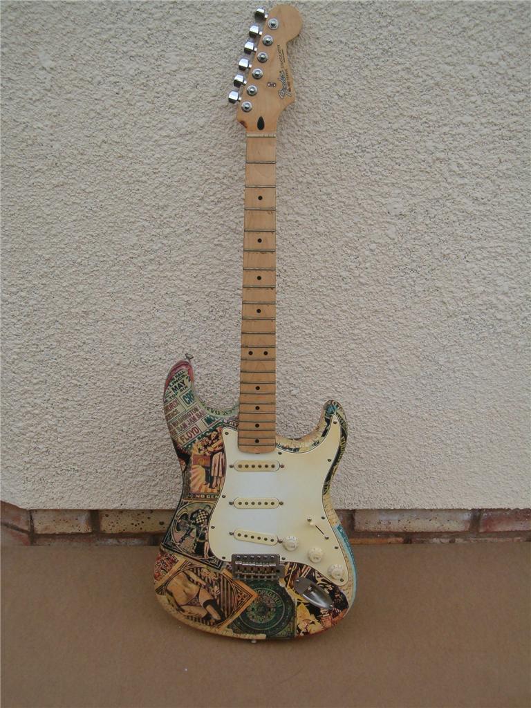

P.S. Quick piccy of my Fender MIM standard that is being auctioned, wondered what the opinions were of my mods? :P
