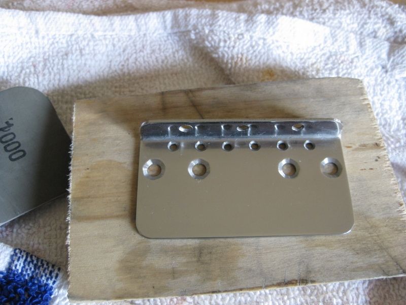

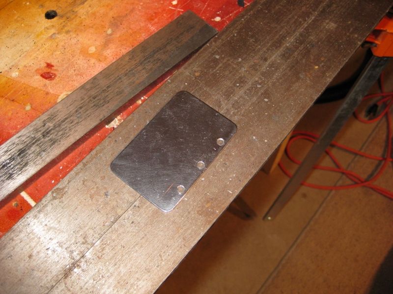

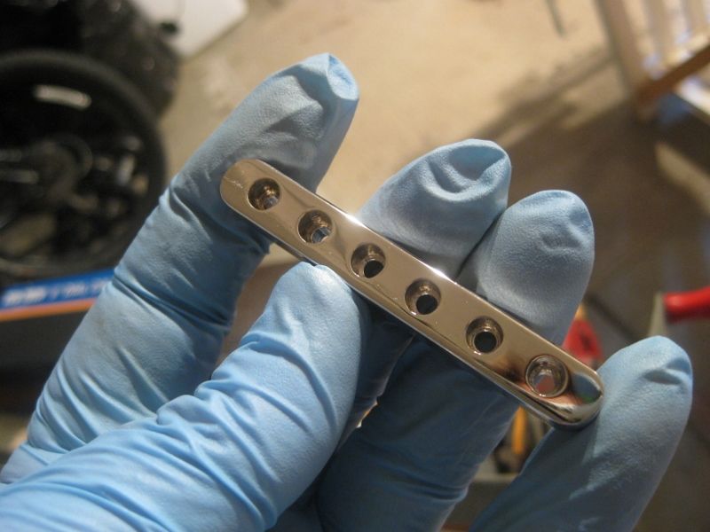

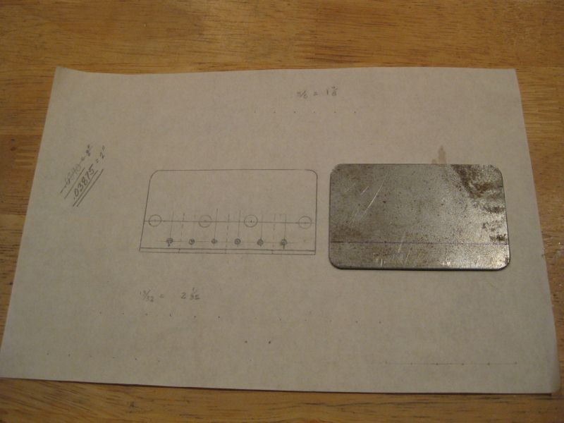

I thought it'd be a good idea to do a little polishing and drill the holes for the adjustment bolts on the back edge before heading to the brake to bend it.
I managed to scratch things up pretty good drilling the rest of the holes, but with a little elbow grease, I was able to get a decent surface going on.
A few more hardware pieces left to make and I'll move on to making some templates.

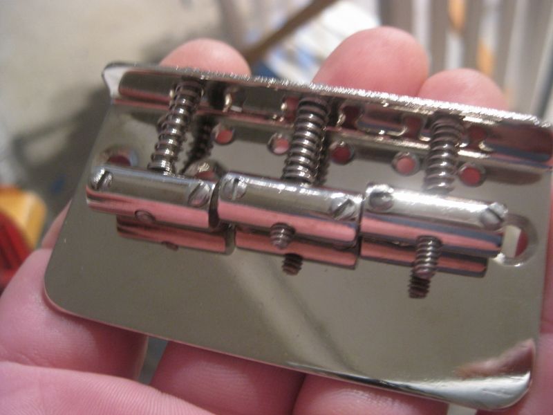

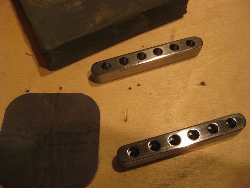

Next up, trying to make my own barrel saddles. I don't own any kind of milling machine, just a drillpress, so I had to figure out a simple way to hold the material and guide the drill bit to reduce wandering. That became especially challenging on this threaded 5/16" brass. So I sacrificed the ends of this aluminum (which I was saving to make tonebars with) to make a drilling guide. It's pretty self-explanatory. Set up to drill the height adjustment screw holes:
Pull the whole works out of the jaws and lay it flat to drill the intonation adjustment screw hole.
Then tap with 6-32 threads.
I cut some stainless 6-32 bolt to length and cut a slot on one end for the height adjustment screws.
Then lastly, I'll need to cut to length and polish all those burrs that developed during drilling/handling.
The plain rod guide works the same way, but instead of using the threads to hold the rod in place, I drill the adjustment screw hole first, pin that with an old worn out drillbit, then place the guide block upright in the vise and drill the two height adjustment holes last.

Thanks Glen...unfortunately the tune-o-matic and tuning machines didn't work out so well, and there's enough metal shavings on my garage floor right now to prove it!!!
Originally Posted by Novatuc View Post
What a great idea for guiding the drill. Kudos to you.
Thanks! But I think I must have stolen the idea from somewhere. But I'll take the credit for coming up with it anyways
Nice drilling guide Craig , I might just have to aaaah borrow , yea that's the ticket , that idea
Oh, wait a minute...didn't I borrow that idea from you???
Kidding aside, it would be much better if the block was something harder, like stainless. I'm afraid that after drilling a few more of these, the guide holes will get widened out by the drill bit and it won't work so good anymore. We'll see. At least I got one set made.
CraigB is offline   Reply With Quote

Honestly, I can't see how the challenge contestants pull off building everything so fast while I'm still screwing around with this stupid bridge, but here's the finished saddles, polished up.
I screwed the finish once again on the bridge plate test-fitting the saddles At least I've gotten to be good at something!
This little dremel bit did come in real handy for getting the burrs out in between the threads. I tried sanding, filing, wirebrushing, but that thing smoothed things up real quick, and then followed up with the wirebrush wheel to polish.

Awesome job on the hardware. Right now I'm about to mod some strat trem plates into hardtails. Question, does the thickness of the height adjustment screws get in the way of the string spacing? It looks a like it might in your pics.
Good point. I measured the outside spacing of low E and A strings and they'll brake over the top of the saddles between the screws without being pinched. I think I may need to grind off some brass if the coarseness of those threads binds on the strings, though.

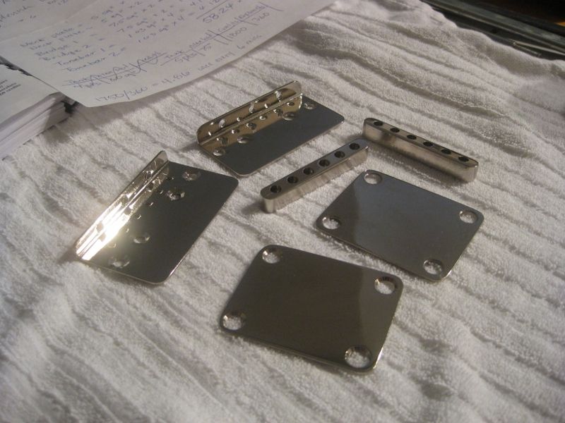

Thanks Herb! I made another bridge plate just like it and a couple neck mounting plates that turned out pretty good. But botched a third plate which would've given me enough parts to make a batch of plating brew. Maybe this coming weekend.

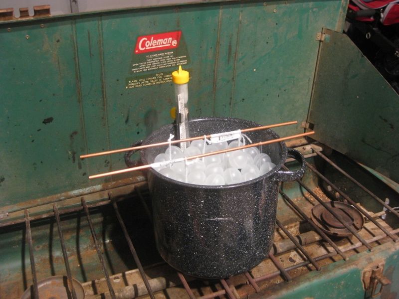

I was planning on plating a set of steel barrel saddles, but I'm wondering how to hang those off the top of the tank. Fishing line Wonder if that'll withstand boiling temps.
Also wonder if the plating will be thin enough to allow the adjustment screws to fit into the threads...hmm.

Hey Craig , use heavy cotton sewing thread to hang your saddles in the mix , I would pull them after 15 minutes , plate thickness shouldn't be a problem in the threaded holes at 15 minutes .

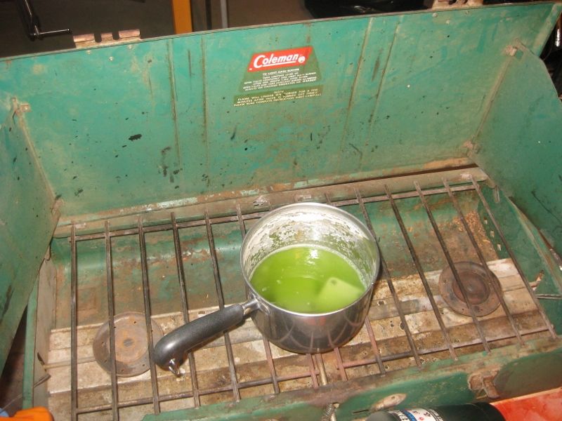

plating success!

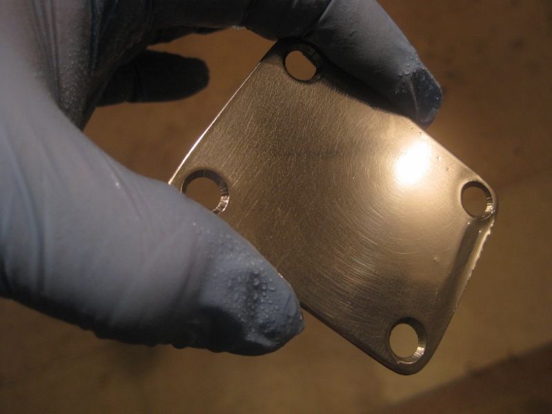

Put the parts into simple green for degreasing, heated up. Then rinsed in distilled water. The water still beaded up, so back in the 'green' one more time
then water break test again, the water sheets right off, no beading.
Rechecked my calculations to make sure I mix up the bath and replenish on the right schedule. Heat it up to 195 degrees, then in the tank with the tonebars, neck plates, and bridge plates. Can't really see what's going on in there with the mist balls in the way, so cross my fingers, replenish, wait, replenish, etc....
then at the last replenishment, I put the bridge saddles in the tank. I don't want as thick of a plating on them because I don't want to have to re-tap for the adjustment screw holes. A couple last minutes for the larger parts and out of the tank to see how they look and rinse.
Oh yeah, looking good!
A total of 15 mins for the saddles and out of the tank
and here's what the assembled bridge looks like.
Now out to the backyard to get some templates made!
