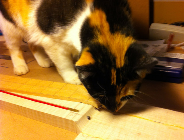

Today I had some help in the basement:
That's Scout, she's inspecting my cuts on the fret board.
Before cutting any slots, I marked the depth that I interned to cut to on the side of the fretboard - just under 3mm. This compensates for the eventual 14 inch radius of the fretboard and the frets.
While I did set the miter box guides to keep me from cutting too deep, I made sure to check each cut just incase.
After cutting the slots, I cut the shape of the fretboard just slightly larger than the neck. I will clean this up with the router after glueing the fretboard to the neck.
