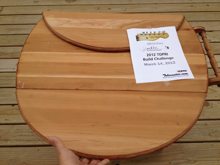

Here's Mom's old teacart. It originally had a transparent reddish-tinted finish. When I was in high school (early 1970's) Mom had painted it with avocado green enamel to go in our kitchen. It did many years service as her microwave oven stand.
It used to have casters, and it has 2 drop-leaf side pieces so it could be used as a round table. The handle (stuck on with double-sided tape for these pics) was hinged and would drop down out of the way when used as a table.
As I mentioned earlier, Mom had given it to my wife and they had stripped the finish in preparation for a re-finish job that never occurred.
The top and 2 shelves are roughly 3/4" thick, so I can laminate those and they'll be plenty thick for a body. The top and shelves are all made of strips ranging from 2" to 3-1/2" wide. The top is roughly 30" x 18" and the shelves are roughly 26" x 16" -- plenty of space to cut out a tele body shape.
I'm planning on probably staining it red and applying a Tru-Oil finish. I will be using black hardware. Probably no pickguard, rear route with no front control panel. Black Tele-style tone and volume knobs and a Gibson-style pickup toggle switch. Black hardtail bridge. Black locking tuners.
