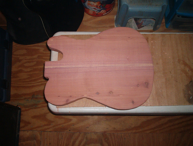

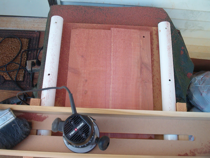

Oh well, I've been doing a little each evening and this is the result
Got my body planed down (did find out I should have put stops on each end, nicked the pipes ), this is the front side
Doing the back
The top (which will be covered)
And the back, which will not be covered
The body, ready to profile sand
Here is the spalted maple top being glued up. Out of the two I have, this is the least interesting. The top is going to be very "busy" anyway, and would take away from the fine pattern. This one isn't chopped liver however
BTW, the orangish smearing is from the shellac I wiped on the endgrain to prevent splitting. It won't be there soon

That's for sure! I usually spend all day at work....I mean on my lunch hour...watching threads just to keep caught up
That's puuuurdy, Dave

I like that cedar, Dave, and also the attachments you got
for your WorkMate. I have a small router table top for

Mmmm, chopped liver!
That (not to be covered) back is pretty.

I don't care what anyone says about "minds". I've always been a "body guy" and I like
that one! Love th e "white" meeting at the joint.

It's looking good Dave. Are you going to leave it a natural finish? Is that aromatic cedar? Must smell nice.

I can smell that cedar all the way up here , that combo of spalted maple top/cedar body is going to look great , the sides will be a nice contrast , what are your finish plans Dave ?

Thanks, I wasn't too high or low on it, but now that it's cut out.........I'm in love
Aromatic? Yeppers, between my room (where I store it), the back porch and the workshop room, it's like one bloody great potporrui bowl As for the finish, that follows
Well, until I cut it out, the plan was for Tru-oil except for the fretboard, but the body is quite dry and a little chippy (by ring count, it's well over 50 yrs old and had been air drying over 5.I have one small tearout to fix already ). I'm sticking with dye & tru-oil for the top, but have decided to do gym floor poly applied butcher-block method (hard, glossy, and takes about a week to cure, but doesn't require brushing or spraying )
The neck with be tru-oil (possibly tinted) and lemon oil on the fretboard. I can't wait until you see the fretboard, I haven't gotten Indian rosewood that dark in 20yrs
