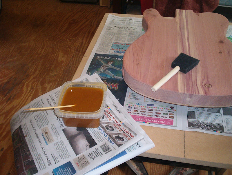

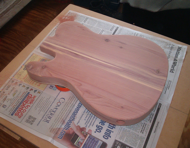

Back at it again!
Here I'm using the mouse for the 320 grit and the rubber block for the 400 (interesting that you can't get 400 to fit any sander that I could find, and the 320 for the mouse had to come from Amazon )
I'm using this sponge sanding block wrapped in 400 for the sides
Here we are, sanded to 400 and wiped down with denatured alcohol
Getting ready with the tinted clear shellac for my primer coat (otherwise I wouldn't have used a foam brush, it streaks ). Most of this will be sanded off
Now for a couple of coats
Mmmm.......ehhhh, I'll be back a little later, gotta go change my shorts

Very, very, very rich color! Beautiful!

Holy Moly ! Unreal, beautiful Dave.
Now that's what I call kicking it up a notch !
I'm actually kinda speechless
Yeh, I'd have used a brush if I'd known it was going to look that good. If the poly looks any better than this I'm not sure the old ticker can take it
BTW, a big thanks Allthesound, Mojotron, and CarlosN. My hands are still shaking, and yes, the foam brush streaked the back . It's just as well, as good as it looks, I'd have been tempted to leave it as a final finish
