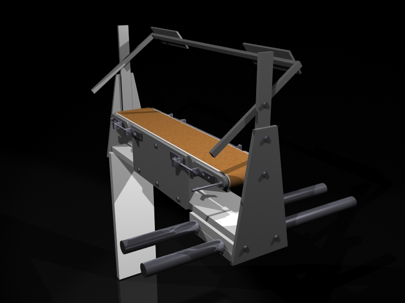

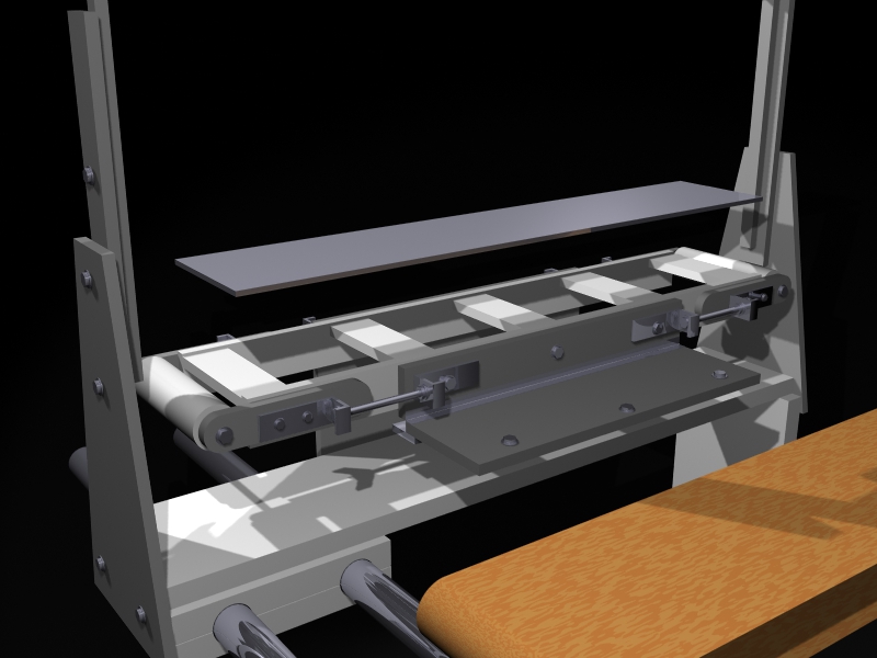

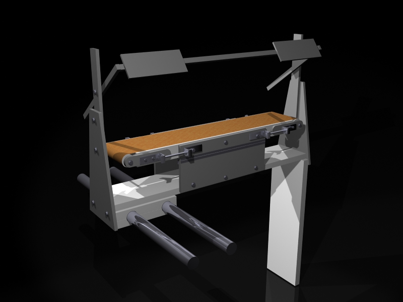

After seeing CptRyg's Shopsmith adaptation of the belt sander, I've decided to build one for myself. It wiil be powered by my SS Mark V and have a few design changes from the one he built.
Many thanks to CptRyg for his design and the info he shared with me.
First off, mine will be a direct drive design, sitting perpendicular to the SS instead of parallel which would require a right angle drive. I tried to snag a drive off eBay but they went higher in bid price than I wanted to pay. One less part to buy.

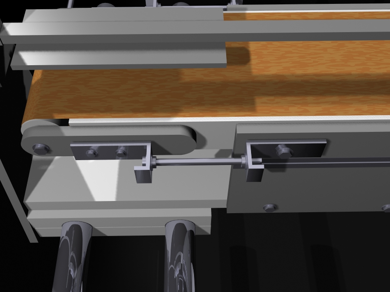

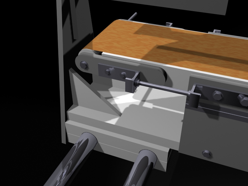

Second change is the belt tension setup. Instead of turnbuckles, I'm using opposing brackets that are anchored a bit better and I think will give me better micro adjustment. I have the mock up modeled with 4 tensioners but I may only need 3...1 on the live end and 2 on the free end. Not sure yet.

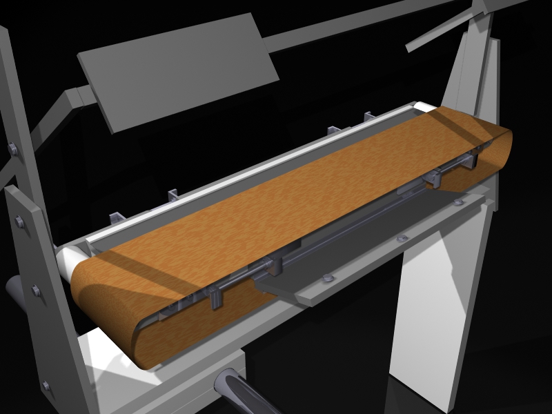

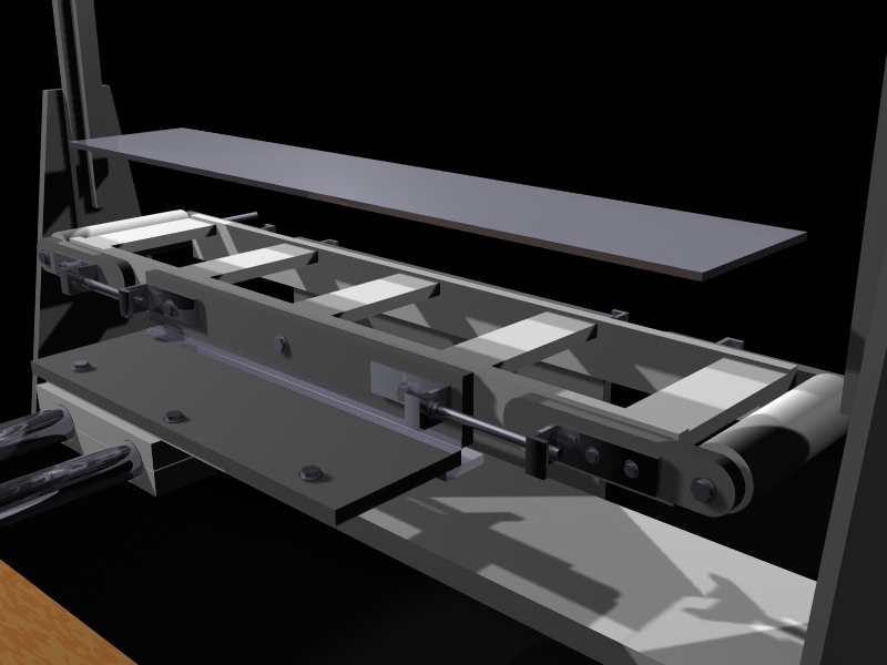

The front support panel will be hinged for belt replacement. The plan is to remove tension, unbolt the bottom of the panel and have it swing out to allow the belt to move.

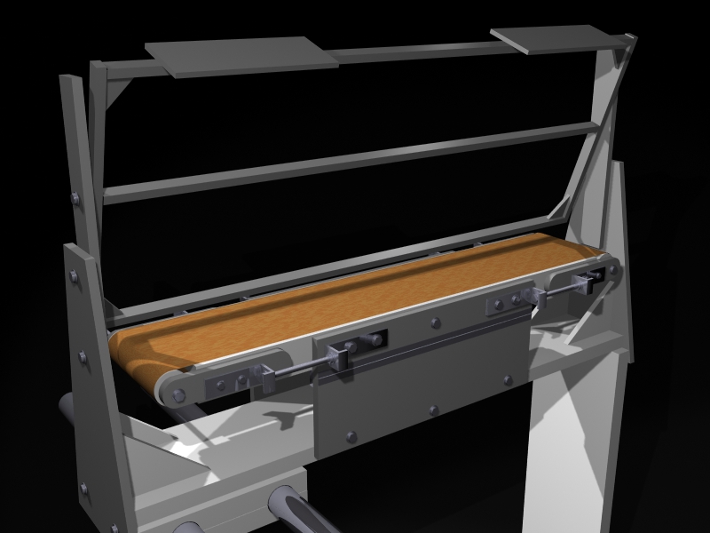

The live end will be clamped to the way tubes of the SS and the free will be supported by a folding leg...this will make storage easier when not being used.
The swing arm assembly will be removable so the sander can be used for other tasks. I will likely add a removable fence for use when the swing arm is detached.
The plan for the tensioners is pretty simple. The bolt head will be fixed in one bracket with a jam nut and the other end will apply pressure against the second bracket using a nut and flat washer and be adjusted with an open end wrench. The belt will provide counter tension.
The rollers will be 3" schedule 40 PVC pipe. It's OD is actually 3.5" inches with ID of 3". I wanted to repurpose an aluminum rolling pin but I can't see spending the money on one when the PVC is plenty strong. The sander's bed will be .25" aluminum plate 6" wide by approx. 32" long.
Mark

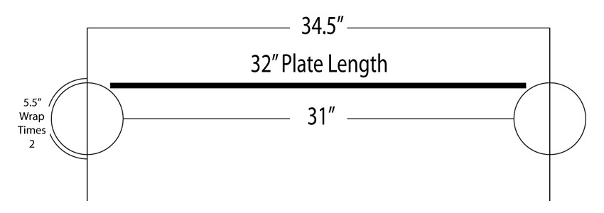

I don't have the sanding belt in hand yet but I plan to use a 6" x 80". That sounds like a huge belt but it will actually only net a 31" to 32" work surface.
With 3.5" rollers, I needed to determine the "wrap" distance that the belt would need. Diameter x pi gives me...
3.5 * 3.14 = 11.00. This would be the full circumference of a single roller. Since I have 2 at approx. half warp, 11" is the ticket.
80 - 11 = 69. Half of this, or 34.5", is the center to center measurement for the rollers.
Then I needed to back out the balance of the roller diameter to get the distance between the ends of the rollers. this would be 3.5" total...1.75" x 2. This gives me 31" where the rollers are closest together. I'll be well above that point, so I'm planning a 32" bed.

I added some additional bracing to the swing arm and added gussets to the lower table. Since I plan to radius fretboards on this sander, I want everything nice and square.

Great design work Mark , you make me wish for a Shop Smith

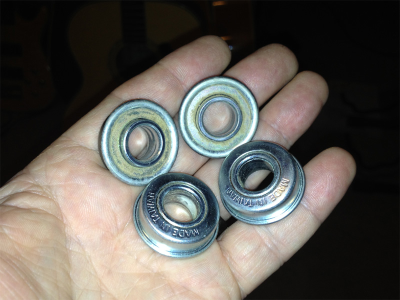

I salvaged some bearings from lawn mower wheels last summer. The plastic castings on the wheels broke and wouldn't hold the bearings any more but the bearings are fine. The new wheels came complete with bearings so...
Four of them as luck would have it. Just a shade over .500" bore, and total diameter of 1.25". Going with direct drive, I don't need to worry about matching or adapting a shaft to the axles so .500" is great. The lip on the housing may prove to be useful.

Thanks Herb. I could see this easily adapted for a drill press using a right angle drive or even stand alone motor drive. The great thing about the SS though, is it's on-demand variable speed.

Very cool (and too ambitious for me). Are you planning adjustments to the swing arm for compound radii?

It will have settings for various radii but not compound. I think I would need to incorporate a u-joint of some sort for that to work. I haven't thought that far down the road yet. Great idea though.

Sorry if you have already thought of this but it does not show in the renderings you posted...
I don't think the lawnmower bearings will do what you require from them. If the shafts are exactly 90 degrees to the C/L of the table they will probably be OK providing they are rated for the load applied.
As you say you will need the adjustment for the belt and this will apply an axial load to those bearings which they are not desinged for. You will need a set of "self aligning" bearings for the roller shafts and a flexible coupling for the drive as any adjustment of the drive roller will take it outside the C/L of the driveshaft.
Hope it all works out, as you can never have enough toys
Graham

Leave it to me to start at the end and work backwards, but that's what got me thinking about using a belt sander to radius a fretboard in the first place.
One end would have to pivot from a different height relative to the sanding surface yet still remain square to the workpiece, i would assume. That's the part I'm having a hard time wrapping my brain around.

Thanks Graham. It's not something I had considered. Certainly bears some thought. I just took off running with this idea and have yet to work out all the details. I'd be fooling myself if I thought I would get it right first try.
