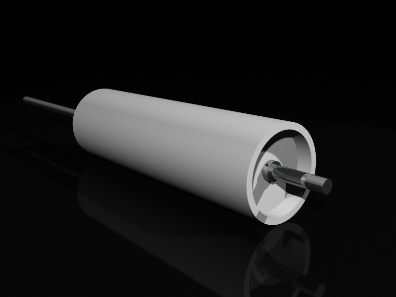

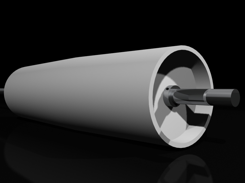

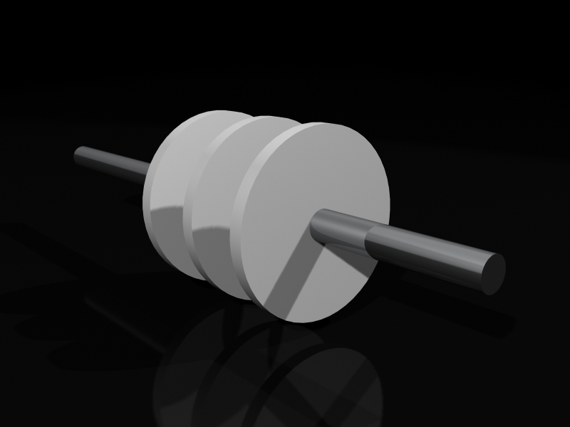

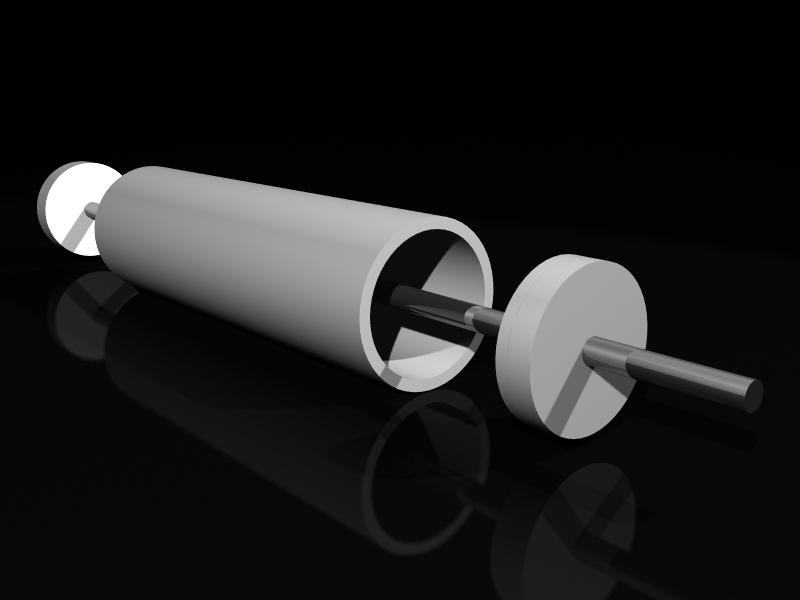

The Rollers
The PVC sheet came in yesterday along with the aluminum plate for the bed. The sanding belts should be here today.
My plan on the rollers, now that I have the PVC sheet in hand, is to use a 3.25" hole saw and cut out 6 discs per roller. I'm planning to use an oversize saw because the hole it leaves is 3.25" so the resulting disc diameter is under that by the thickness of the saw x 2, or about 3.125". After cutting the discs, I'll drill out the centers to .500" and slip them, three at a time, onto a piece of .500" rod, applying PVC primer and then cement and clamping them together. Then it's just a matter of chucking them up in the Shopsmith and lathing them to 3". This will also center them on the axle.
Once they're the proper size, I'll glue them in and stop collars will hold the axle in place.
Then that assembly can be lathed to create the taper on the roller bringing the ends down by about .0625". Very subtle. You can just see the bow in this render and it's slightly exaggerated.
Mark

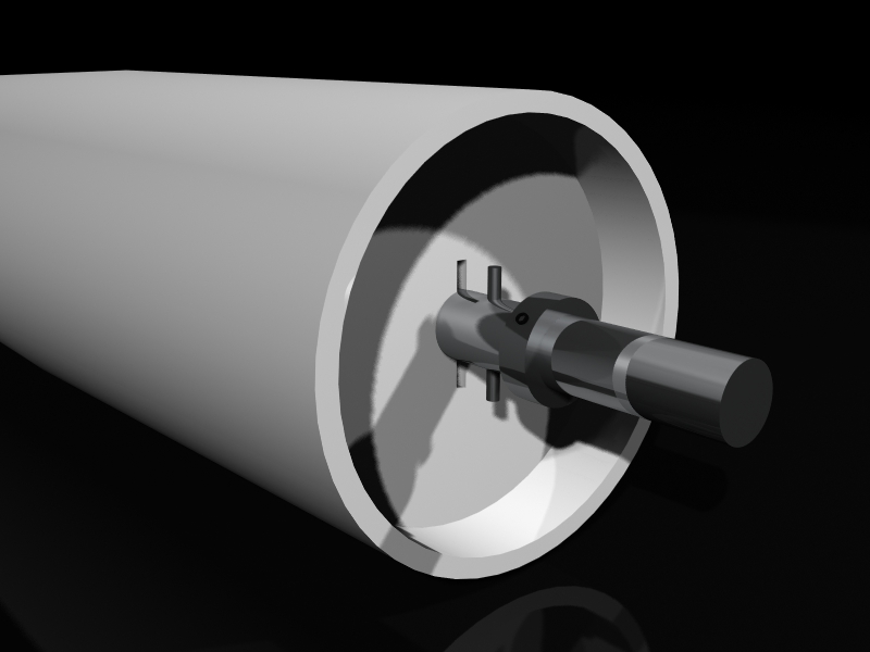

Hi Mark
How are you going to prevent the rollers rotating on the shaft?
Warnz is offline   Reply With Quote
Old February 22nd, 2012, 02:17 PM   #52 (permalink)
Posts: 3,841
Originally Posted by Warnz View Post
Hi Mark

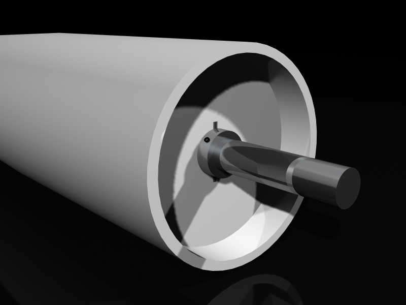

I still need to figure that one out. I need to pin them somehow or go with all-thread instead of a smooth axle. That way I can jam them with nuts/washers before I glue them in. That would mean trimming the axle to length afterward but that's doable.
I was thinking something along these lines. If I'm careful, I can pin both sides of the hubs for added strength. I may have to find a slower adhesive though. That PVC cement is almost instant bond.
Mark

Probably not up to your standard but my axles are threaded rod. I have nuts and washers on both sides of the hubs and they aren't going to be doing any slipping.

This project takes me back to my Robot Wars days. You would be surprised how we used to lash things up to keep them going, even McGiver would have been proud of us :)
The advantage of using bar stock is that if the need arises to drop the rollers out, you can release the grub screws on the locking collars and withdraw the shaft without dismantling the rest of the machine.
If you are machining your own locking collars, machine them with a flange, then you can just screw through the flange into the roller hubs. Make them long enough and they will act as spacers between the hubs and the bearings.
Also if your using a grub screws you will need a "flat" on the drive shaft for them to act on and probably a bit of threadlock to prevent vibration loosening them.
That's a good point. If I put keys inside the hubs, I'm screwed for ever removing the rollers. I think I'll just key the outsides.
Nothing that fancy. I'm using drill stops...$3 a set at Lowes. Although, I might be able to find a flange with the right bore and I can drill and tap it for a set screw.
I plan to put a divot in the axle with a drill bit to hold the set screw. I can do it while I'm drilling for the pins.
