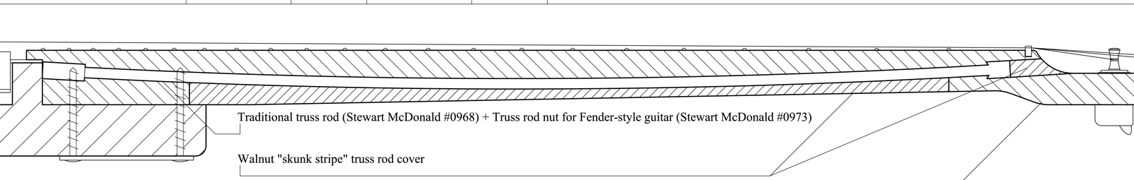

Posts: 6,517
I think in Ed Hawley's drawing, the peghead end is 3 degrees from horizontal and the heel end is 2 degrees.

Posts: 3,910
Excellent info. Thanks!

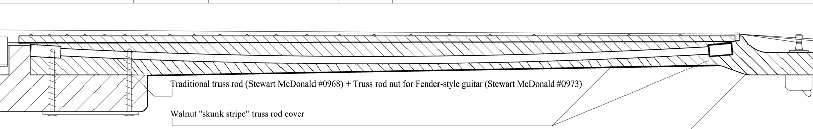

Old December 5th, 2011, 04:36 PM   #7 (permalink)
Posts: 3,910
I just found this drawing by Benjamin Stouffs. It looks like it's a symmetrical path either way...could be off the one degree that GB metioned.
I would modify the nut end and use a flat anchor between the nut and first fret. No need for a skunk stripe either.
Hmmm, looks like it's not such a mystery after all.
Mark

Posts: 3,910
Still nothing on the jig but I found this excellent thread by Ed Hawley...what a guy! The thread has a pdf of the exact TR setup I'll be using. I can probably draw my own jig plan from his drawing.
Thanks EH! Even after years of hanging out in the TDPRI, I'm still amazed at what an excellent community and resource it is.
Mark
