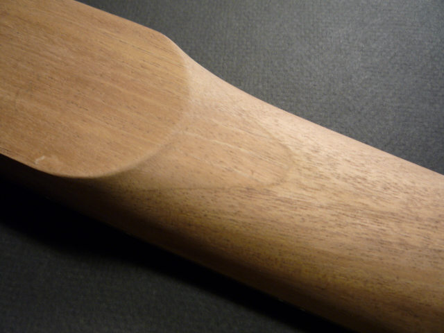

Finally finished shaping the neck. For most of the work on the
transitions on I used two large dowels, one with 80 grit taped
to it; the other with 120 grit. Then I did some final sanding
with 180 and 220 grit.
In the last pic you can see the piece that was glued to the heel.
After getting things to where they about looked right I spent a
long time reading the neck with my hand to find little irregularities
in the surface. Sometimes you can feel things you can't see.
The transition to the headstock needs a bit more work to get
it perfectly symmetrical. This neck shaping business is hard
work for perfectionists!

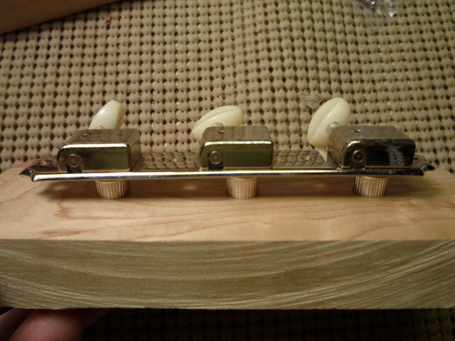

I'm using vintage, 3-on-a-strip tuners, like on my old Melody Maker.
The tuner shafts are 1/4" and the bushings are 11/32".
You can drill just the 11/32" holes, but I decided to drill both
diameters to make things, like, totally stable.
Two difficulties!
1. The tuners are on a strip, so the hole locations have to be
right on the money.
2. Drilling concentric holes -- it's really hard to cleanly drill
out a larger hole in a slightly smaller hole if you use a regular
drill bit.

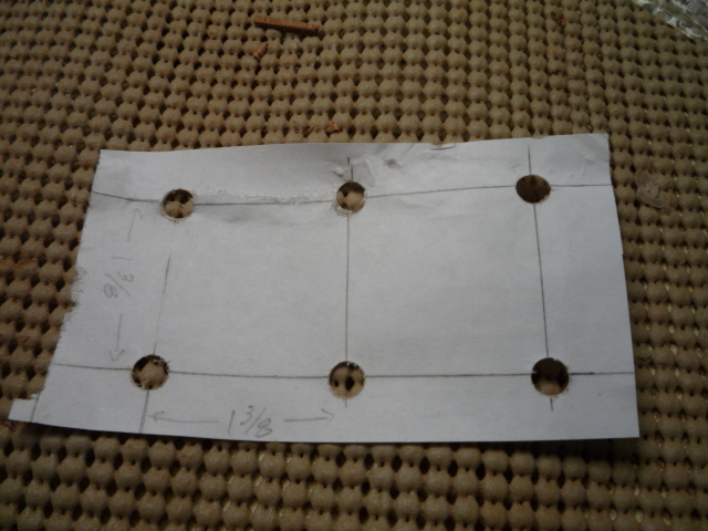

I started by drawing a little plan. (Didn't remember to take
a pic until after I'd used it...)
What's the easiest way to draw a scale plan for these kinds
of purposes? Isn't there a way to do this without fancy CAD
software?
Taped the plan onto a scrap of maple and drilled 17/64" holes.
The extra 1/64" gives some wiggle room.
I used a fence on the drill press. This helps to get the holes
perfectly aligned, and means you only have to sight and
adjust along one direction before drilling.

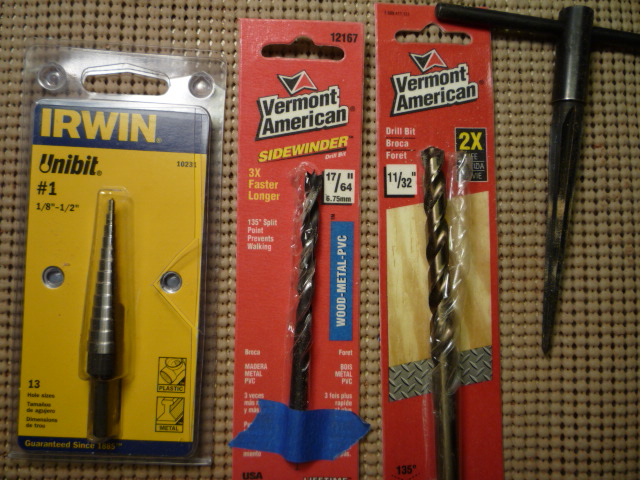

To test this drilling jig I used it to drill three holes on another
scrap of maple.
Then each of these holes were enlarged with a step bit, and then
drilled about half-way through with a 11/32" bit.
Here's the step bit along with the others:
Here's the test piece after being drilled for the bushings:
Everything fits:
I didn't push the bushings into the scrap maple for fear
of never getting them out!

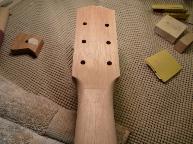

Okay, so then the maple jig was double-sided taped to the
headstock, and the process repeated. It worked out okay.
