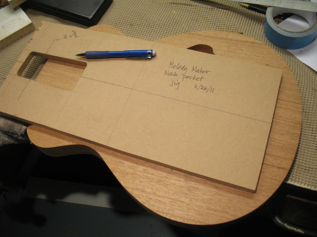

neck pocket
I figured that since this is a glue-on neck, the neck
pocket had better be a tight fit.
I started with a long piece of 1/2" MDF. I drew a straight
line along its center it and double-sided taped the neck
to the MDF, with neck's center aligned with the line on the
MDF.
Next poplar pieces with straight edges were double-sided
taped along the sides of the neck heel.
The neck was removed and the MDF routed, using the poplar
pieces as a template.
Then I cut the MDF, leaving about 12" from heel end of
the neck pocket to the end of the MDF piece. With a
long piece of MDF I can get good alignment with the body's
center line.
Anyway, then penciled the neck pocket and hogged material
out with a drill.
The first couple times I did neck pocket templates, I used a
piece of MDF routed to the shape of the guitar body. But I
think all you really need is a longish piece of MDF and a
center line.
Four pieces of Duck double-sided tape is enough to hold the
template firmly to the body.
Routed pocket (still needs a little clean up along the edges):
My big worry was that the neck might be loose in the pocket.
In reality it was a little too tight for the neck to fit. I sanded
the sides of the neck rather than the pocket, figuring it was
easier to keep the neck sides straight than the neck pocket
sides.
Once the neck fit into the pocket, I did some fine tuning to
get a good fit in the corners and at the heel.
There's a tiny bit of wiggle but it's about as good as I'd
hoped for on my first set neck. Next time I'll go a little more
slowly with the sanding along the side of the neck.
Wish I could glue the neck in right now! But I have to wait
until the neck is about finished.
