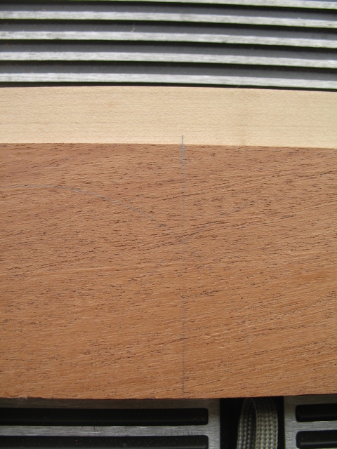

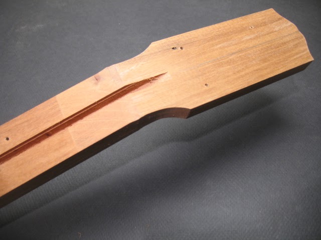

Anyway, after getting the truss rod jig sorted out
yesterday, it turned out not to be suitable.
The problem was that the neck isn't uniformly
thick, so the truss rod slot was sloped at the bottom.
I ended up using the router table with a fence.
I marked the back of the neck and the fence so I'd know the
location of the slot end.
After slotting:
Then screwed the neck template on and routed the sides.

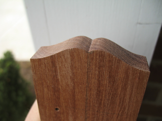

Did the same thing with the headstock template:
You can see a little rough spot at the side of the neck
where the headstock and neck routs met. I'll clean this
up after shaping the back of the neck.
With care and a sharp router bit the end grain at the top
of the headstock was smooth.
(It might look like a little tear occurred but that's just a
reflection.)

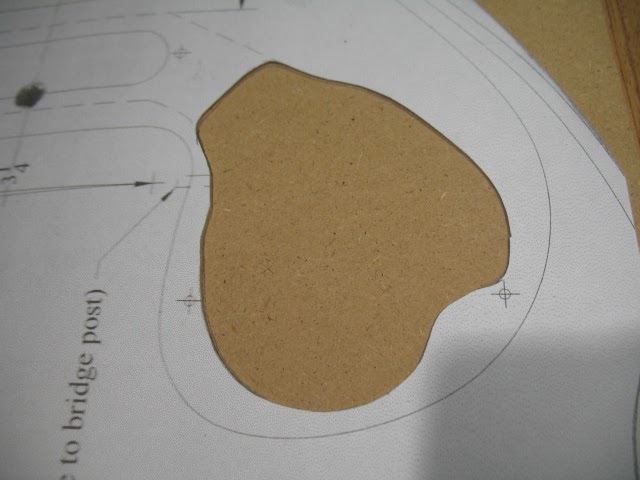

Decided to do the control cavity while thinking about the
neck stuff. First step was to cut out the cavity area of
the plan and to trace the shape on the body and on a piece
of 1/2" MDF.
I made the MDF template, then taped it to the body, aligned
with the tracing made earlier. I used Duck double-sided
tape -- that stuff holds super tight.
Routed the cavity after hogging out material with a forstner bit.
Oh - earlier I mentioned a blunder. After hogging out material
with the forstner bit, I realized that I was working with a symmetrical
body and hadn't considered which was the better side to be the
top.
I flipped the body over and saw the two holes that I'd drilled to
hold the body routing template. They were placed so that
the pickup routs would remove them.
This is crummy -- the wood is really nice. I'm determined to do
a very good job of filling those holes.

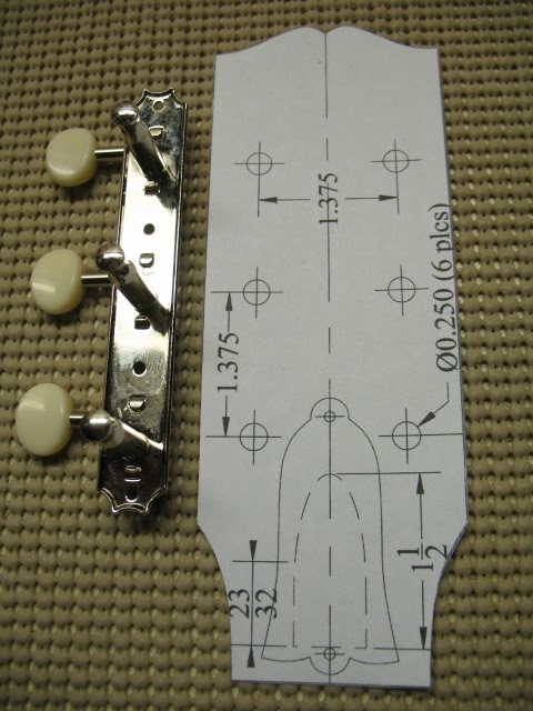

Last step today was to prepare for drilling the tuner holes. I cut
the headstock part of the plan out and was planning to tape it
to the headstock and drill.
Before doing this I got the tuners out and recalled that
the tuners on each side are on a "stick". The tuner post
diameter is 1/4" -- there is no way that I can drill 3 holes,
about an inch apart, such that the 1/4" posts will perfectly
align with the holes I drilled.
I guess I'll make a drilling guide for this step. But also, I guess
I'll want to use slightly oversized tuner post holes, either
17/64" or even 9/32".
Any thoughts on this?

I made some progress today but also made a blunder.
First I shaped the notch on the top of the headstock.
For that I used a small triangular file, a small piece of MDF
with some sandpaper glued on one surface, and other little
bits of sandpaper.
Beautiful job, Glenn. That's some precision work.
Phil

No, it's a tele forum...LOL. I just have a few pix of the necks here and there occasionally in other threads. Your triangular file and sandpaper step is exactly how I do mine as well. IT is a very nice looking moustache there.
Regarding the holes for the tuners. I clamp a fence on the drill press table for the distance from the center of the bit to the edge of the peghead. Using an accurate scale and square, layout the distance between holes and from the edge of the peghead. It should be 2 -3/4 from outer peg to outer peg, and 1 - 3/8 to the middle if I recall correctly. I use a scribe to make a dent in the spot for drilling and use a brad point bit to drill through into scrap underneath. The scrap is for breakout protection. The fence keeps the holes in line. I always make the holes 1/64 larger than the diameter of the posts,and once in a while I'll open them up one more size if they are still tight. You should have ferrules for the top side right?
Try it on scrap first.
