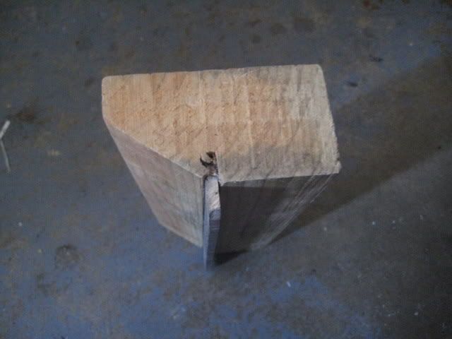

I bought a little file from Stewmac to dress fret ends, but I didn't buy the block of wood with the angled slot to hold it, 'cuz, well, I HAVE a bunch of little blocks of wood, and I'd already spent 200 bucks on files (it's amazing how small a box can hold 200 bucks worth of Stewmac files ).
I cut the slot at 45 degrees to the face of the block, but after I finished, it seemed that maybe it would bevel the frets too much, so I thought I'd ask the pros:
What's the proper angle for beveling fret ends?

I have found that 45 degrees works well on regular to vintage sized frets. In the 80's, when super tall frets came out, I changed that angle because the taller the fret, the more material is removed at 45. It was almost 1/16" on each side. I think I went to 55-60 for those necks.

Not knowing what you like, take a block of wood and cut a different angle in each face...30,35,40,45. Start at 30, then progress to 35...which is common and the angle SM uses for their files. Still not enough, go to 40 or 45. One of these will feel good to you. When you find the magic bevel, make a proper file holder at that angle.

The StewMac fret beveling file has the file set at 35 degrees. That's how I made mine. That's 35 degrees from the vertical ......... 55 degrees from the horizontal or fretboard.
I made mine from a mill bastard file I purchased at Lowes. I cut off the tang and cut it into two pieces. As I recall, Dan Erlewine discusses making the beveling file in his guitar repair book.

Well, I was wrong again. In his guitar repair book Dan Erlewine tells you how to cut a 10 in. smooth mill bastard into a 3 and a 6 in. fret leveling file. Adding the wooden handles must have been my idea after seeing the StewMac beveling files.
Old August 28th, 2011, 05:53 AM   #13 (permalink)
Jupiter's Avatar
Join Date: Jun 2010
Location: Osaka, Japan
Posts: 12,540
Made one!
Jupiter is online now   Reply With Quote

I forget who prompted me to make it this way, but if you do this you have a 90 degree edge to flush the ends, and then a bevel in one tool.

With a 90 degree don't you risk under cutting the neck because of the pitch of the frets ?

The 90 degree side is pushed against the fretboard and is used to get the fret ends flush to the fretboard.

Yep - that's exactly the way I made mine - I saw that on A Project Guitar page a few years ago:
http://www.projectguitar.com/tut/beveltool.htm
You don't need to cut the file ends off, I bought some long, cheap, Irwin files and just clamp them against a brick (or a vice will work great too) and whack the ends off with one hard blow, The metal is so brittle the ends will just break off like they were ceramic. I also make leveling files using the same kind of idea and just epoxy the squared off file to a 1"x2" piece of lumber. It's good to have really long ones (8-10") as well as some shorter ones. I generally just use the long ones - lots of light strokes and checking every 2-3 strokes... that'll get the job done.
It's one of those tools that is easy to make. What I do is I make the neck about 1/16" wider and use between 30 and 40 degrees - it's a nice feeling neck that is somewhere between a Fender and a Gibson with a 2 1/8" string spacing.
