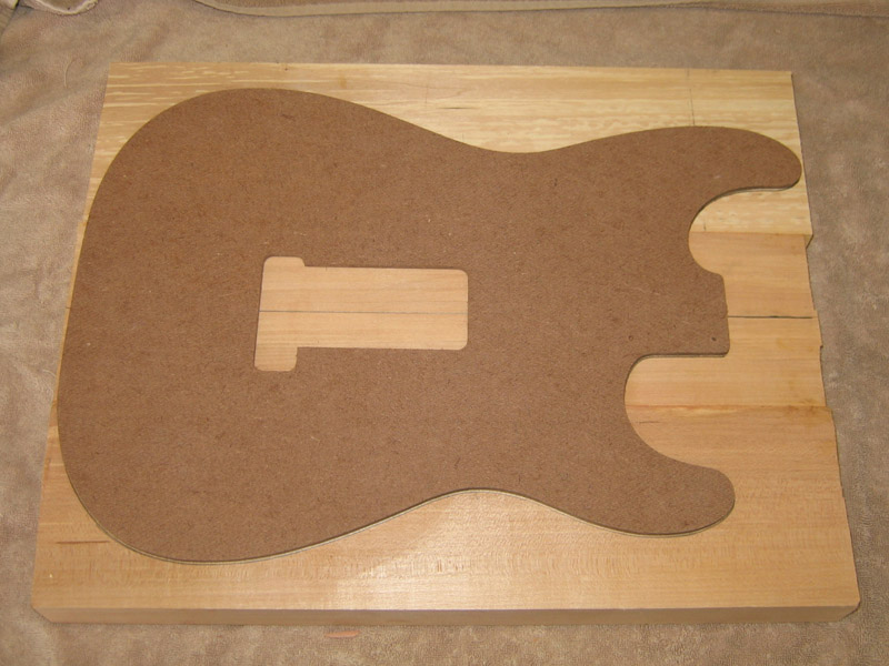

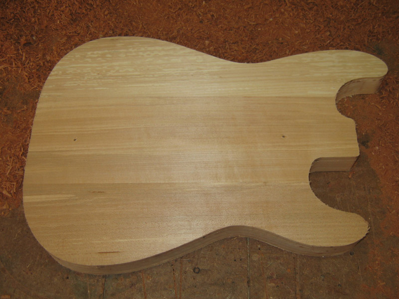

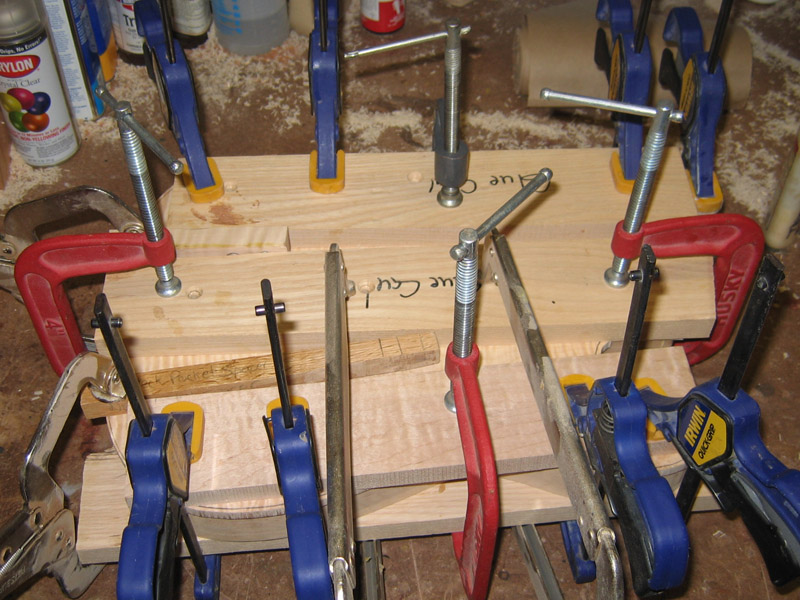

I started with a 1.75" 3-piece basswood blank. I planed it down to 1.50", cleaning up the glue joints in the process.

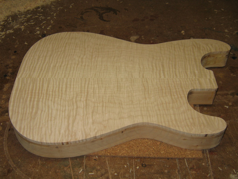

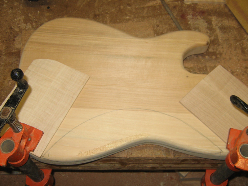

Here's the top glued up and rough trimmed. Ready for clean up in the planer. I used the same technique of taping it to the back of the body and planing the mating surface to not only clean up the glue joint, but also do final thicknessing.
Clampzilla!
Trimmed up and ready for edge sanding and routing.

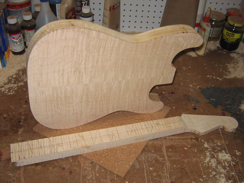

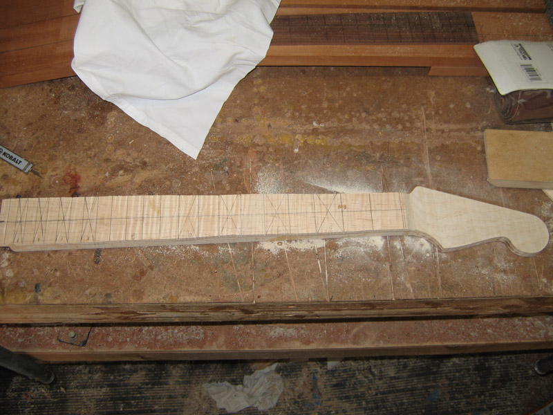

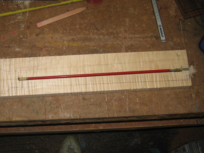

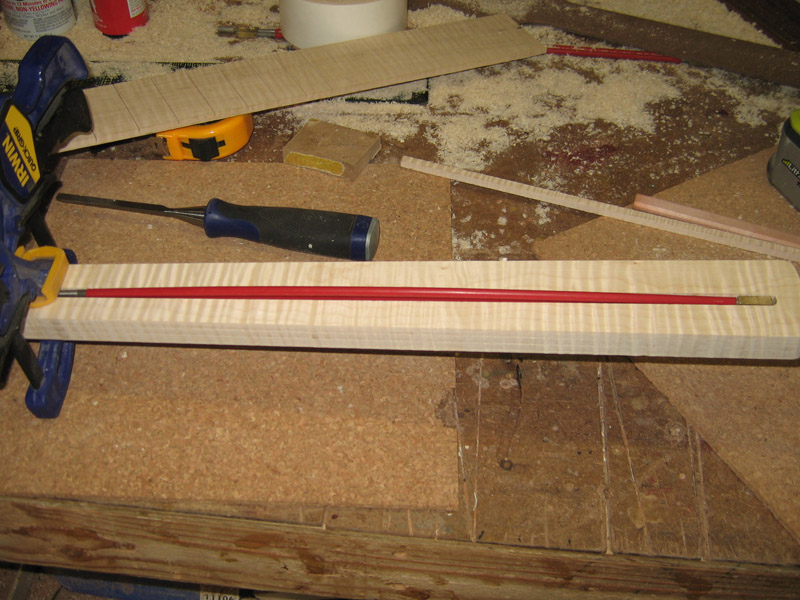

Some progress shots on the neck build. Mmmmm, flamey!
Check those truss rods!!!

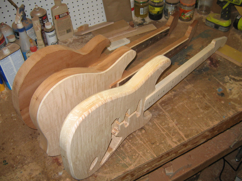

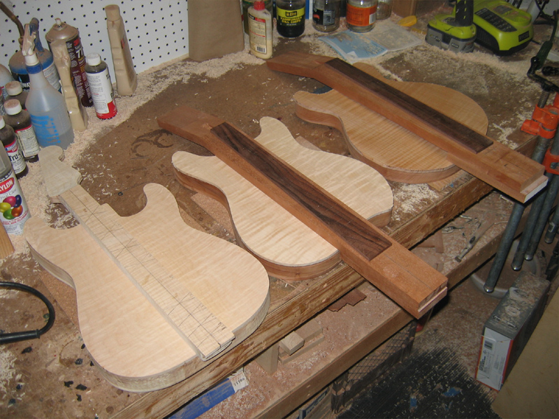

State of the builds as of Mon night.

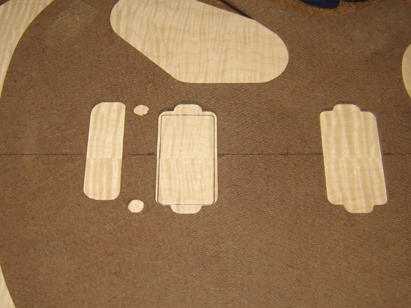

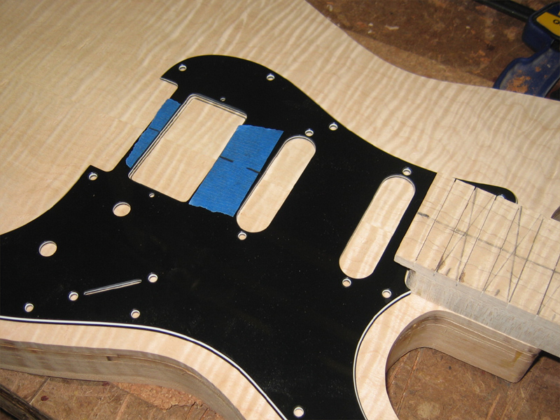

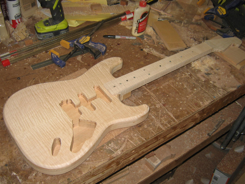

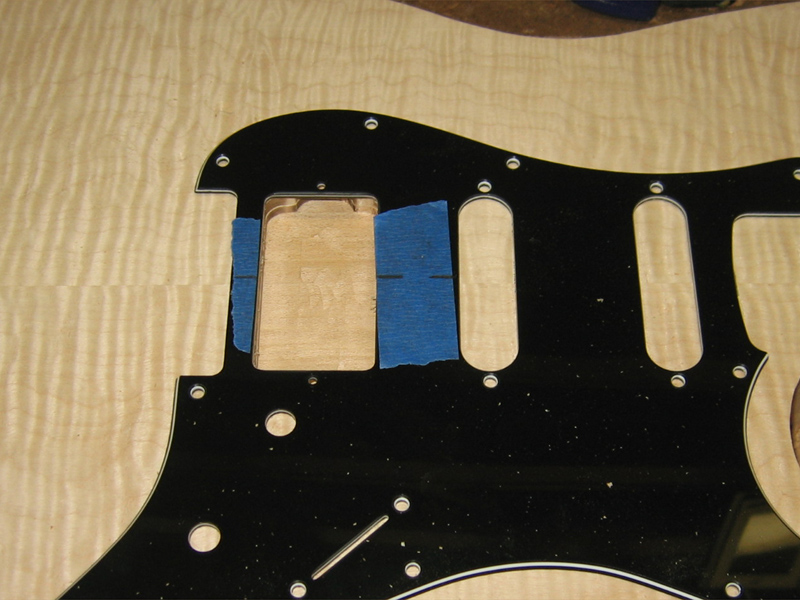

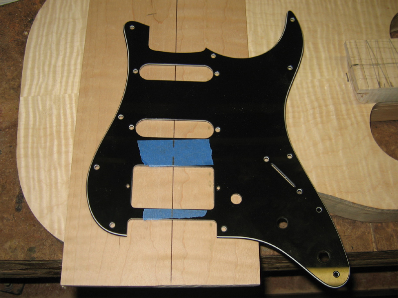

My goal last night was to get the front routed. I started off by making sure the neck fit the PG. It only took a bit of sanding to pop it right in.
Then I marked the center of the PG. I used calipers and a straight line on another piece of wood to do this. I measure the width of the HB route, halve that and slide the PG side to side until I have equal spacing either side of the line, front to back of the route. It's a quick, accurate way to find the center of an oddly shaped object.
Then, with the back of the neck pocket marked at 3:, I set everything in place. The neck and PG had to be adjusted a bit after this pic but I got it dialed in. Then I traced the HB route onto the top.
Using a HB route from another template I lined it up and centered it.
After the first pass with the router, I checked to make sure it all lined up. Good to go. Then, using the first few passes as my template, I took it to just over .75".

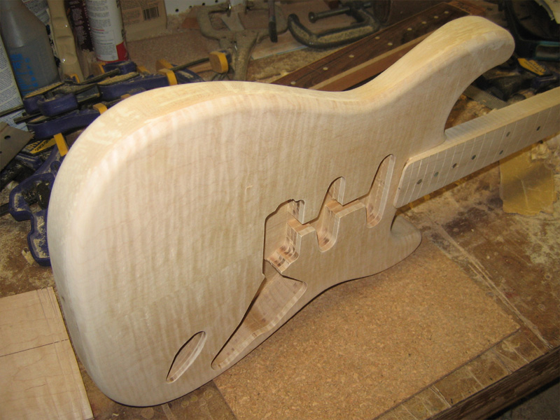

Then it was just a matter of using the regular Strat template to route everything else to depth.

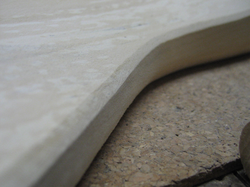

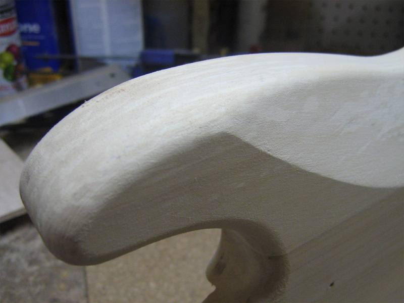

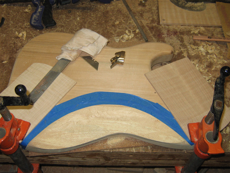

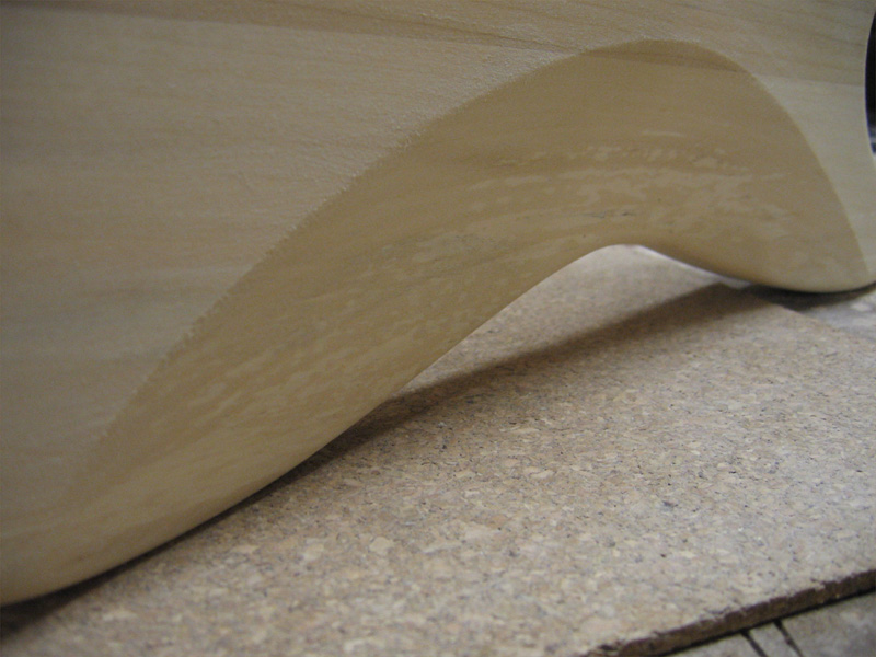

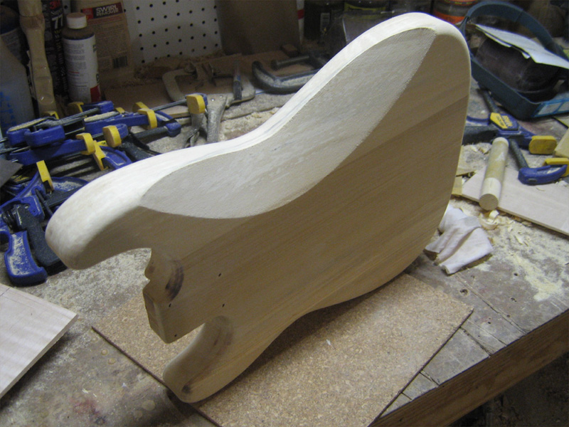

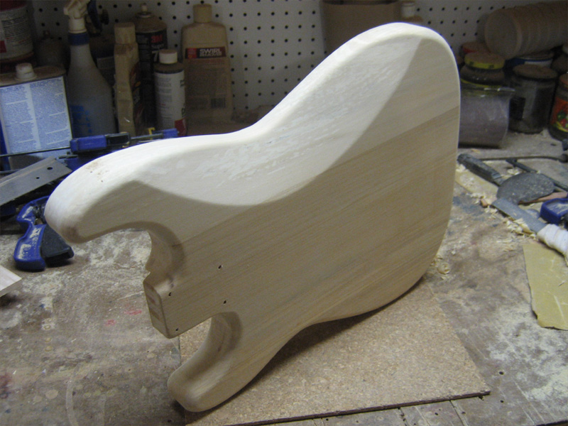

The tummy cut was next on the list for the body. I may have done it the hard way but even then, it only took an hour or so.
Not having a factory Strat to go by, I guestimated the start and stop points, then used a band saw blade to draw out the curve. I had to pull it into an oval a bit to get the curve I wanted.
You can see in the pic above that I started the process with a rasp but it seemed too slow so I went with an Ibex plane. I've used the plane enough for carving that it went really fast...carving basswood is a snap.
After hogging most of the wood out, I laid out the curve with tape so I could have a good visual reference while using the rasp to flatten out the carved area and true it up at the edges.
I finished the rough shaping with a 1" dowel and 80 grit.
I used the same dowel to cut a bevel along the top of the carve. This works for me because the corners catch light and guide me as to how much to take off and where.
Then it's just a matter of rounding out the corners left along the bevel...the dowel works great for this step too.
Old June 8th, 2011, 05:09 PM   #16 (permalink)
Posts: 3,796

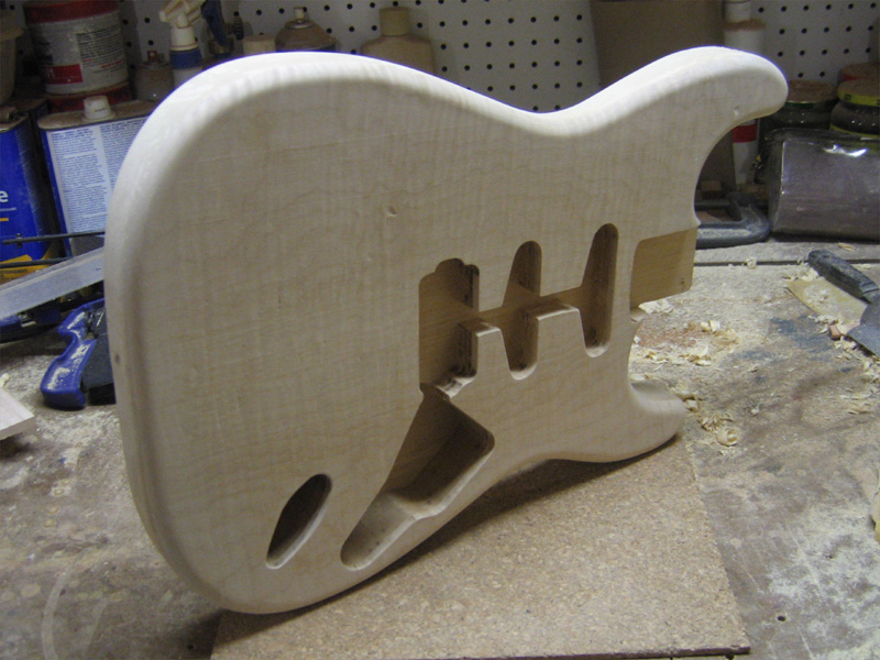

Here are some shots of the carve from various angles. I'm pretty happy with the way it came out. Not Fender issue, but neither is my tummy.

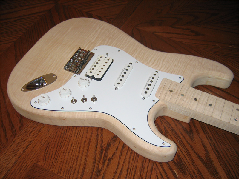

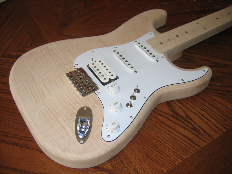

I have all the goodies in to start loading the PG. It just occurred to me that I didn't list the PUs in my first post with the rest of the specs. I was going to use an on/on/on bridge PU switch for series, coil cut, parallel but then I realized the bridge PU would always be on in some form. So, I need to look at doing a series, off, coil cut instead.
Bridge: Seymour Duncan SH-6B Dist
Middle: Seymour Duncan SSL-52 RWRP
Neck: Seymour Duncan SSL-5T Custom Tapped
This weekend I'll get the thru holes drilled, bridge mounted and the neck carved...maybe even start on the bleaching of the top. I'll do some tests on scrap first.

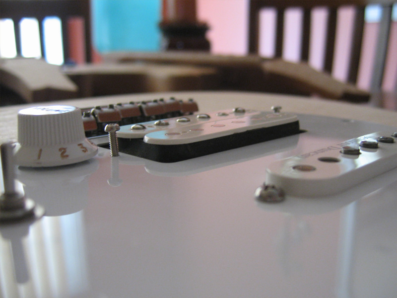

I need to shorten the HB screws a bit.
Old June 10th, 2011, 01:23 PM   #20 (permalink)
Posts: 3,796
I've had the SD PUs sitting around for a year or so and didn't remember the specs on them so I put a meter on them and got the following DC readings.
Bridge:16.3K 8.8K
Middle: 6.6K
Neck: 12.8K, 6.8K
Now, I now DC resistance doesn't tell me what the PU will sound like but it's a good indicator of output. So, I'm rethinking the wiring yet again.
To get the most out of this set of PUs, I'm going to use this setup...at least if I have it diagrammed correctly, I will.
It should give me:
Bridge: HB, Off, Coil Cut
Middle: RWRP, Off, Phase Reverse
Neck: Full, Off, Tap
