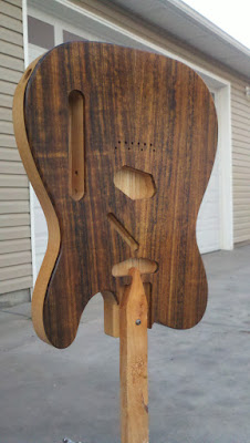

Originally Posted by Guitartom_ca View Post
will veneer look ok without binding?
I did a 1/4 cap of Shedua with no binding on my latest and really liked how it turned out. I was convinced a binding would be the only way to go, but after seeing it this is what I decided on.
Wow .. Looks really good.. thats what i planned to do with the birdseye maple and pine.
