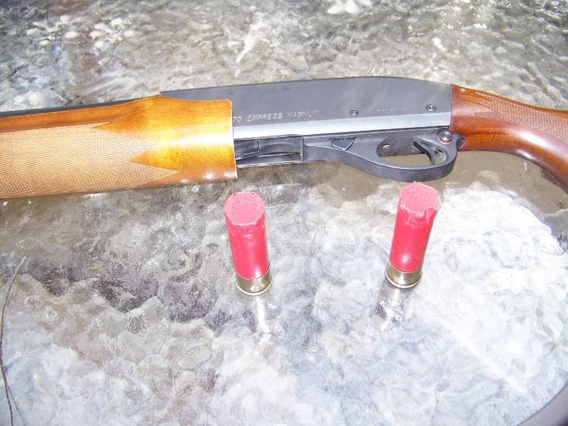

Alright, I promised another member to post a shotgun shell knob thread.
This is how I go about making custom knobs from things like shotgun shells. However, you could adapt this technique to any kind of custom knob you want. The reason I do it this way is because I make knobs that easily go on and off the pots.

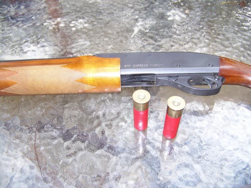

I looked through my ammunition drawer and dug out these two old turkey load twelve gauge shells.
These are not shells you want to go through by the box at the range, they pack quite a wallop!

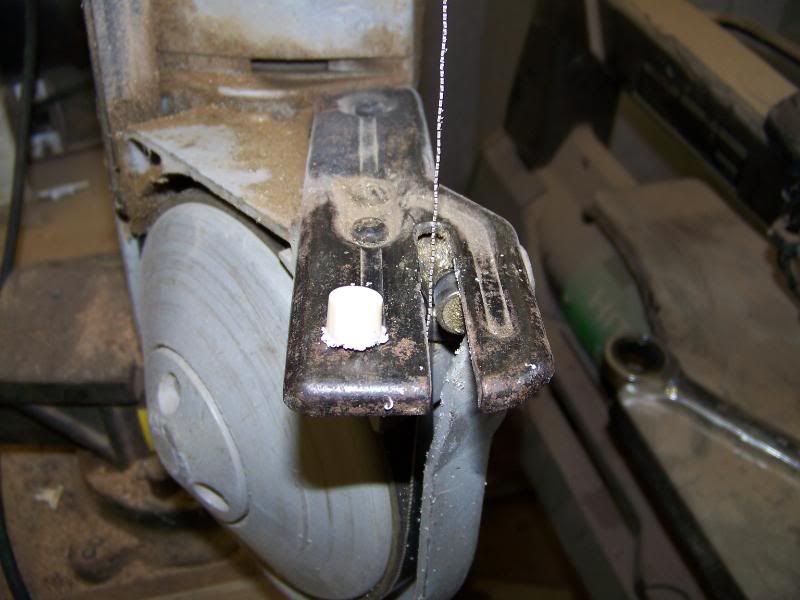

I like to use my metal cutting bandsaw for small pieces like this for two reasons, 1) it has finer teeth, so it both cuts cleaners and won't rip things from your hand and 2) It cuts slower, so I can more accurately cut the brass from the plastic hulls.

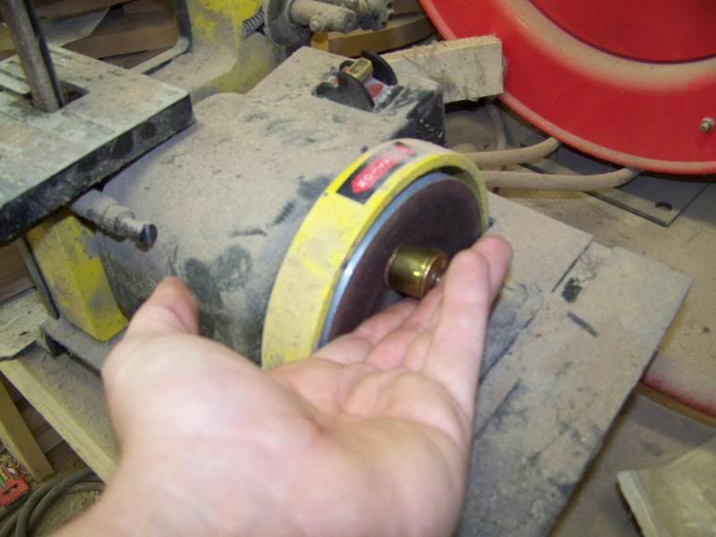

I make sure the shells are flush by flattening the bottom on my small disc/belt sander.
These small disc sanders are outstanding for this detail work, because a large 12" disc sander will rip stuff from your hands, which will cause you to run your fingernail into the sand paper, and it will take it down to the quick in NO TIME!
In case you are wondering, I did this before I cleaned the shells. I just got ahead of myself posting.
Then using a 2 part putty epoxy, I fill the voids in the shells. I fill them proud, and avoid mushrooming the epoxy over the edges.
I fill the putty in there proud, so I can sand it down flush. That way all the voids will be filled, and the kneeding lines wont show making it look like gray matter on a cracked skull.

After giving that ample time to dry, I once again use my small belt/disc sander to sand the epoxy flush and pretty.
