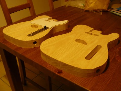

So, its been a few weeks! We went ot the UK for a holiday and that brought the guitar building to a halt. Whilst there though I managed to get my body blanks thinned down to the correct 1 3/4 inch which was good. Unfortunately I asked for them to thin my necks too which they did perfectly, perfectly banana shape! so tomorrow I hope to see what I can rescue from them. I have stuck here the picks of the almost finished necks, unfortunately I have no pics of the production as all our cameras are in the UK. So I have pinched the work camera just to take a few pics.
Neck pocket and the sides need a bit of sanding
Here you can see the hole from the neck pocket to the bridge pocket
The 2 together. I think I will stick with the tortoise shell pick guard though
And a last image,
After all the templates the actual bodies were rather quick to make. I managed to jigsaw and route the profile then route and drill the cavities and finally drill the jack hole in under 2 hours per guitar.
Tomorrow we are on to necks!

And the bodies are done. I have lost the pics of the radiusing and finishing but if they appear I will add them. Once the edge profiling was done I used a carroll drum sander in a pillar drill and a router for the edges. I went for a 1/4" rad as I liked it.
The pickups are tonerider vintage in one body with a 3 way switch and tonerider hot classics with a 4 way switch in the other body.
I finished both with a tung oil finish left over from another project I did when in france. No grain filler for that full grain effect.
