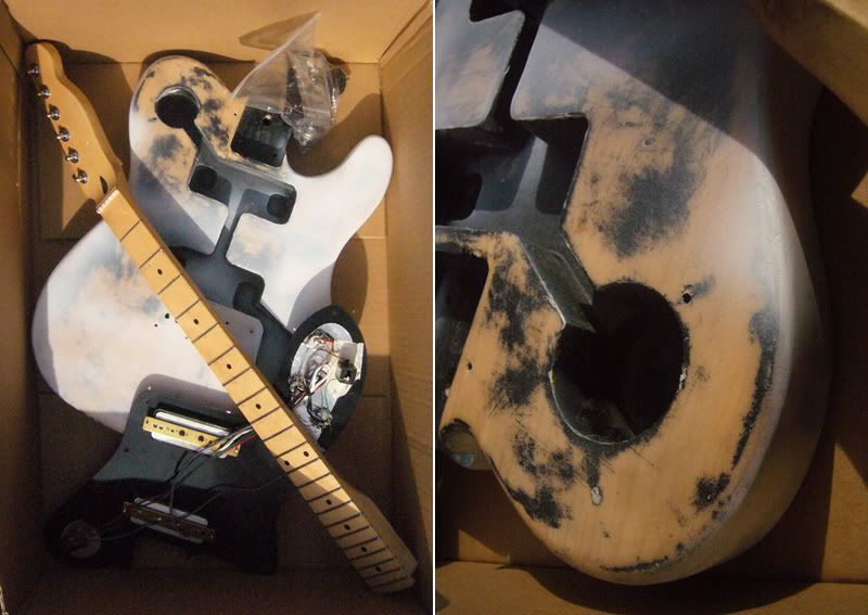

^ This is what I've 'won' on a Dutch auctionsite: A Squier Vintage Modified Telecaster Custom II, in parts...
I had been looking for this Squier, a cheap P90-equiped guitar, for a long time and was about to order a new one online. So I kinda felt lucky when I found this project online. This is my first 'build', and I'd rather cut into an abandoned project than into a fresh new guitar... This used to be a good player with good sounding pick-ups.

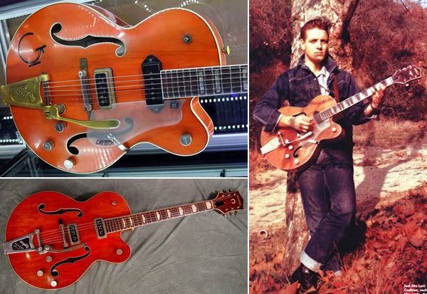

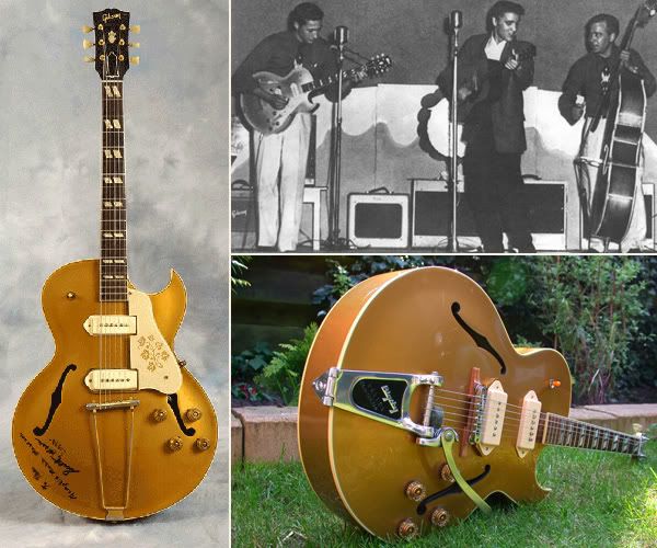

For inspiration I have looked at pics of some of my rock'n'roll pioneering heroes and their guitars:
^ Scotty Moore's Gibson
^ Cliff Callup's Gretsch
^ James Burton's Fender
^Carl Perkins' Gibson
^ Eddie Cochran's Gretsch
^ Johnny Meeks' and Paul Burlison's Fenders
I could go on and on and on, but you get my idea...
^ Some more inspirational shots of Gretsches. I really like that cute Rambler (top right) and at the moment I plan to use the colorscheme of the Bambooyellow-Copperdust (bottom right)

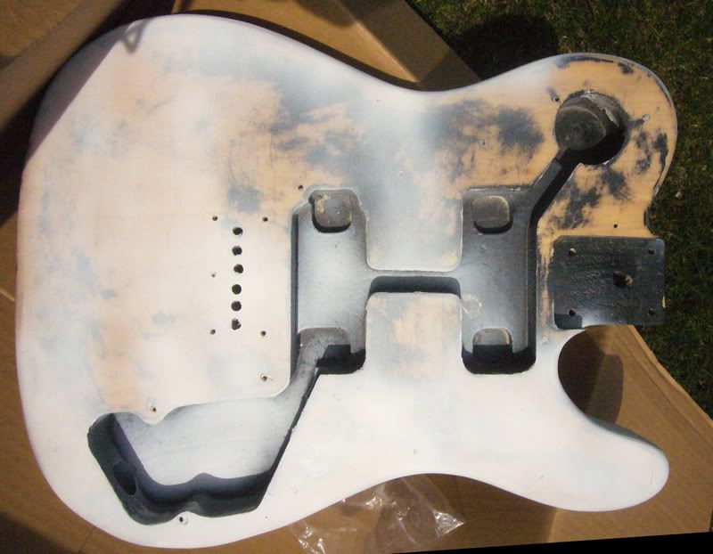

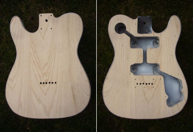

^ I thought the body used to be black, but it was the blond version to begin with... But it has been black, transparent blond, and finaly dusted primer grey...
^ Thick layers...
^ But nothing a beltsander can't handle...

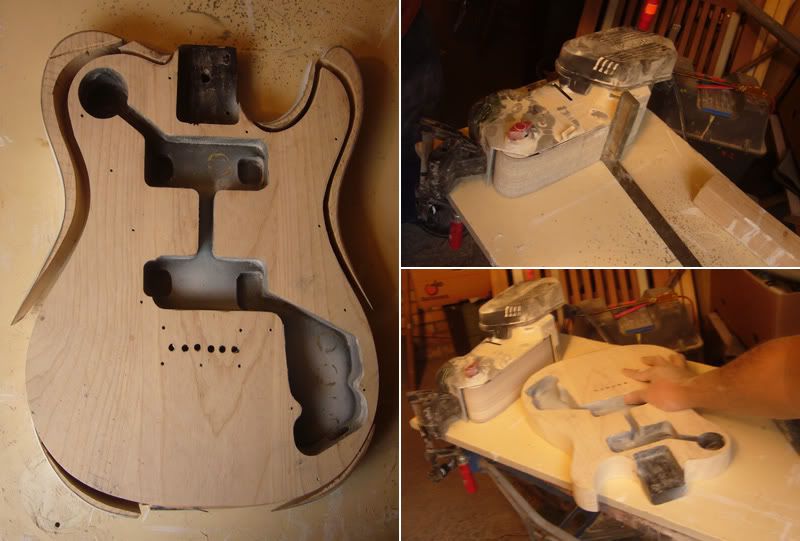

^ Time to transfer my design to the wood. Flipping the paper to the lower bout to create some symmetry.
^ So here it is. Ready to be cut...
^ No turning back now... (or should I say mega-heavy rellic ;-)
^ Roughly cut out my design with a handheld jigsaw...
As you can see, I don't have much of the 'essential' tools so I layed the beltsander on it's side and with a few tweaks made it sand square... It works great on the outside curves. If I won't come up with an idea to square the innercurves I'll just have to sand it by hand...
^ I still have some hours to sand and refine the bodycontours but it's getting there. Made some mistakes so it's not exactly like my innitial design. Still, very close...

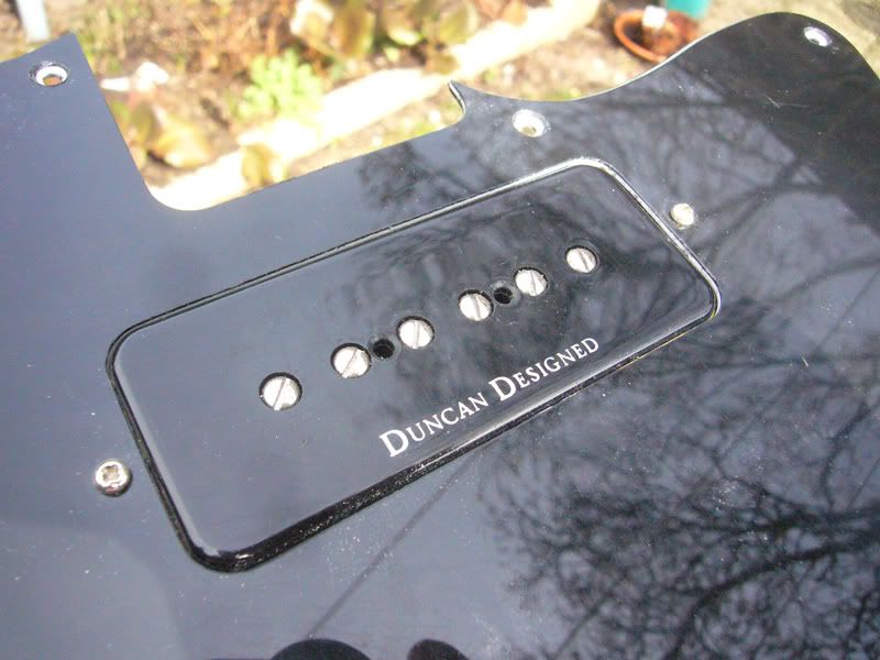

- I'm on a very tight budget, so no (expensive) Filtertrons here.... Funny you should say that, btw: Filtertrons were introduced around 1958, which made em post-rockabilly, right? I can't come up with any rockabilly-pioneer with a Filtertron-equiped Gretsch (except for Chet Atkins). Yet a Filtertronned Gretsch seems to be THE most popular guitar for Rockabilly nowadays. I guess we have to thank Brian Setzer for that. (I think his sound is amazing if not perfect btw...) Also, using Filtertrons will make it too much Gretsch, and thus a 'fake' Gretsch. Just as much as painting it orange will. For the same reason I can't paint it gold because it would be too much Gibson. And it would have been too much Fender if I had kept the Tele-lines.
I really want a good ballance in the looks of the guitar so I plan on just using the pups that came with the guitar:
^ 2 P90's. Duncan designed (If that's worth anything...) I've seen and read great reviews of these pups in this guitar so I'll stick to them. I'll be trying cream covers though for that little bit of extra vintage vibe. And MAYBE in the far future I'll replace the bridge P90 for a DeArmond as a tribute to Eddie Cochran's modified Gretsch...

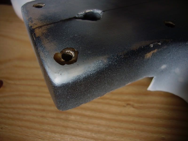

^ I just discovered a problem... The allignment of the neck is way off. (not only from my shaving and scraping! ;-) But the pick-ups and bridge were mounted slightly off-centre too, making it hardly noticable and perfect for playing. I think I'll have to redo it and plug the screwholes in the neck and drill 3 new ones...
^ Line Nr.1 is the centreline from the neck/pups/bridge. Line Nr.2 is the official body-centreline... Also notice the 'less precise' positioning of the string-through-body holes... The low E was spot-on, but going to the treble E the spacing increased compared to the spacing of the holes in the bridge...
Ah well...
I plan to plug the holes and install a Bigsby anyway.
