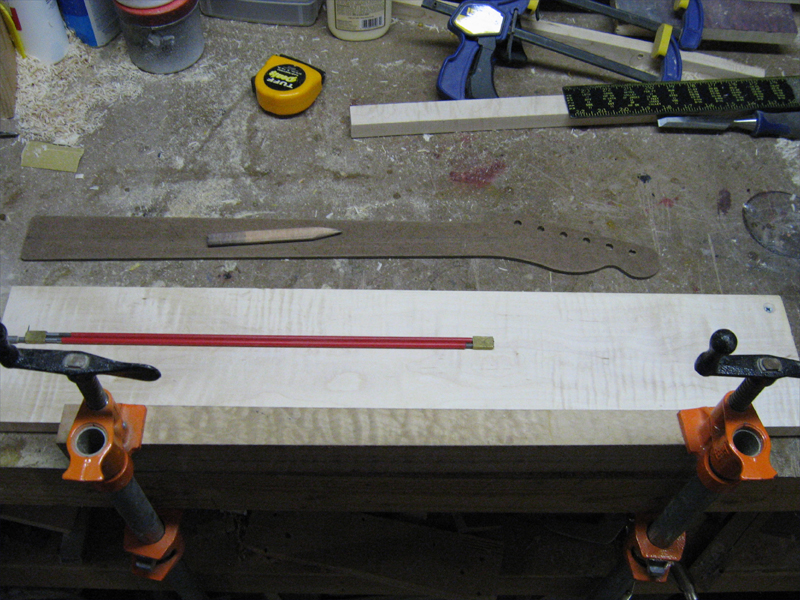

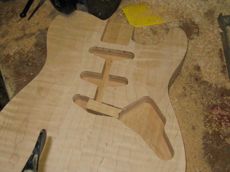

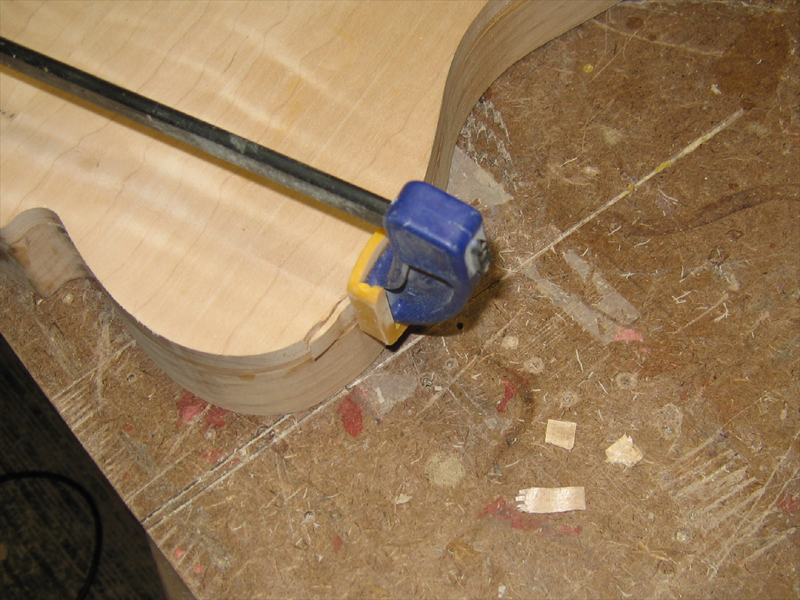

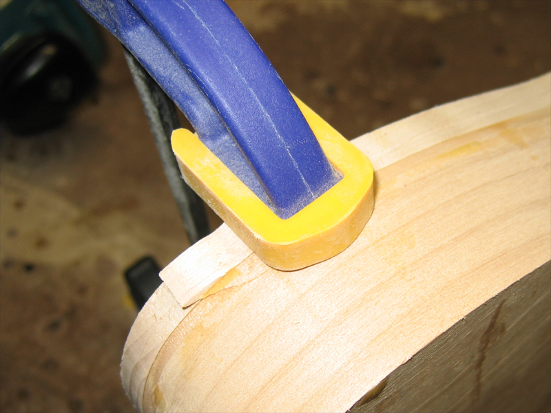

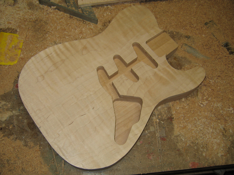

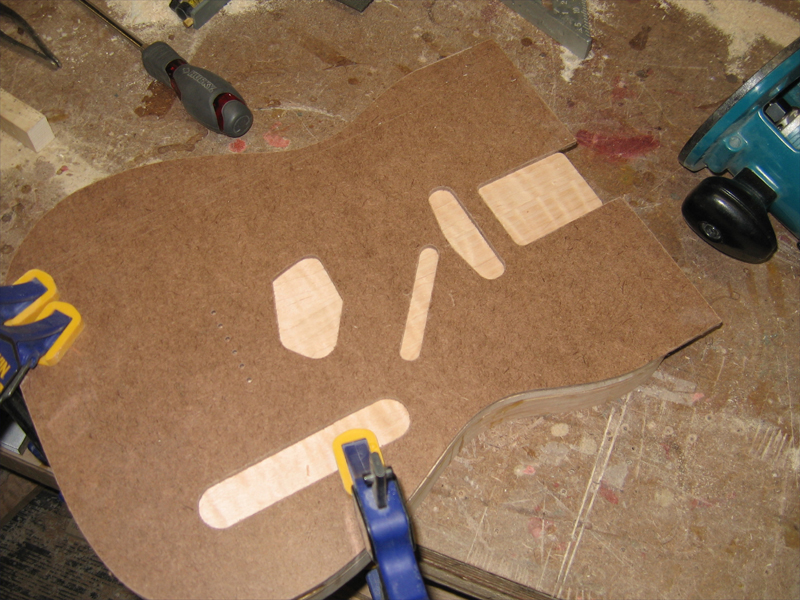

This morning I trimmed out the top and even being ever so careful not to run into end grain, the bit snapped off a chunk of maple and alder. I quickly grabbed up eveything on the bench that wasn't a shaving. I glued the largest piece back in place.

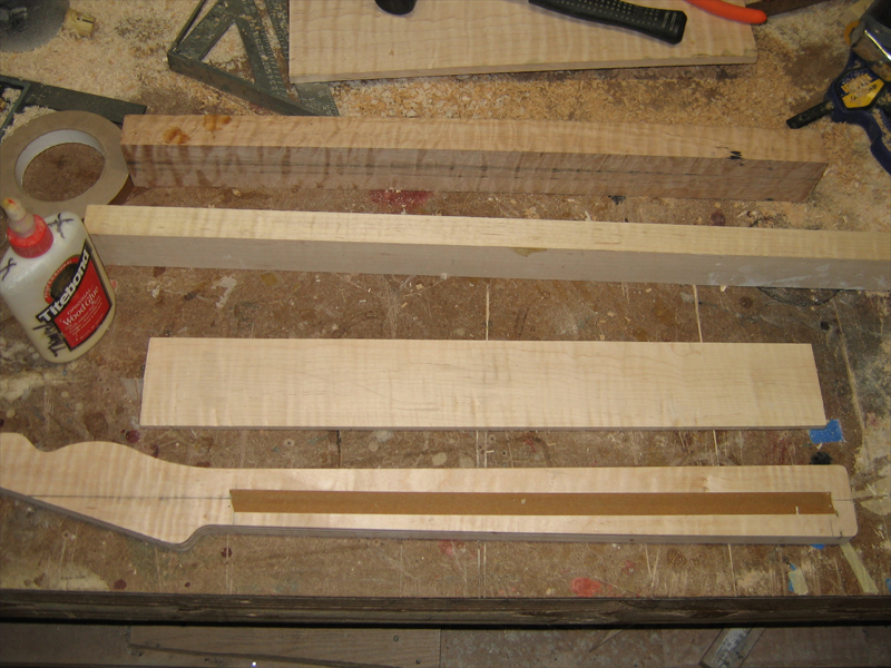

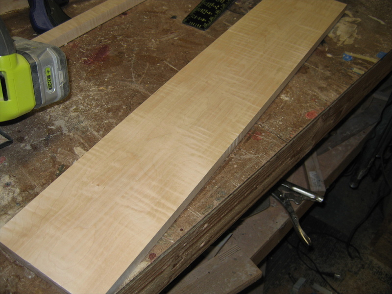

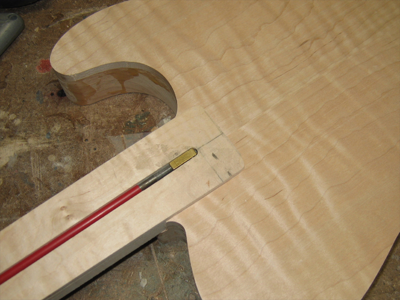

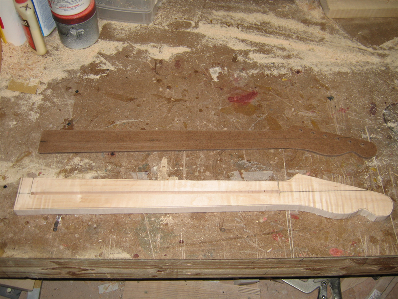

I set that aside to cure and started work on the neck. I had a piece of maple that has some nice flame but not too flamey.

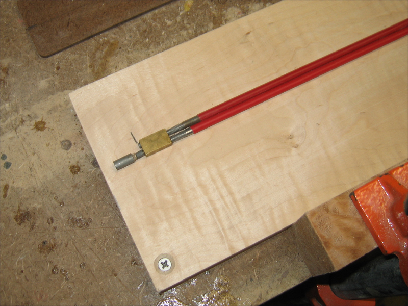

I laid out for the truss rod...

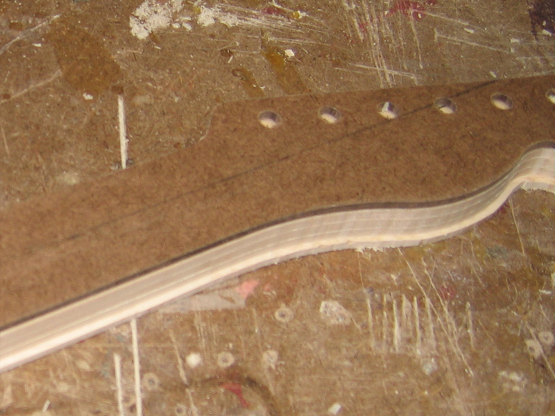

I rough cut the neck on the bandsaw...
...and routed the profile with a pattern bit. After doing 2/3 of the thickness, I flipped it and used a flush trim bit to finish up.

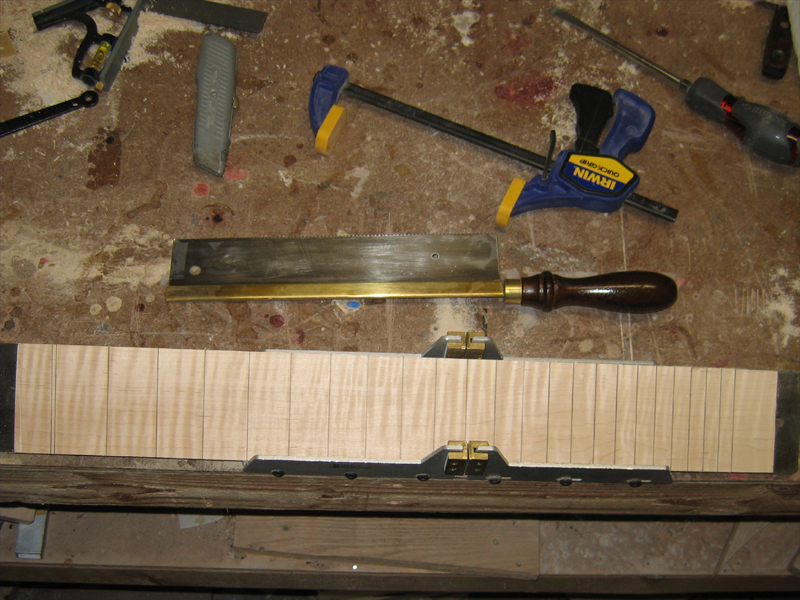

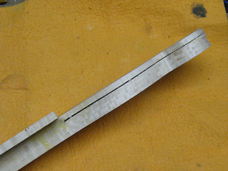

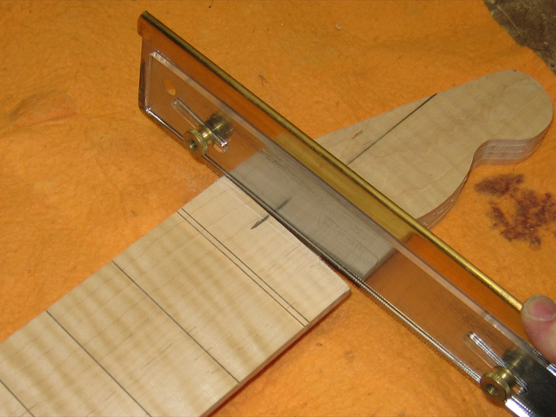

I had a nice fretboard blank that I found in a stack from another build. Used the StewMac miter box and fret saw to slot it. I'm really just marking them at this point. Since I started using the depth guage on the saw to recut the slots after radiusing the fretboard, I don't worry about final depth at this point.

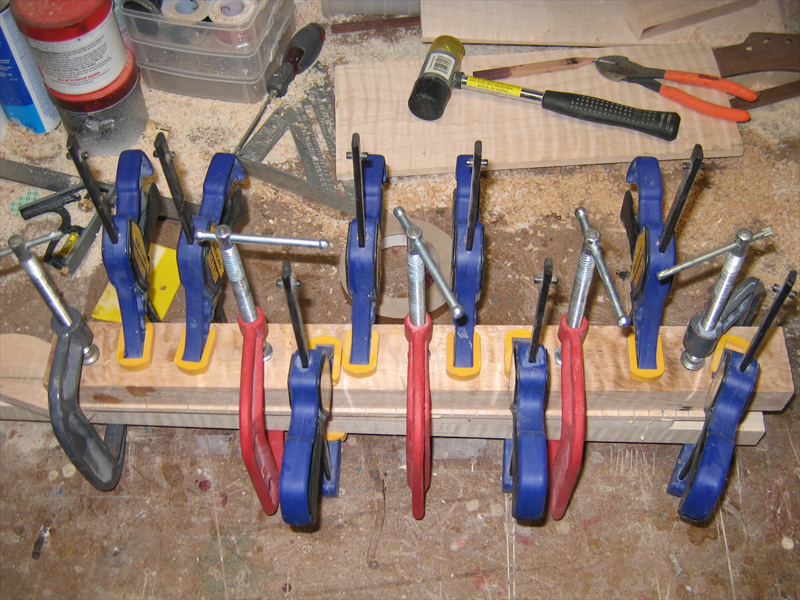

Truss rod installed, pins in place. All ready to glue up. I'll apply glue, then remove the tape that's covering the trusrod channel.
Clampzilla!!!

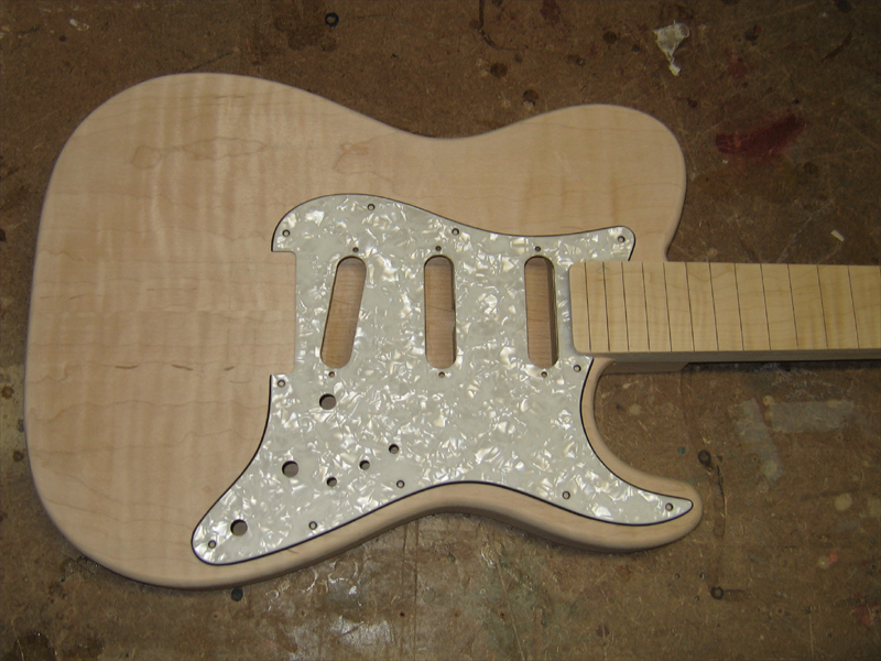

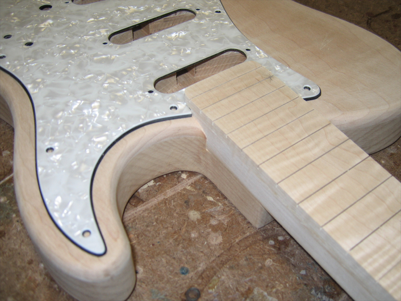

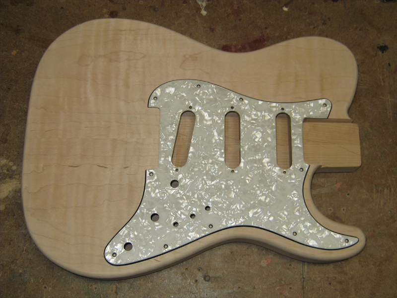

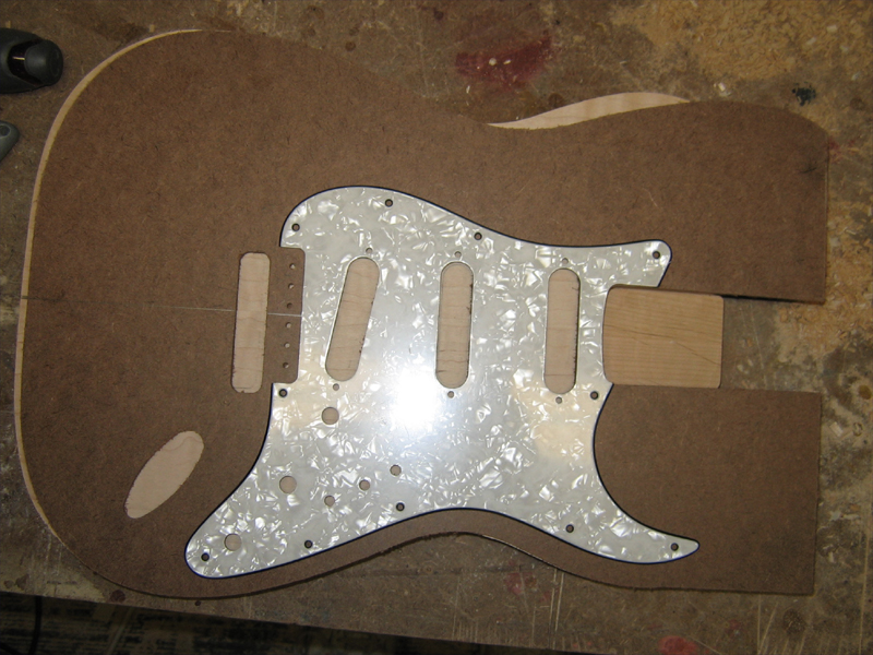

Some of these are out of sequence but I think I covered all the steps. I set up to route the neck pocket. This was easy since 3/4 of the body is Tele. I just lined it up as usual.
Nice fit. It needs a bit of shaping along the heel to get it to sit in all the way.
Next, using my results from my earlier post about neck/heel shape, I lined up the Strat template to route control and PU cavities.
I took everything to .75" then added a stop to guide the bit as I took the control cavity down to 1.5".
All finished...

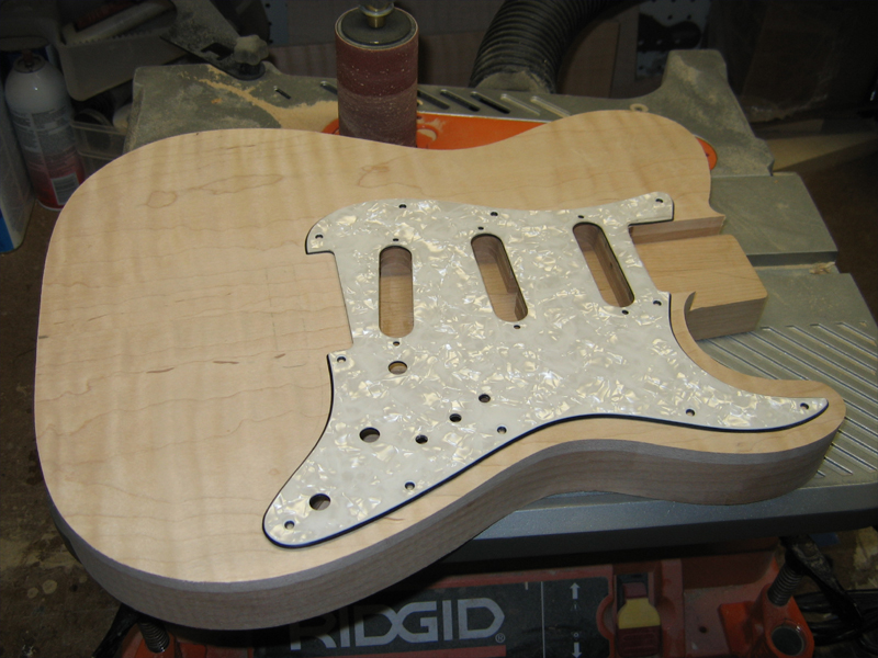

A quick pass on the spindle sander to clean up the edges.
Then I added the radius. I used a .5" bit but took a shallow pass so the round over is somewhere between Tele and Strat. Just right.
Back to the neck. I set up my resaw fence and used the edge of the fretboard to give me a parallel path down the headstock.

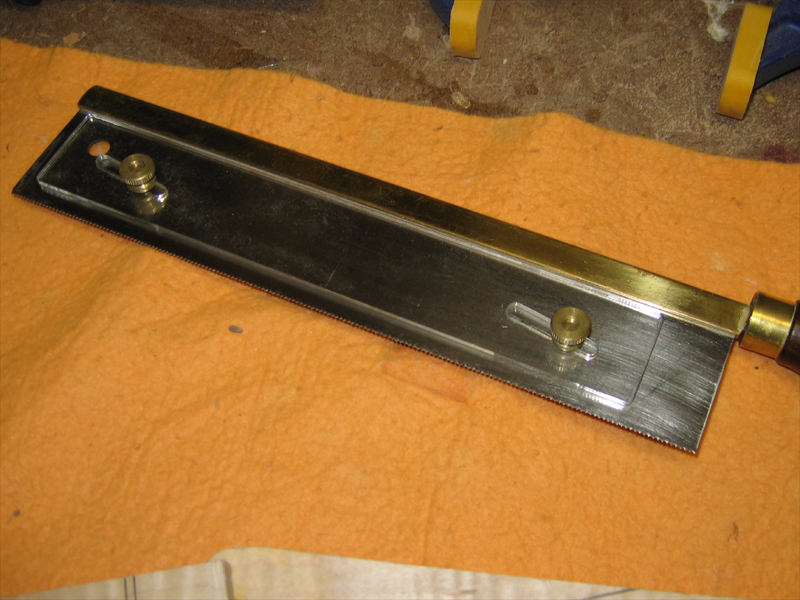

Here's a tip you might not know. If you turn the StewMac depth guage over, it cuts deeper.
I set it to just past the top of the bandsaw kerf so I could saw away without having to worry about going too deep.

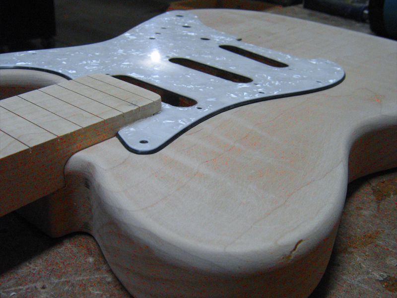

With the fretboard trimmed to the neck and the fretboard extention shaped, it's all coming together.
The radius opened up a void from the tearout repair...easy fix.

Thinking ahead to the finish, I'm really diggin' the antique white.
I wouldn't want to paint over the flame maple so I came up with this. Not a firm decision but an interesting approach to white, burst and figured wood.
I would start by bleaching the top white, then apply a light black dye, sand back, spray a trans white coat and then burst it with antique white...the back being alder would be antique white as well.
