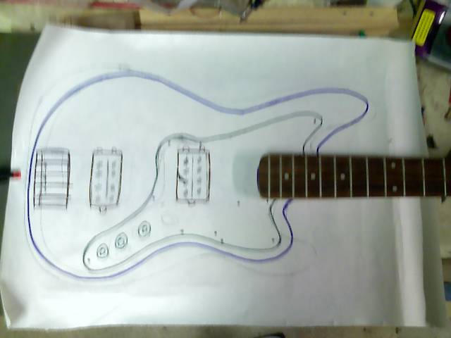

The first thing I need is a pattern of some sort to work from. So I started with a big sheet of paper and traced the outline of a P-Bass body I have in the garage. Took that paper to work and taped it to the wall in the conference room. Fired up the projector and called up the image that I have of the WalMart T-Shirt. Projected it over the P-bass outline and sized the pic so the scale was the same. Then proceeded to trace the projected image onto the paper.
That gives me something to work with and its in approximate scale.
Took out my sharpies and started to draw up what my minds eye saw and the new bass.
Well here is what I ended up with.
Sorry about the lousy cell phone pic that was taken quick and dirty to show my buddy what I was thinking. I laid the neck on it to give a better idea of what was coming.
I had the neck just hanging around for some project like this, got lucky there. So I don't have to build a neck this time Yay!!!!!

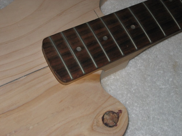

Let's get the neck on there.

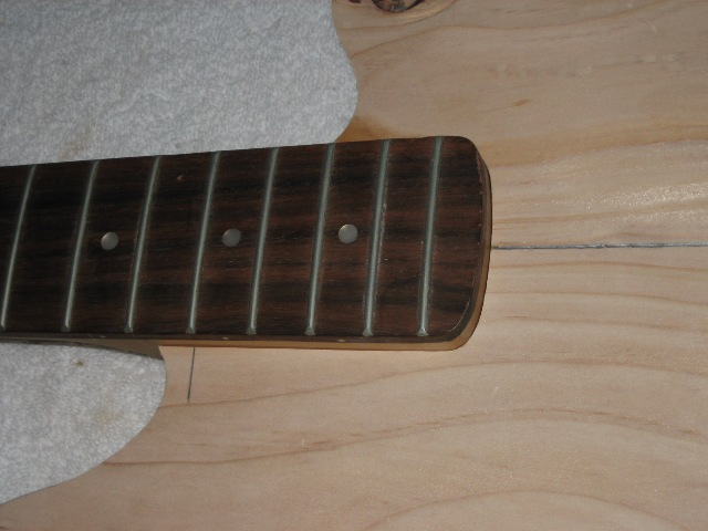

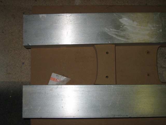

So again I'll try and retro blog the creation of this thing.

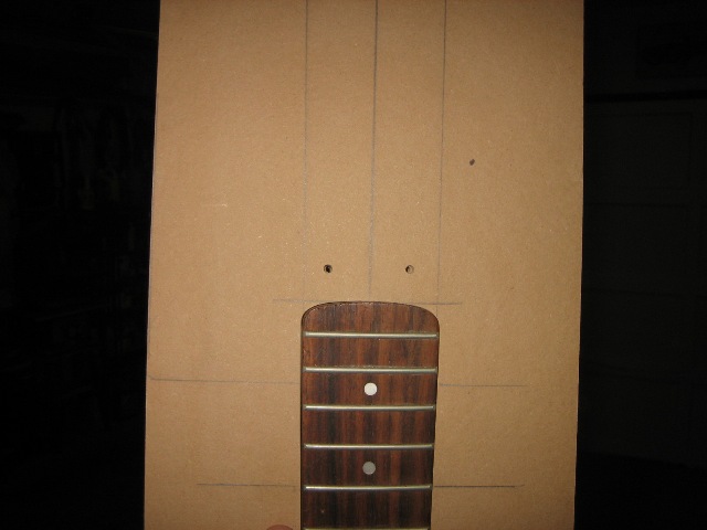

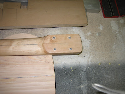

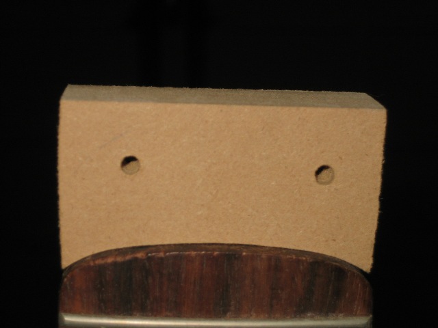

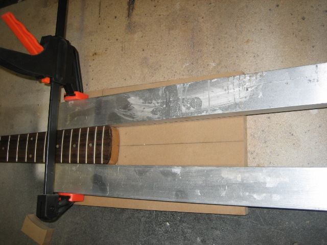

So I started by penciling the center line on the back of the neck.
Clamped a couple straight things to the neck, lined up the center line of the neck with the center line on the MDF. Double checked the straight edges at the back to make sure they are equidistant of center. Marked the straight edges so I could realign them when they moved, cause I know they will.

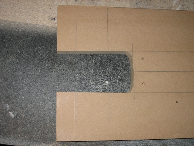

traced the heel of the neck onto another piece of MDF and cut it out. Sanded it until it matched the contour.
fit the heel piece in between the straight edges. I actually screwed that piece down, you can see the other end where it was screwed down.
Clamped all the pieces down and routed out the hole.
Test fit the neck into the template. And tweaked it with sand paper till it fit just right.
Oooo yeah.
Lined it up on on the body stuck it down with double stick tape and routed the pocket, took about three passes to get the standard 5/8ths depth.

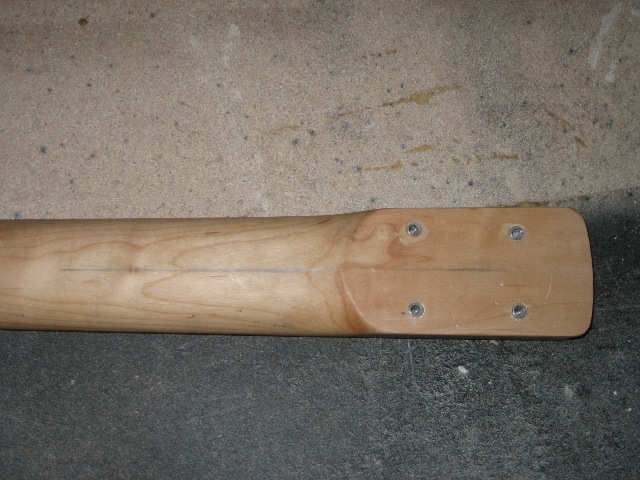

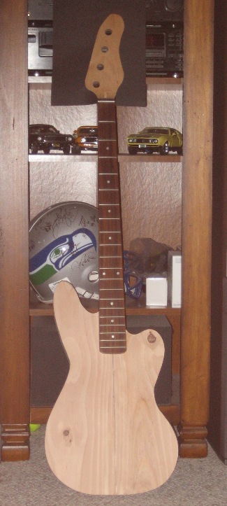

Now to get the neck screwed up, I mean on.
I wanted to get the neck screwed on so I could start mocking up the other routes.

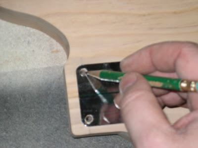

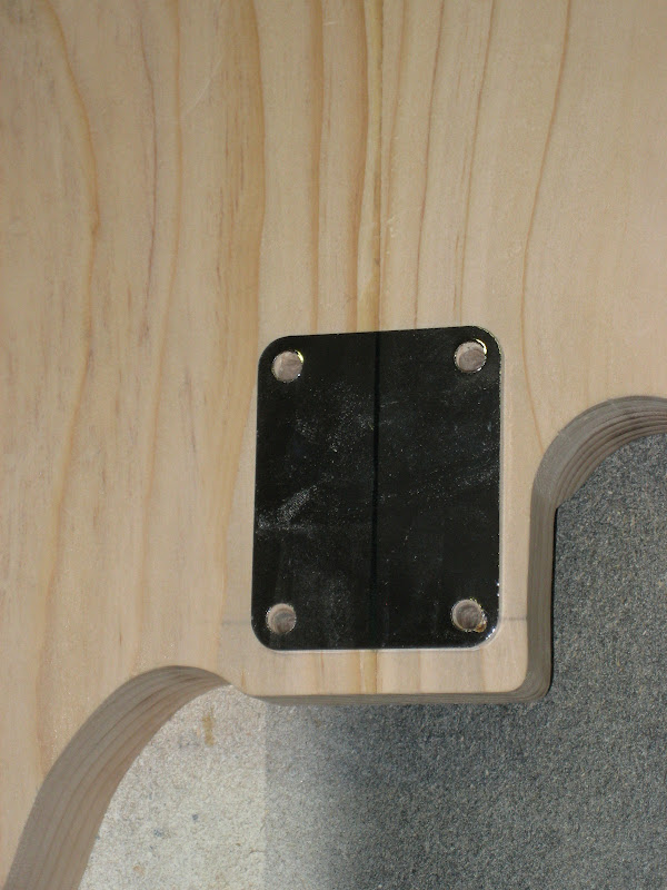

I drew a center line on the back of the neck plate I'm using. Lined it up on the back of the body.
Marked the holes
Drilled the holes and I got this
I decided to plug and re-drill the holes in the neck since they didn't line up with anything. Once I was done with the 1/4" holes for the threaded inserts the plugs were drilled away anyway. Put in the inserts and I have this.
Mounted the neck and here is what is coming together.
You can see by the paper on the headstock the shape I am experimenting with.
Now we're officially caught up with with were I'm at with this project. So from here on I'll be hopefully documenting with better pics in real time.

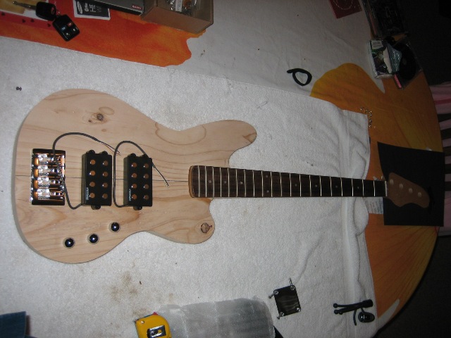

Teaser
The first of many mock-ups.
Here is a little preview of the plan of things to come.

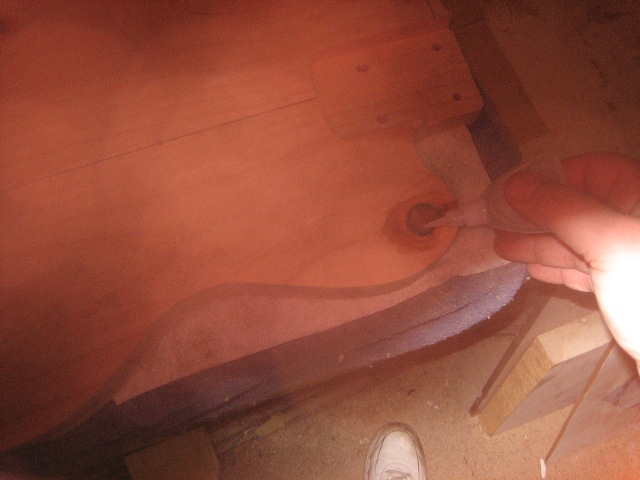

Got a bunch of work done on the bass this weekend.

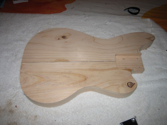

I wanted to stabilize the knots so they wouldn't cause any trouble later so I gave them a good soaking with a little CA
Sorry, crappy picture.
At least I know they are not going anywhere I'll have to fill them later, I'm going to try the Z-poxy but I'm getting ahead of myself.

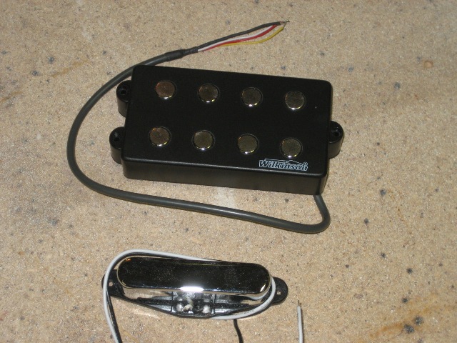

So next is to put some big holes in the body to mount a pair of monster pickups.
I'm used to guitar stuff so the big ol' bass humbuckers seem mamoth.
Here's one in comparison to a tele PUP.
It doesn't even do it justice. These suckers are huge.

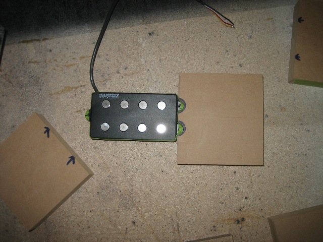

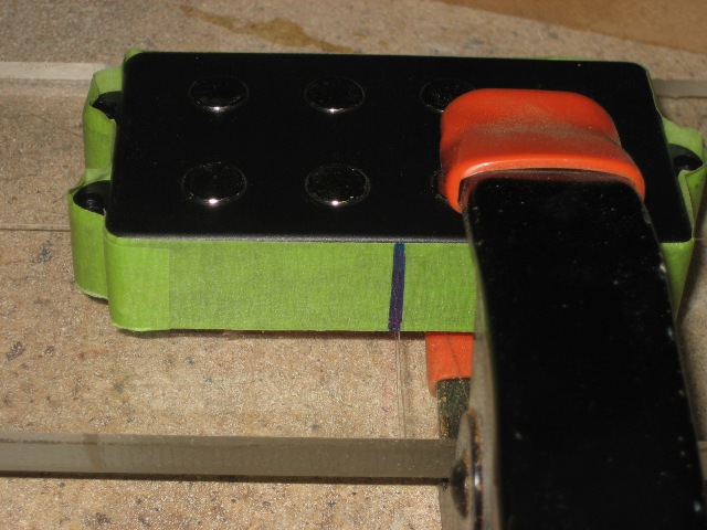

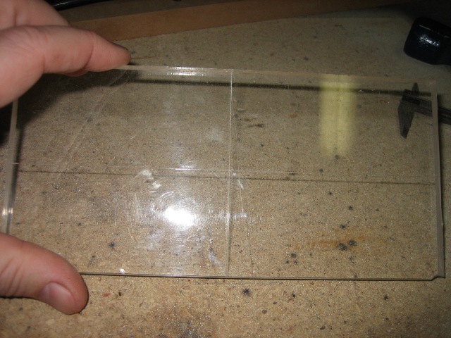

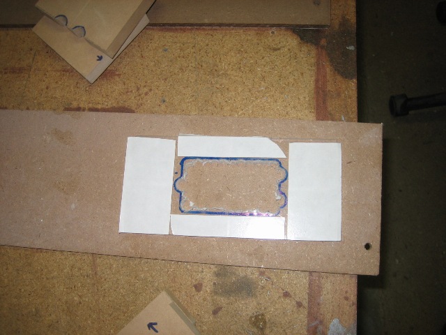

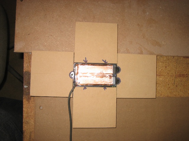

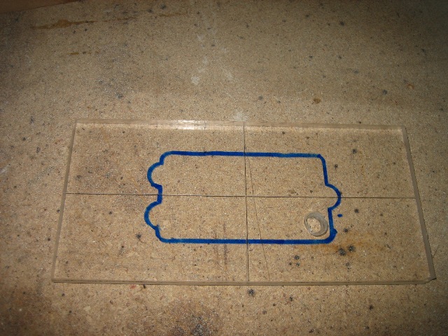

I'll start by making a template for routing the holes. I like plexi templates cause they are easy to line up on the workpiece. I have some of this 1/4" stuff laying around from ??? I don't remember. Anyway, I scribed some centerlines on it.

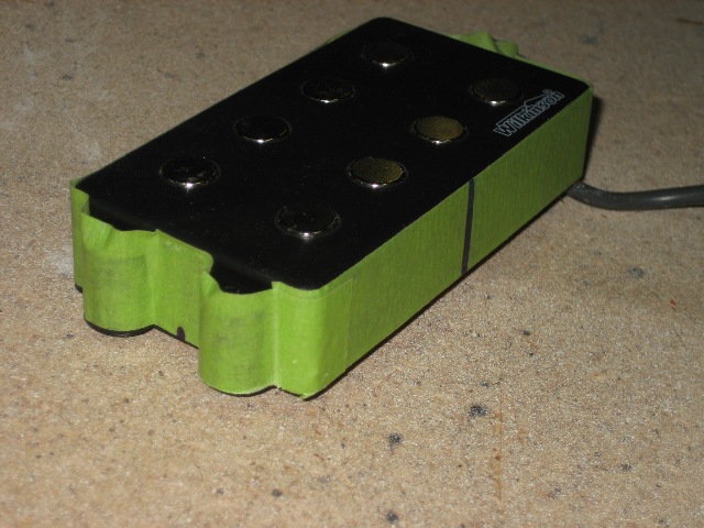

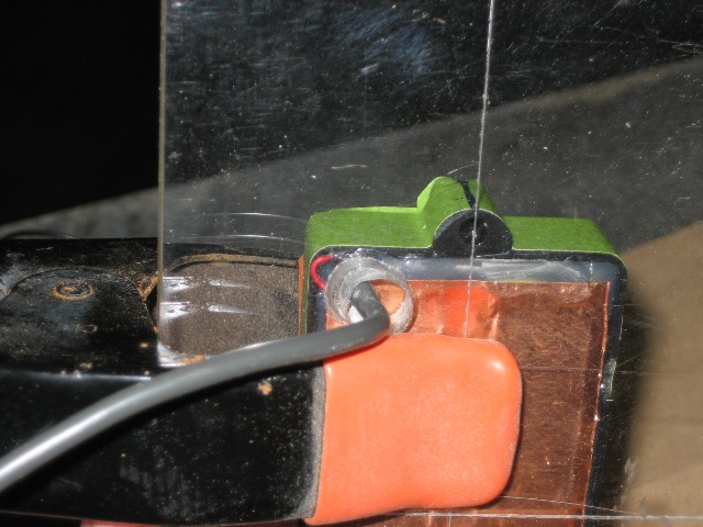

Then I marked centerlines on one of the pickups, wrapped it in some tape so I had something to draw on.
Lined it up on the template and used a spring clamp to hold it in place.
had to put an access hole in it so I could hold it flush to the plexi

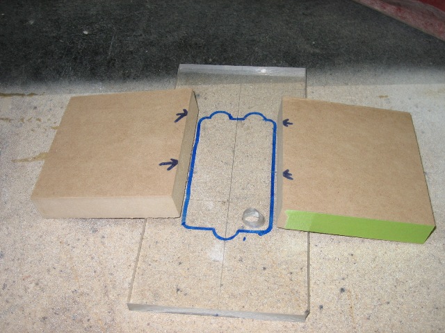

Drew the outline on the plexi to give me something to work from

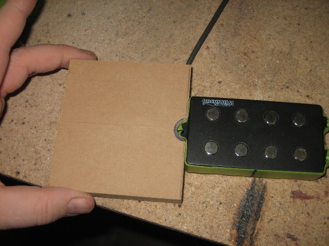

Cut blocks the same width as the PUP for the straight sides

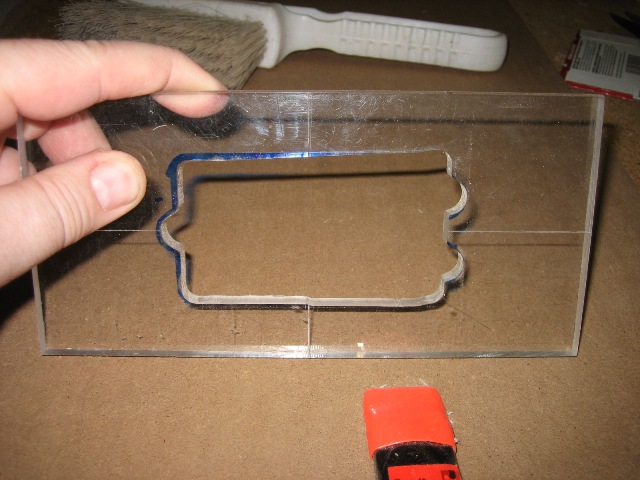

And then made one end just add the round recess for one end, used a forstner bit to start it and then finished it with sandpaper wrapped around a piece of rod close to the final size.
Same thing for the other end, a little trickier with the two bumps. Lots of hand sanding to get it to fit right.
drill out the the hole in the plexi and added some double stick tape
Stick the pieces to the plexi and use the PUP to line it all up.

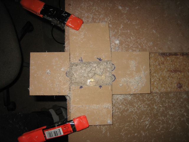

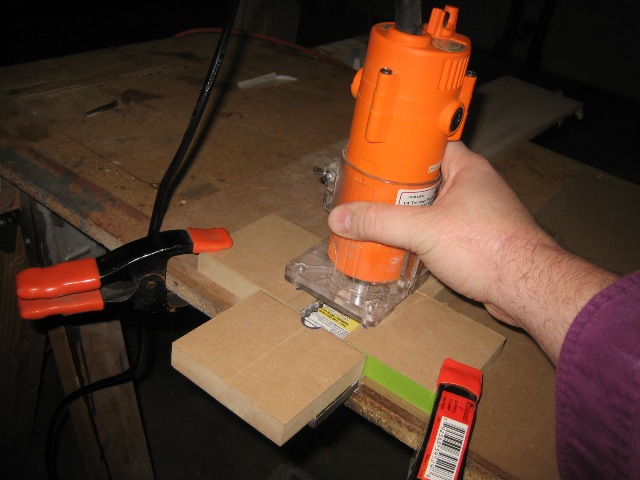

Grab my trim router and make some plastic shavings.
I should mention this stuff makes a real mess, and this is after clearing the chips half way through.
Who sees the problem here.
Yup, the tape and spring clamp still let my sides move.
Well it seemed like it would work
