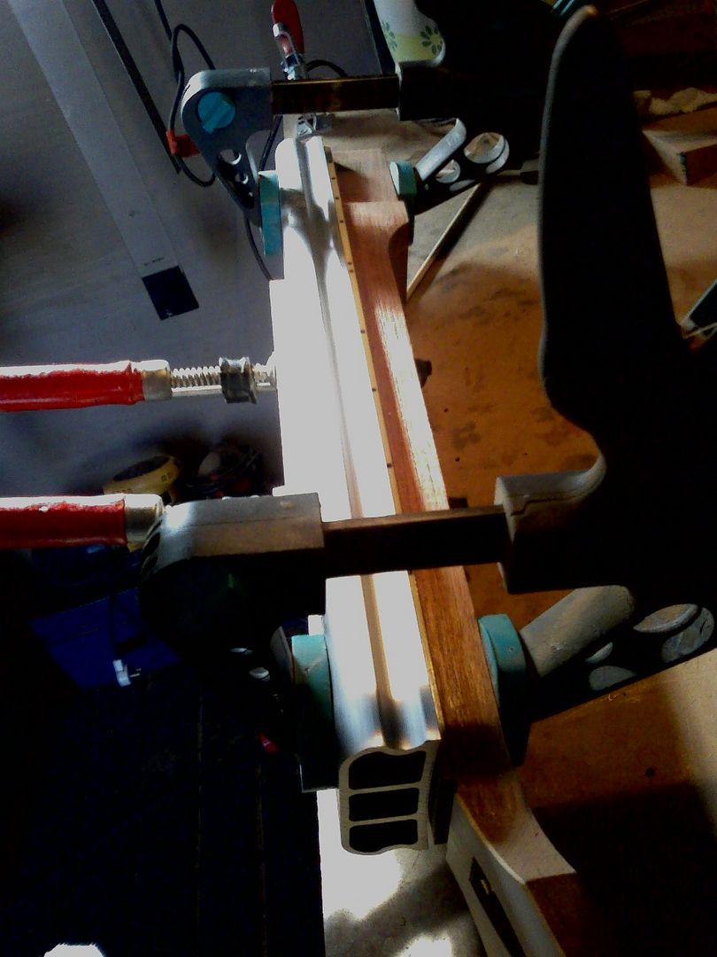

A few words on neck to body glue joint. All 50's LP's have a little space between the fingerboard and the body top. You will see this on the originals but not on the RI's.
I never understood this thing... why on earth would they leave this gap ?!!?
until I experimented with different hide glue techniques.
When doing the final neck fitting with chisels and sanding the neck fits the body perfectly... but... when using hide glue there are many little tricks and methods to achieve different glue joint properties... for the neck joint Gibson used TONS of glue to make up for the gaps they had between the tenon and mortise. If you removed old necks you probably know exactly what I'm talking about.... Now, hide glue has a lot of body and gels real fast (can be used as filler too!), so normally only a thin layer is used for most gluing jobs (like I did on the fingerboard).. but not on 50's LP necks (-;
I'm going to replicate that for two reasons:
1) I believe it's an important part of the 50's structure and contributes a lot to "the tone"
2) This is one of the things that set the originals apart from the RI's and I wish to preserve that look
I'm not aiming for the huge gaps seen on some examples... just a little.
preeb is offline   Reply With Quote
Old February 23rd, 2010, 03:36 PM   #995 (permalink)
preeb's Avatar
Join Date: Sep 2008
Location: Israel
Posts: 6,419
I cleaned the mortise well. even a little grain will cause trouble. I forgot to mention that the entry routing was done with 1/2" dia bit but the bottom (which is left after the pu routing) was done with 3/4" dia bit to match the originals. This is visible in this shot
Final dry fit and clean up and I'm ready to go
A lot of hide glue... it drips all over too... in this case there's time to take the shot
and a simple single clamp... just like in the 50's.. I applied pressure and stopped when the gaps got tasteful enough (-;

I added 50% more water to the glue and a spoon of salt for the nut glue. I only use a little bit of the thinned glue in the slot and press the nut super tight (important)
I'll let it cure until tomorrow.
