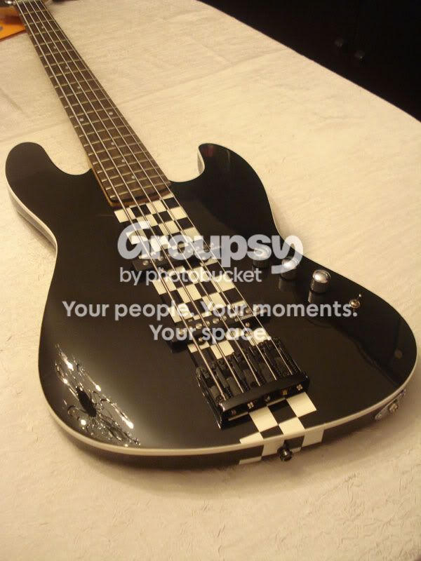

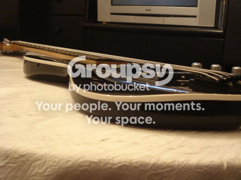

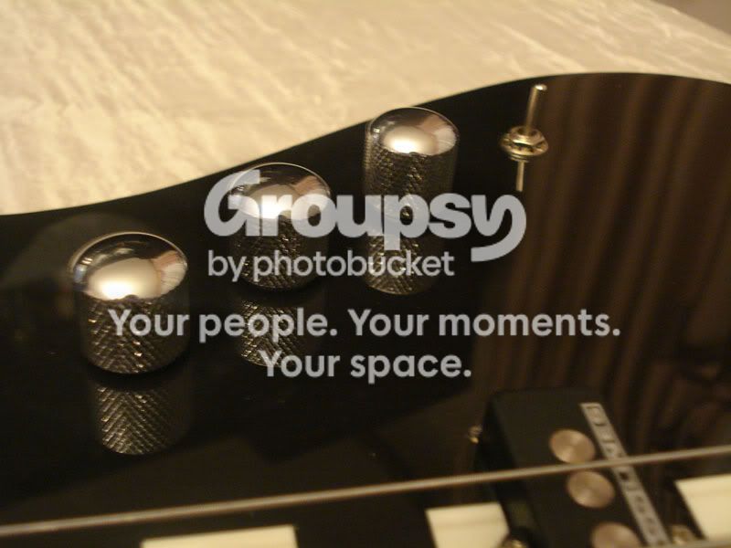

Here's another bass, I made just the body, neck is Squier precision...
It has serial/parallel switch, it works great. Pickups are SD Basslines.

I'm glad I can't do finishes like that, 'cuz I would just stay in the house all day and stare at them. Wow! That is a mirror finish. The checkerboard and the contoured binding is out of this world.

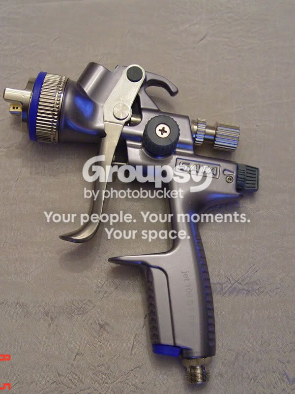

It's also important to have good spraying equipment. Buying expencive spraying gun isn't waste of money. I bought new sata spraying gun this year and it's great. I do everything with it, finishing and sunbursting.
Sanding between two coates is just like sanding the wood, but with finer paper. Before last coat I use 800 grit, and then very thin coat. One more sanding before polishing with 1000 and 2500 grit paper.

Many thanks for that detailed reply. A couple more things , I may have missed them , What lacquer do you use and what size needle in your Sata. Is that a HVLP gun ? Thanks Mac
macaroonie is online now   Reply With Quote
Old August 25th, 2010, 02:43 PM   #39 (permalink)
Join Date: Jan 2009
Location: Croatia
Age: 21
Posts: 159
I use nitro or polyurethane lacquer from our local store.
Needle size is 1,6, it is a HVLP gun.
