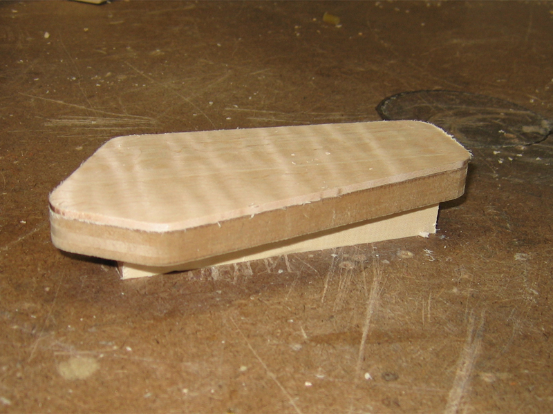

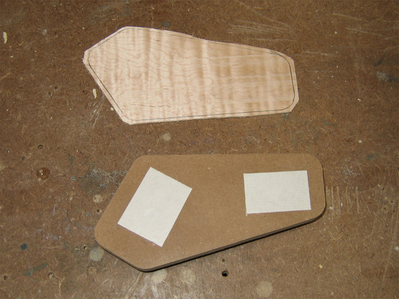

You can sandwich the thin wood between 2 routing templates and it will work fine. Depending on what type of bit you use, one of the templates can be undersized slightly so you don't have to worry about perfect alignment.

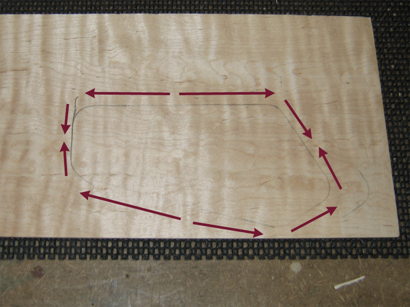

I routed a control cover this weekend with 2mm thick maple and it worked fine with a single template. Just make sure you have a sharp bit, start on side grain and move toward end grain. Starting on end grain will cause splitting as you move into side grain.
I just screwed the template to my tabletop and used a thin strip of maple as a spacer.

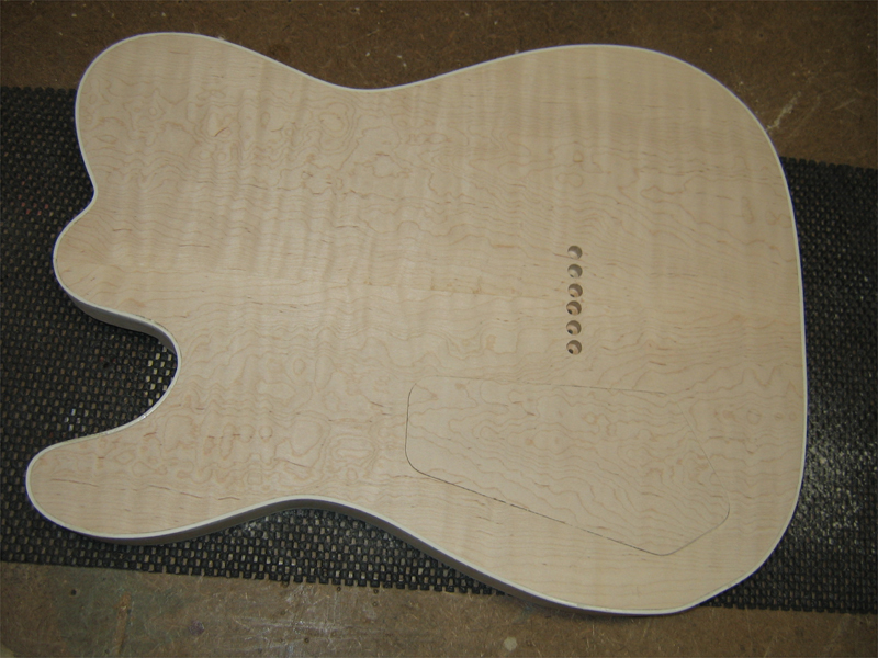

If your worried about it once complete...don't. Birdseye is flatsawn wood. Probably the best choice for a pickguard. 1/8" thick is plenty thick for a pickguard screwed to the body.
