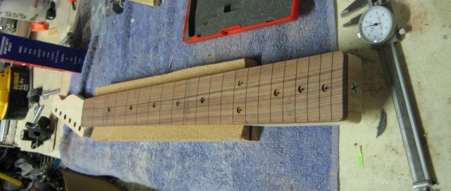

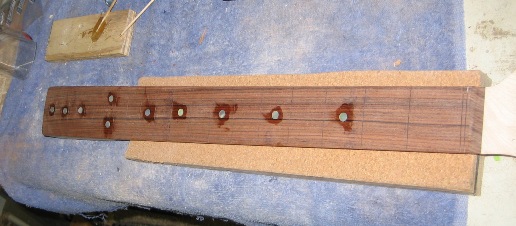

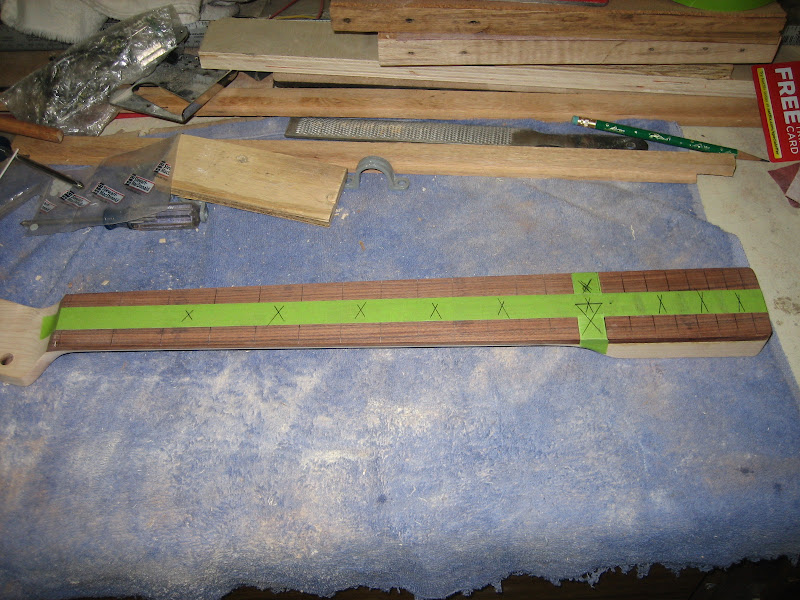

Time to put in the fret markers.
Now that the fretboard is radiused time to put the fretmarkers on.
So I marked the board to where the markers would go, taped it off mainly to be able to see the marks better.
Drilled the holes with a 1/4" forstner bit.
by the way anybody notice my "learning opportunity" yet, I didnt'.

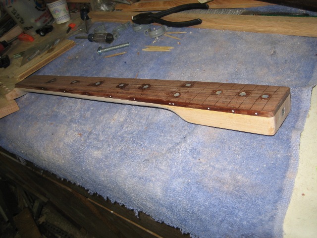

mixed up some epoxy and glued in the MOP dots.

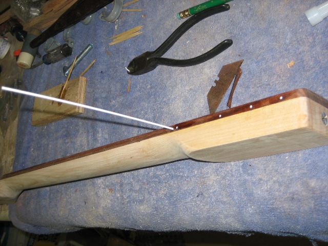

Then I drilled 1/16" holes along the edge for the side markers and glued in plastic rod with a little CA.
Trimmed them up with a razor blade and let it set before I sand it.
This is where I should have included the pic of everything all sanded but after I sanded is when I notice the mistake, I mean "learning opportunity".
Anybody pick up on it yet?
- Quando Omni Flunkus Moritati
gagidlof is offline   Reply With Quote

Is your learning opportunity related to the double markers coming in at the 14th fret instead of the 12th? Seems like something I could see myself doing also....

3,5,7,9,11,14 what?
Ding, ding, ding, ding.... Yeah, you spotted it. Too bad I didn't until too late. What's that old adage? Measure twice cut once.
Lesson learned, patience, don't rush, double and tripple check before drilling, cutting, or anything that is not reversible.
So look for my next chapter in this thread, how to fix it.
Although I kinda liked my friend at works suggestion, fix the side ones but leave the front alone and really mess with people when they watch you play.
"Hmm it sounds right but I usually play that at the 9th fret, this guy plays it at 7..."

What side dot marker rod did you use? I can't find any that long... Help!
I bought the stuff from StewMac its 1/16" x 6" worked great.
http://www.stewmac.com/shop/Bindings..._Material.html
