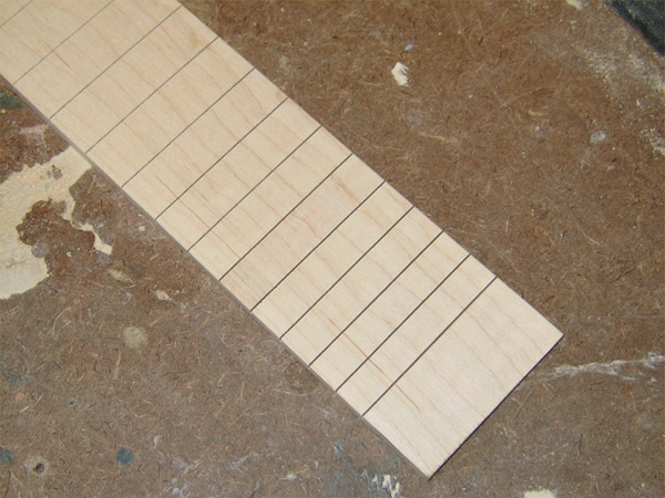

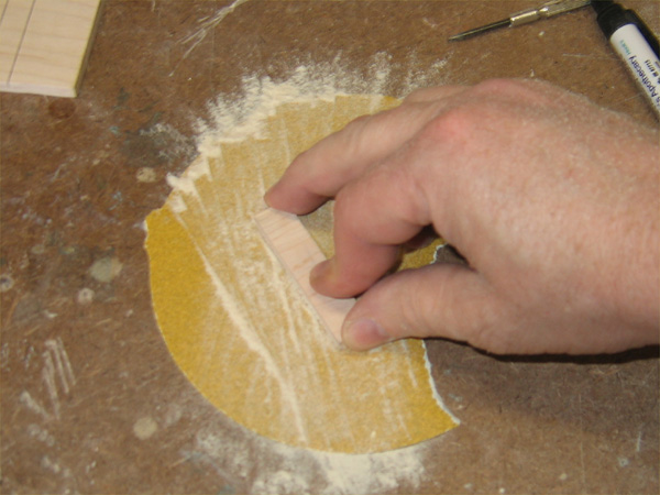

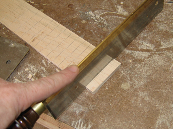

I was slotting some fretboards today and on my third one, I was doing fine until about the 17th fret or so. Using the StewMac miter jig, template and fret saw should make this bullet proof. But, I didn't get the template down on the pin and I cut a fret slot in the wrong place. My first thought was "Crap, I ruined another one!" But as I was working on the 4th board, I decided I wasn't going to waste it. So, here's what I did to fix it...I'm happy with the results. I wouldn't put this on a guitar other than one for myself but I doubt anyone would be the wiser if I did.

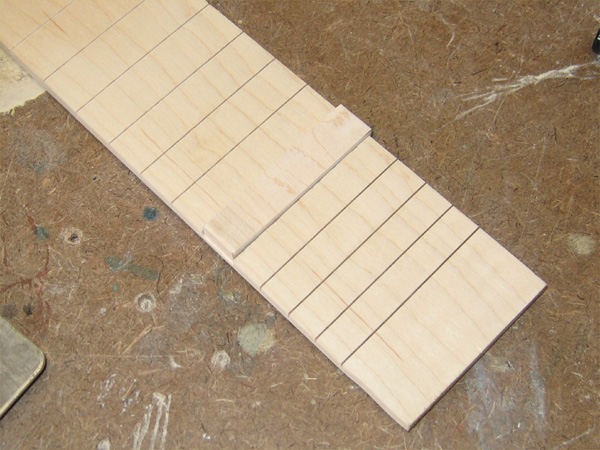

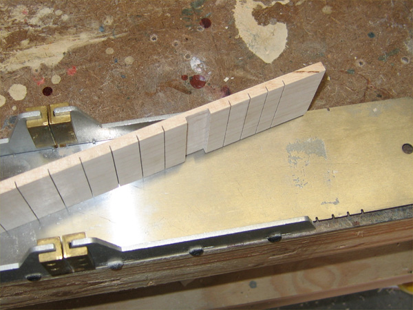

First I cut the fret slot in the correct position, then made cuts in the miter about an 1/8" apart to the fret slot depth. Then I took a 1/4" chisel and cleaned out the area between the 2 slots.

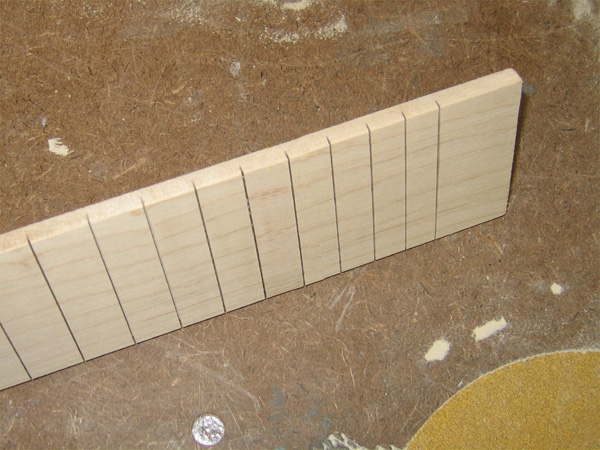

Then I trimmed a piece off the end of one of the other fretboards.
I matched up the grain as best I could.
Then thinned it down to just a bit thicker than the fretboard.
More in next post...

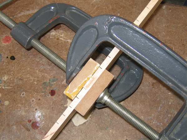

Next I glued the piece in place.
Then leveled it out.

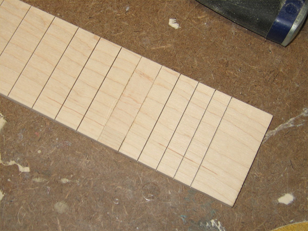

Then recut the fret slots.
Aside from a slightly different grain pattern, it blends in pretty nicely. By the time I get it fretted and finished, it should be less obvious still.
Hopefully this will be of some help to others. I'm glad I didn't toss it in the trash.
