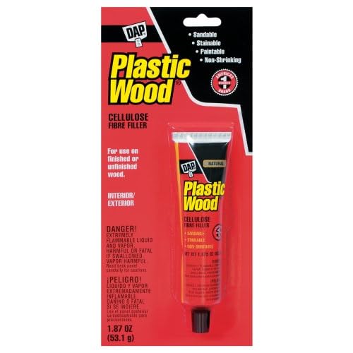

I use Plastic Wood for patching my mistakes. It's solvent based so it sets up quickly. I recommend buying it in the tubes rather than the cans. You're usually using only a small amount and in the tubes it can be stored longer without getting hard.
