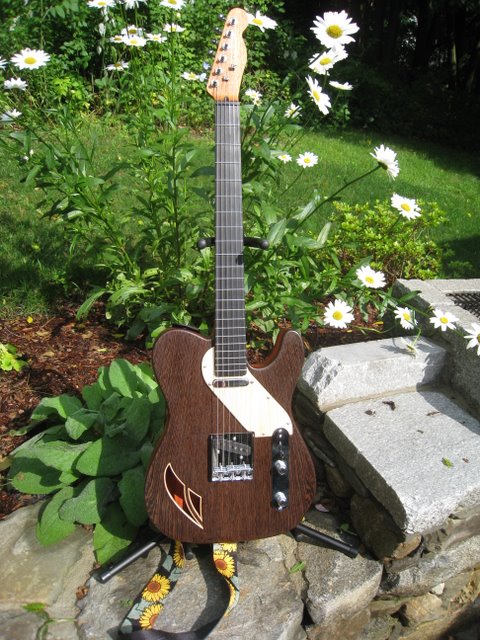

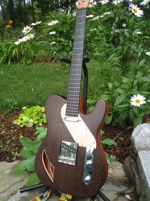

Hi Guys,
It's about time I posted something on this forum. I've learned so much here that I feel a little obliged. ok, and I think this one turned out pretty great.
So here's my latest build.

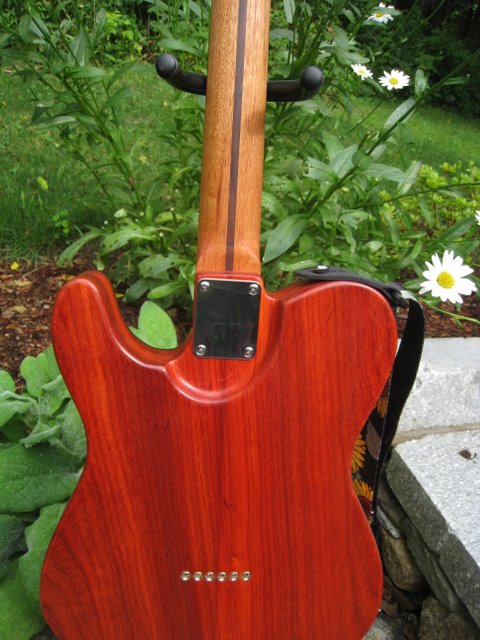

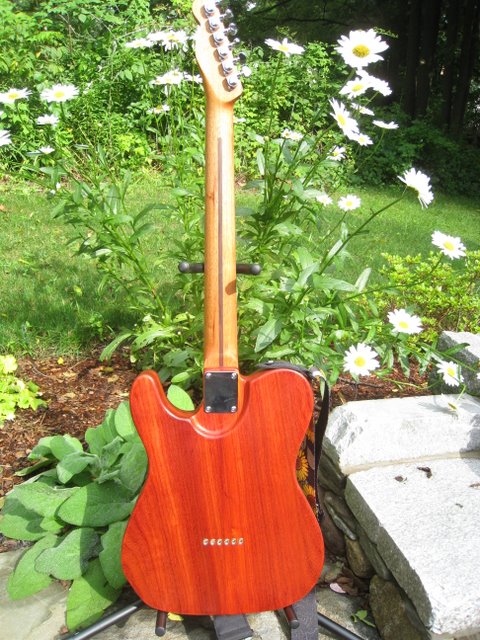

Wenge top on Padouk. Mostly hollow, a block remains from neck pocket to the back of the bridge. It's deeper than usual, at a little over 2 inches.
Sound hole is bound with maple, pickguard is ash. I'm not real happy with the pickguard, but rushed it a little bit so the guitar would be ready for a gig this past weekend. I think I'll redo it to match closer to the soundhole shape.
Body is finished with Shellac.
Chunky C shaped mahogany neck with ebony board. Finished with oil / wax.
This was a fun one to build.
Working with Wenge was not too bad. Sanding padouk sucks. Red dust everywhere and tough to keep from bleeding to the other woods.
Soundhole was a lot harder than I thought. I was going for a little different shape, but the oops factor came into play, and I actually like how it turned out.
Any feedback/suggestions would be great. Don't hold back!

Personally... I'd lose the flowers
That's an awesome looking thinline. Excellent! Good job. Love that heel design and the "f" hole (not quite sure what to call it anymore )

Beautiful, classy guitar! Congratulations!
Don't like the pickguard much either...

looks like my dream guitar. Only one thing I would of done different if it was my build. The transition to the cutaway beside the neckplate. So the wood curves back into full thickness in a smooth line. Does that make sense? Any ways, that's just my 2 cents. Looks very professional.

I'm not sure I see what you mean... body shape or pickguard?
For the pickguard, I'm definitely re-doing it. The shape will be a larger version of the 2 combined soundholes.
And I think I'll try a different material ... the ash pickguard and maple binding on the holes doesn't seem like the right fit. Not sure that plastic is right either though. Any suggestions?

Diggin' the soundholes.. not diggin' the guard. I'd be trying to match the soundholes on guard .. somehow...

P.S I love the recessed area around the neck plate. I might have to steal that idea.

I like the ebony fretboard with no dots and the neck plate recess. Nicely done.
Do you think a mini pickguard like on the La Cabronita would suit it? I do - it would balance the f-hole. JMHO.

That's just classy. I like it very much. I like the no dots, the back and the neckplate. So cool.
