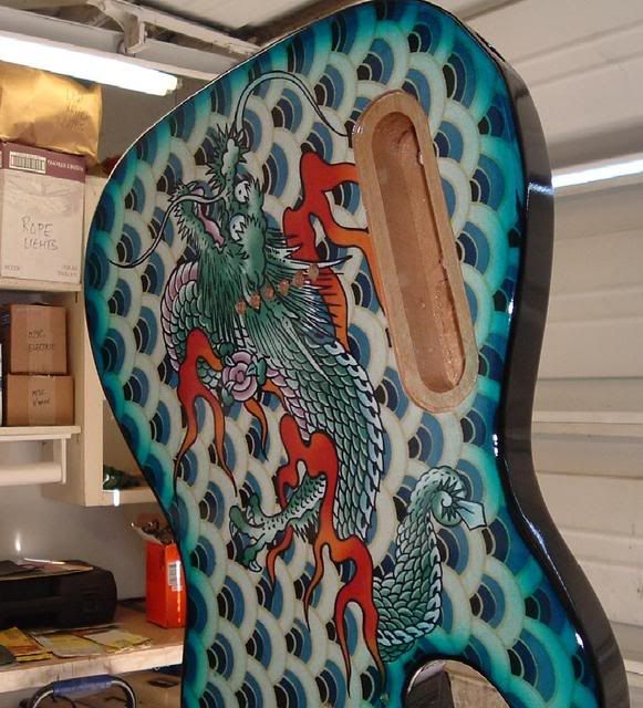

My Dragon-caster....
Work on this one has been slow going. I've been battling gout & being on my feet, for any length of time, is a problem. I've also got another build going at the same time and I'm dividing my time between them.
This will be finished black on the outer edge and have a blue "burst" to transition between the black and the pattern. Black single layer pickguard and maple neck.

How did you adhere the graphic? Or are you a brilliant painter as well?
It is fabric that was attached with Decoupage glue. I laid down a pretty thick layer of it and put the fabric on. Then I used a plastic card to squeegee the glue smooth and get it to soak into & through the fabric. A couple coats of glue on top and then let it dry. Once dry and hard I used an X-acto to trim the excess off. Superglue gel on the edges to get the transition smooth between the fabric & wood. Lot's of sanding sealer and sanding. It's almost ready to start clear coating.

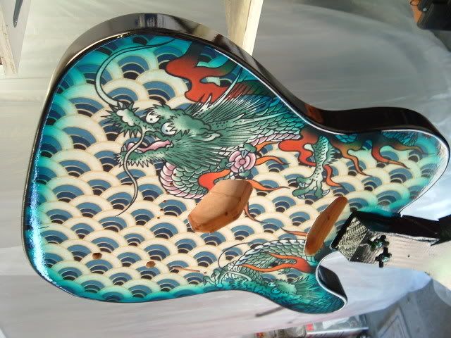

I finally got some more done on this project. Now it just needs more clear then wait.
