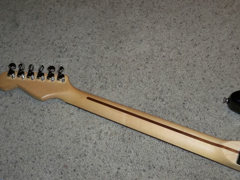

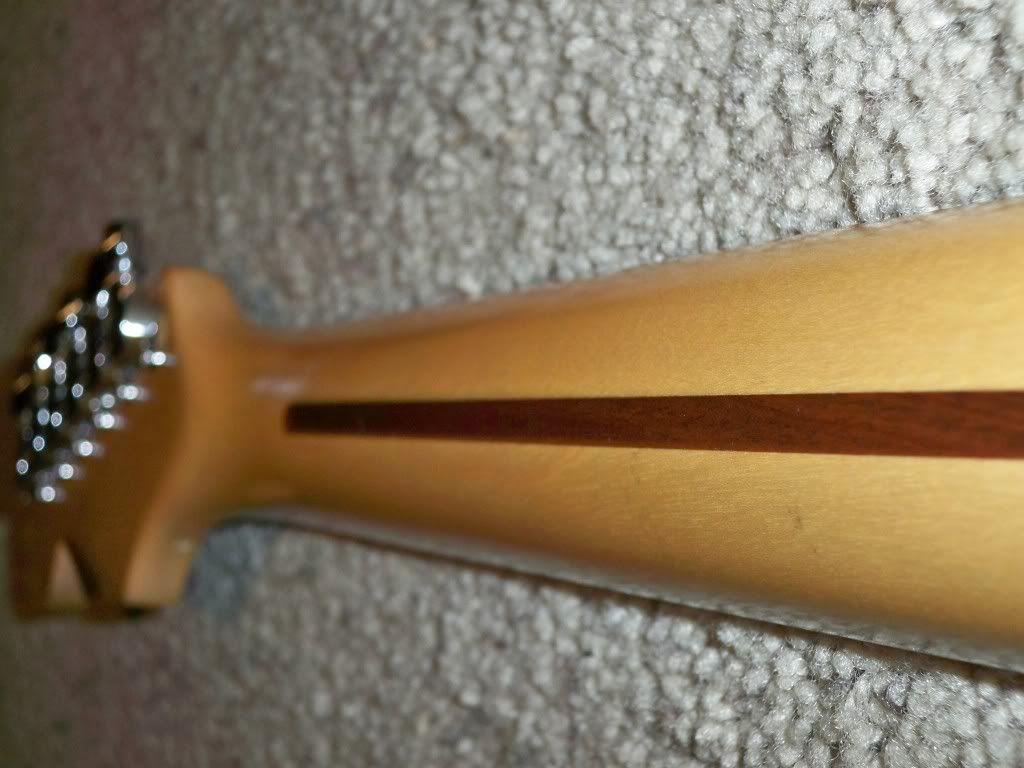

Hello there!! I have a made in korea strat. It says fender as the main logo, very small it says squier. Its just here, sitting in a case, use to belong to my brother years ago, atleast 15 years or so. Now its just sitting in a case, he doesnt play anymore.
Well.. anyway, what I want to know is, would it be worth it so put some new pickups and hardware on it? It gives a scratching sound switching between pickups and using the knobs. The neck feels fine, from what I can tell its 1 piece, apart from the line in the back. Everything feels good, but would it be worth it?

I'd say yes, provided the guitar feels well played acoustically.
Most important is if the neck feels right to you.
Korean Squiers/Fenders have a fairly nice build quality, just not that great electronics; my Fender MIK Strat's biggest problems were the dull pickups and the (for my needs) too thin neck.

Get a can of Caig DeOxit D5 contact cleaner. Spray the switch run it back and forth a dozen times. Lift the pickplate to get a short spray into each pot you can spray it into the gap by the terminals. Exercise each of the pots running it back and forth a bit. Likely to fix your problems.

What I'd do is check to make sure it's a solid wood body--you can do this when you do the contact cleaner, just look on the inside of the routs, the plys of laminates are pretty easy to see. Plywood bodies can be decent, but your chances are better with solid wood.
The neck looks pretty good, maybe it just needs some TLC.
