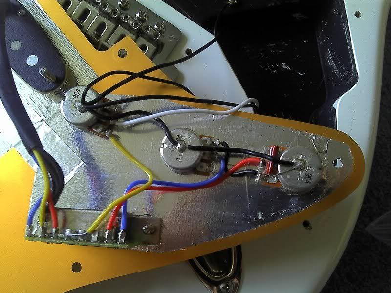

Hello!
I'm looking for the name of the mod that allows you to have all 3 pickups on at the same time, With a simple on/off switch. This is for a Baritone Strat I'm building part Warmoth and part CV 50's.
If anyone knows the name of the mod and knows where there is a simple wiring diagram, it would be most helpful!

The nearest I have is this one - it uses a switch (or push-pull) to add the bridge pickup to whatever is selected, so the neck & middle position becomes all 3 pickups. And neck position becomes neck & bridge - very Tele like. There is another variant that adds the neck pickup - same thing but in reverse.
Any good?

As it turns out I'm not really sure where to start with the electronics! it appears the Squier have put in 5 way switch with a circuit board on it. (As pictured below)
I'm pretty happy with the 5 way switch there, has a nice feel to it.
I won't be to happy replacing a lot of the electronics, as I have only done a few pickup rewiring before.
Is there anyway to a push pull pot into this without changing to much?

Yes, all you have to do is to replace one of the pots with a 250k push/pull pot & you have your switch available to do the mod I posted at the top of the page. It's up to you which pot you choose to replace - I prefer the tone pot, but if volume seems more logical to you, use that instead.
You can get all kinds of pots from http://www.axesrus.com/ - free postage in the UK.
My advice is to stick to the simple diagram at first if you're not used to doing wiring work on guitars. Don't worry about series wiring or complicated rotary switches till you've tried some more basic stuff.
