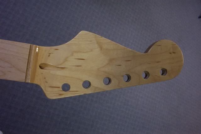

Eden necks are drilled for Modern tuners, but I got a sweet deal on some Vintage Pings, so we had to buy some bushings from GFS.
Headstock looked good though...

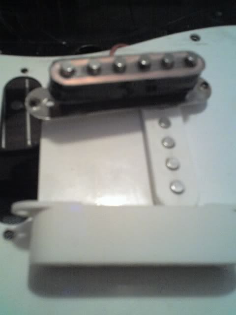

Now I am not a purist by any stretch of the imagination, so I thought one day I might want a SSH, so I made the bridge pup cavity flexible. I am also going to set up a reverse slanted bridge pup, so this will allow a standard set up, a reverse slant and a bucker if I wanted... options!!
I drilled all the starting holes, so off to the band saw for some cutting!

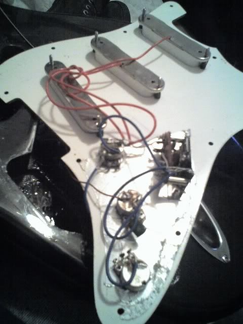

Now the Bentley was nothing to look at... but it had some parts... and for $60 it fit the cheapness factor...
So many guitars... so little time.
Preacher is offline   Reply With Quote
Old July 3rd, 2008, 10:59 AM   #12 (permalink)
Preacher's Avatar
Join Date: Apr 2007
Location: Oklahoma
Posts: 245
not too sure about the pups, they look to new to be in that guitar and the soldering looks too much like someone like me added them. They have a certain vintage look to them...
Still have not ran the Ohms, but I do not think they are overwound or hot.

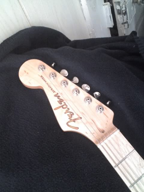

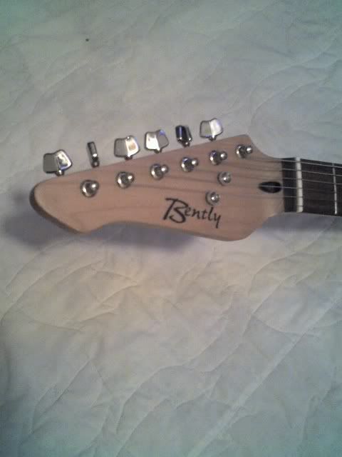

So after a little work I installed the tuners, man I love those vintage looking Pings and the bushings and did a logo... for the headstock logo police read it carefully, and yes it has fooled at least a dozen people at this point.
Oh and I cut my own Corian nut, used some needle files to the slots and it turned out pretty good for my first one...

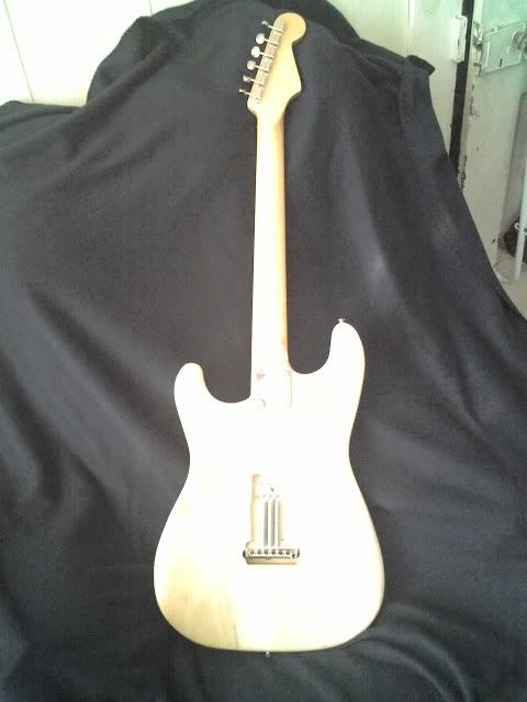

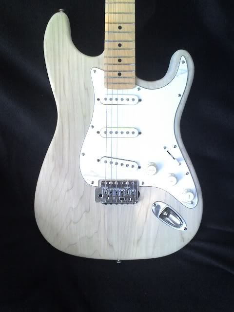

So after some sanding we fit it all together to see how it fits...
It is a little rough and I need to adjust the neck angle somewhat, but I am happy. So happy I played it for about a month like that but did not unveil it to the public.

Now we have a problem. As I mentioned this body is poplar, but the grain looks pretty good, too good to get painted I start thinking. So maybe a burst as the back has more green mineral streaks than the front. Maybe a Cherry burst, hmmmmm... <slaps himself in the face> snap out of it, we started to do a Jimmistrat and we will stay with the plan!!!
So the tear down begins!!!

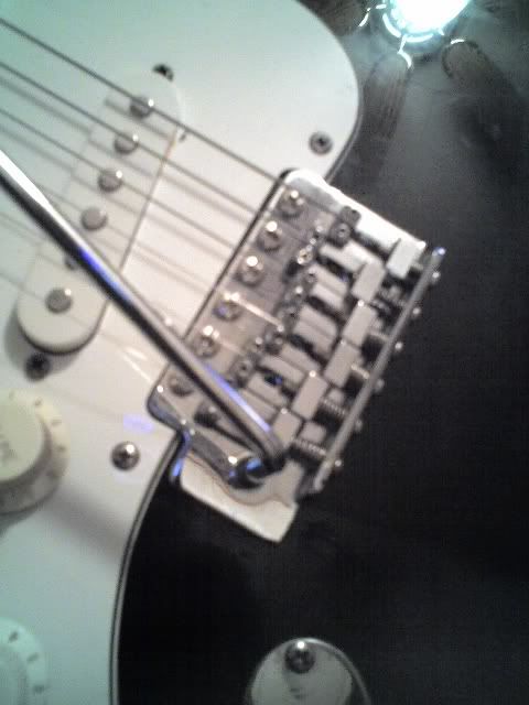

great job! I noiced the bridge looks lefty. did that make it harder for you to make?

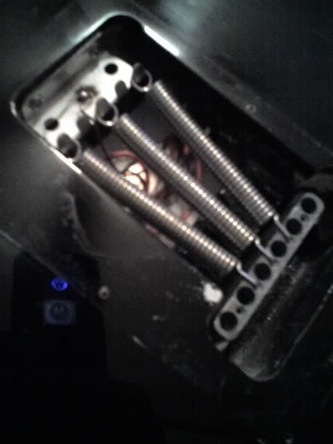

Good eyes... yes the orignal plan was to put a vintage "righty" tremolo on it, after I had cut out the body for the "righty", I got the "lefty" on the donor guitar which would keep it more like Jimmi's. So when I went to put it on, the slot for the tremolo is not symetrical on the mid line of the body, so I had to do a little more route. If I had it to do over again I would have gone ahead and bought the "righty" tremolo and not cut the body. You can see just below the bridge that there is a slight hole you can see.
Oh well, live and learn.
