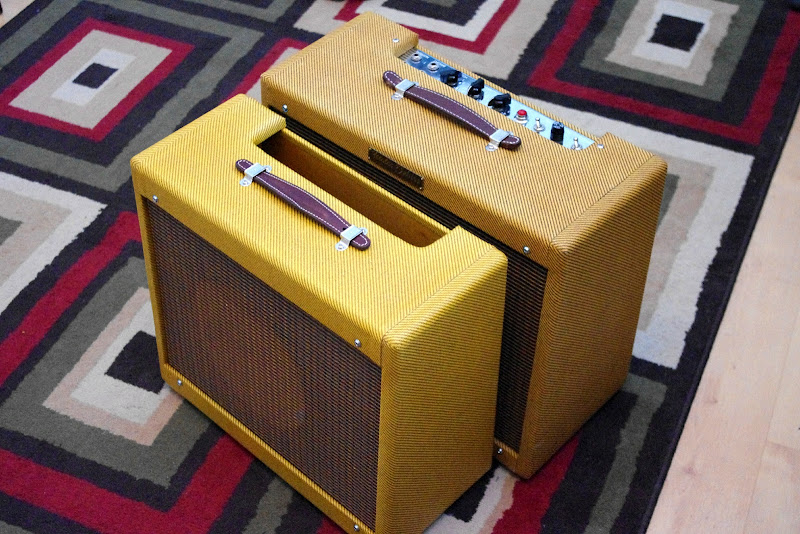

Yet Another...5F2A Tweed Princeton build
My parts are starting to roll in for my 5F2A clone build. I sourced the parts from various suppliers. Here is how I did it this time:
5F2A guts from Boothill Amps (Hackworth1)
Tweed Cab from Bruce at Memphis Amps. Cut for 10" speaker
Weber Silver Bell 10" 8 ohm alinco speaker, used from a forum member
Chassis, PT and OT are Heyboer from Weber
Misc NOS Tubes
As of this writing the circuit board is populated. I am waiting for my trannies and chassis to show up from Weber. Here are a few shots of the cab. I sat it beside my deluxe for quick comparison. I now see that the tweed seems to darken up over time.
After some trial runs at cutting finger joints in to pine boards, I gave up. A wood worker I am not. Bruce does a great job on pine cabs. Both of mine were made by him. I can only image how frustrated I'd be, trying to get the tweed on there right.
More to come as the project progresses.

Generally, the tweed currently used in the guitar amp market comes in two basic types. One type has a light olive green stripe, the other has a brown stripe.
The olive green stuff has had some poor runs lately with defects in the weave. The brown stripe has been consistently good.
The cabinet coloring can differ according to age, of course. It can also differ according to the shellac mix one uses at the get go. More dilute makes a yellow tone. More concentrate makes an orangey hue.
A clear lacquer top coat makes the finish more plastic-like and more stain resistant and durable.
Both of your cabs look very nice, BTW.

Awesome! Would love to hear your impressions of the speaker when it's fired up! What prompted the 10 instead of a 12? Variety?

Andy I went with the 10" speaker to fill a hole in my fleet of amps. I already owned a 1x8 SFVC, 1x12 tweed deluxe, and a 2x12 BF Bandmaster. Now I get a 10" too! I went with the Silver Bell just because I got a great deal on it. It was new in Nov and the guy barely used it. I am going to have to break it in. I was leaning toward the 10A100, but the Silver Bell deal was so attractive I thought, what the heck. Plus, I don't think I've bumped into anyone on here with a Silver Bell in a 5F2A, so it will be a fun experiment. I will post some clips when it is all done.

My Dr. said pics :)
nudge nudge.
Is that cab a special size for the 10" or just a diff. baffle? I like the size, wondering if one could squeeze a 12" in there along with an obnoxiously large OT.

Andy no pics to share yet as there has been no progress. Still waiting on the Weber chassis and X-formers to arrive. I surely will post as things develop. I will measure the cab and follow up.
