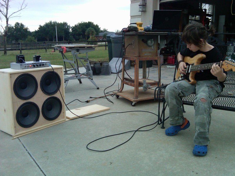

My Blackheart arrived so I've been playing with that. I CANNOT BELIEVE how nice it is.
As far as construction, and sound? WOW! The cabinet is very sturdy and heavy, the chassis seems very heavy duty and quality. I like the layout, and when I opened it up, there is a lot of room in the chassis.
I'm very happy with it. It's sounds huge out of these speakers, I've heard some say this amp is too bright, and they cut the treble and boost the bass to compensate, but with these speakers in the cabinet I built, I sure don't find that to be the case.
It was very noisy when I got it. Seemed like it was amplifying things that weren't coming from the guitar.
I opened it up and made some minor changes described somewhere on the web, guitarnuts.com maybe? Anyway, just untangled and moved a bunch of wires around, disconnected a couple that go to the pcb board but apparently don't do anything, and I removed the metal cover over one tube. Not sure why that cover is needed? Doing those things made a HUGE difference, more than I really thought it would. I learned how to check the tubes for being 'microphonic' and they are not. From my description before, I was sure that they must be, but all that went away with the few changes I made.
I do hear a scratch when I adjust the volume knob, not any other knobs but when touch volume, it's makes an amplified scratching sound like the pot is not quite right. Very minor, but something I want to correct.

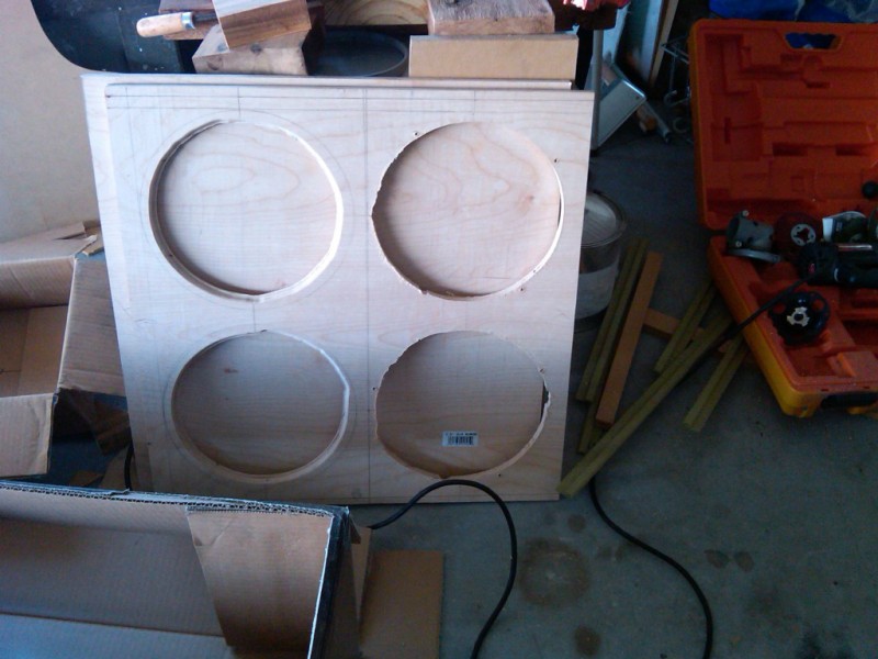

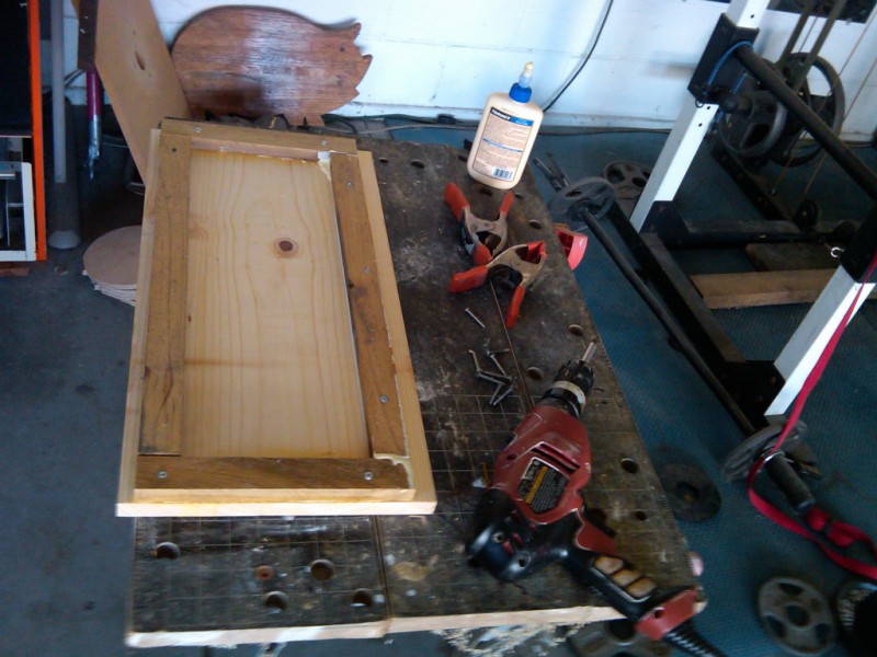

So I spent the weekend building my speaker cabinet. That 2x10 multiplied on me. I don't know how the heck that happened!?!?!?
This is my first cabinet to build, and it's right at the dimensions of a Fender Bassman 4x10.
I know you guys that do this on a regular basis will cringe at the photos below...
I butchered the baffle and will redo it. Long story, but I tried my Rotozip, but the only bit I had broke. Then a combo of template/router from the one hole I did cut, then part freehand with router. At some point, I knew I'd be redoing with a proper jig, so just cut the holes so I could frontmount the speakers to hear them.
I'm actually going to open those holes up and use this one as the frame to mount a grill cloth.
But it is sufficing now to let me test with. I originally planned to front mount the speakers, but I really didn't set the baffle back far enough, so I'll probably rear mount them. As it is, there is EXACLTY 1/4 inch from the front of the baffle to the front edge of the cabinet, with I'd left more.
My first cab, and honestly, I was just hoping I'd end up with a squared up, strong cabinet. No fancy box joints or dovetails. Just solid pine sides and 1/2 inch birch ply baffle front. The four sides are completely glued up and sealed tight, the front baffle I have mounted on the sides the the top and bottom floating, and I'll experiment with the back. From completely open to closed.
In fact, before I move the speakers to a better cut baffle, I'm going cut a port in the front, right in the center, and close the back, just to see what that sounds like.
This is one of the sides, with the braces. It all looks MUCH nicer now! All the glue is cleaned up and I even went back and sealed all the seams where the braces are attached. Cabinet is square and strong, and it looks good enough that I'm probably going to leave it a natural wood finish.
Obviously, I still have a lot to do on it. Redo the baffle, Grill Cloth/covering, finish the wood, install jacks for multiple ohm setups and properly do the speaker mount and wiring. But for now, it's making good sounds, and that's a good thing!

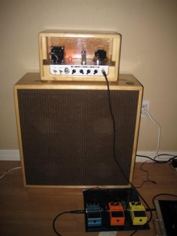

Finally finished my speaker and head cabinet.
BooneDog
