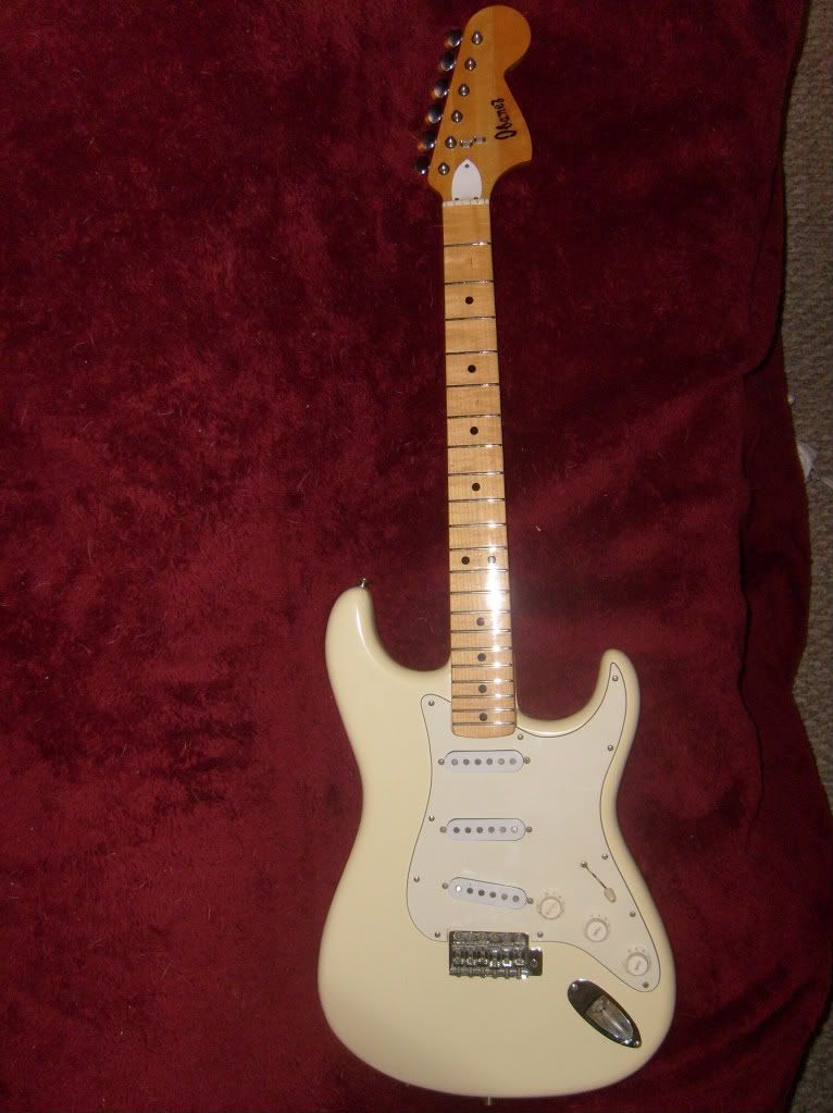

1976 Ibanez "Lawsuit" Strat

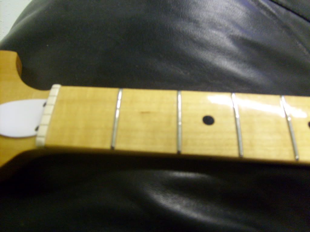

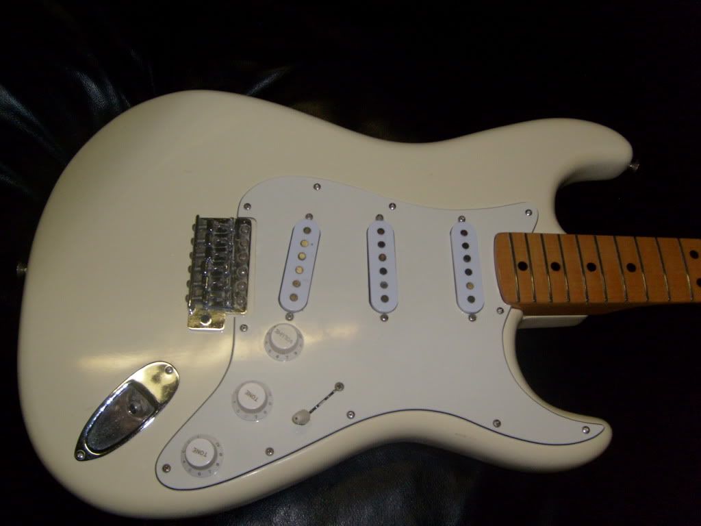

A friend of mine has a buddies Ibanez strat to do some work. I offered to help, "If you're gonna do it, lets do it right."
Here it is.
It needs a fret dress pretty bad, woohoo more practice for me.
It has the six screw synchronized trem, the screws were in way too tight, two of them wont come out they just turn.
When I get them out, I think it needs the matchstick repair?
With a good set up and fret job this could be a really good player.
Does anybody have an idea of value, his buddy said to make an offer.

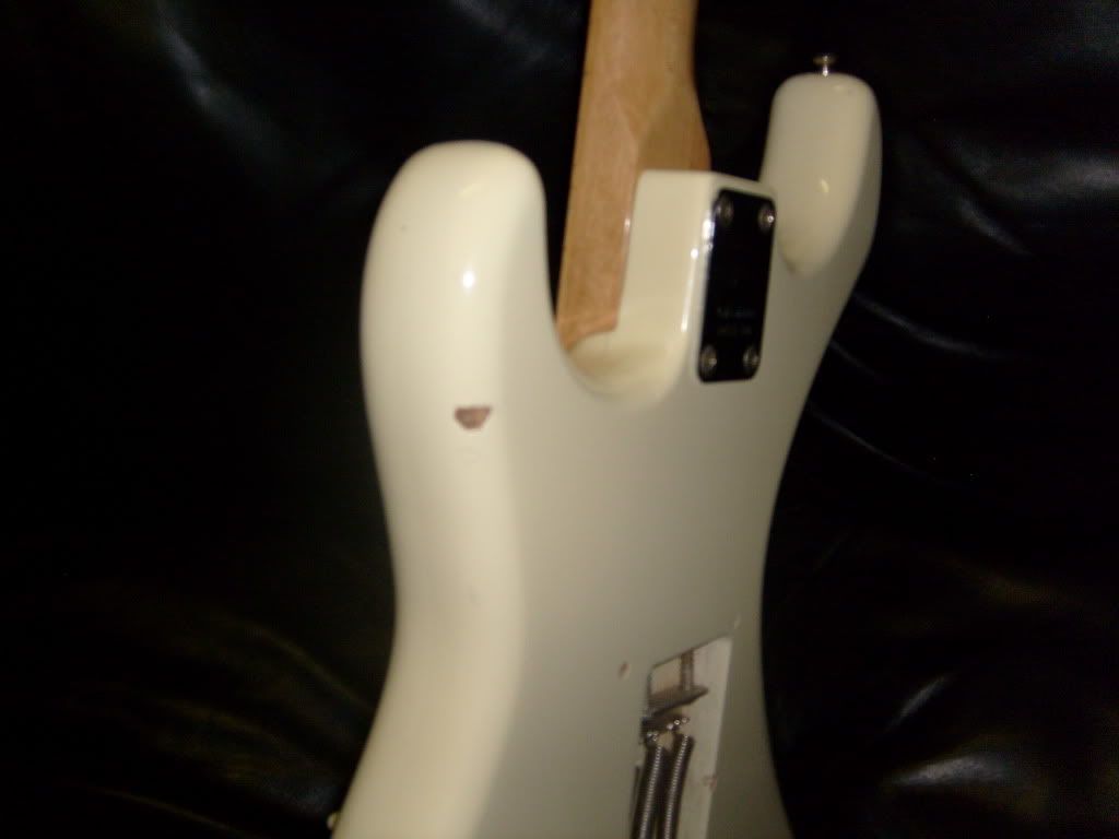

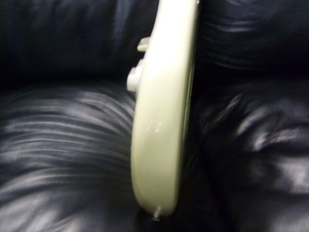

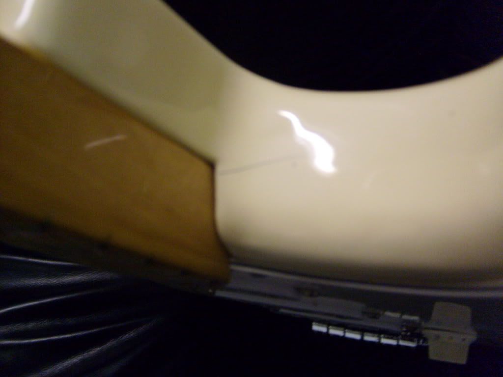

Here are a few pics.
One big chip in the back.
Crack in paint near neck pocket.
Lower bout.
First three frets have pretty good wear, needs to be dressed but still ok.
My 1991 Strat plus has similar wear, gonna fix em both soon.

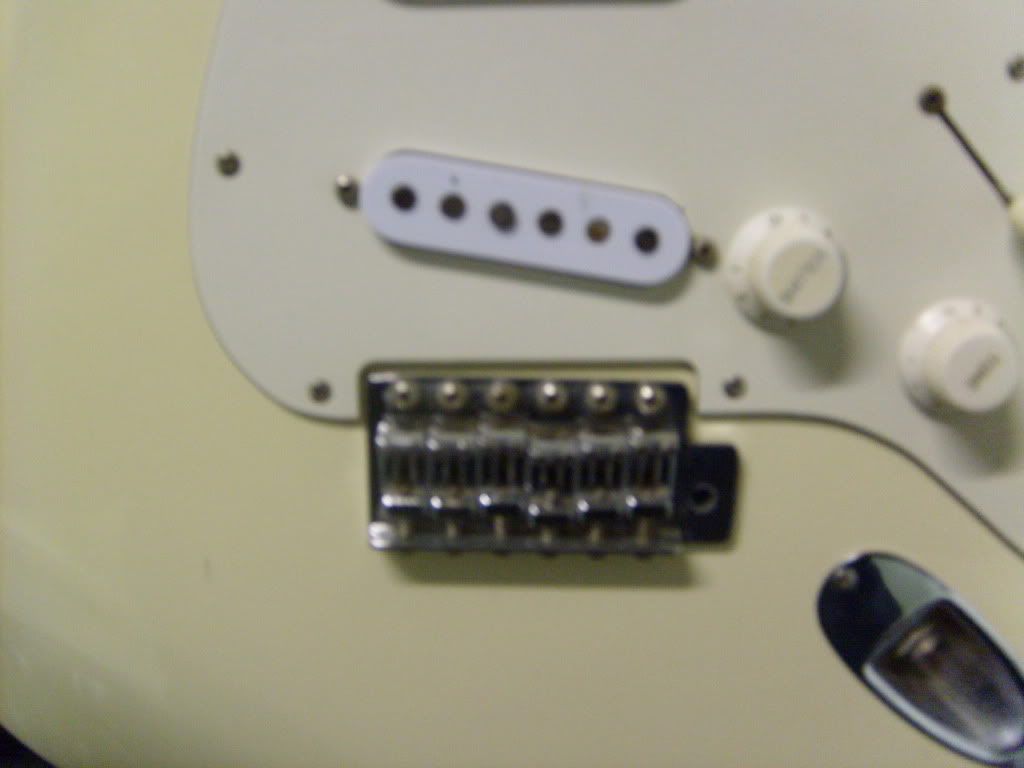

Is it just me or does the bridge look skiwampus? It could just be the way the pick guard is cut.
The two screws on the bass side just turn and don't come out, I will pull them out and make a repair to return it to a serviceable guitar.

Well the two screws that just turned, were not stripped they were broken.
I tried to drill them and use a left hand remover, but the bit wandered on both.
I made a tool to remove them.
Used a piece of tube 1/8" cut some teeth in it with the dremel, mounted it in the drill press, drilled down 1", and cored that sucker like an apple.
Glued in some dowels, drilled new pilot holes, got the bridge back on nice and straight, and set it up with five springs nice and tight to the body.
Used the information here http://www.tdpri.com/forum/tele-tech...ele-101-a.html and made the frets nice and smooth.
Plays like buttah!
I have used the fuzz effect on my Digitech RP 255 before, but it never sounded as good as it does with this guitar, mmmmmmmmmmm nice and hendrixy...
I adjusted the pickup height, and boy this thing quacks.
Great clean sounds, better with a little dirt, and even better with the fuzz!
