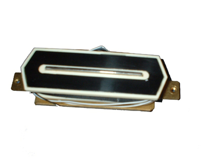

I remember seeing there was a pickup maker that had a Charlie Christian style Tele neck pickup, that fit the standard Tele neck route. Does anyone remember who this was and how it compared to the full size CC by Lollar or VV?

I don't see that possible,
Basically a pickups final sound, is a product of the parts used and shape of the coil.
there is not enough room under the hood of a Tele neck, to make a CC pickup
the CC's 38 gauge wire would barely get to 1k before it was out of room,( Tele necks use 43 gauge because 42 gauge will hardly reach 5k on that chassis)
the CC's large magnets required would never fit in the cavity, the huge blade would take up too much room from the coil...
Take a P-90 they sound like they do partially because of that coil shape they have - "thin & wide"
Now take a Strat or Tele "Tall & Skinny" and they have a much different sound then a P-90
the CC is "wide & tall" the coil is huge - the coil looks like it came off of a battleship...
because of that shape and the wire 38 used and the blade with lots of magnet you get that CC sound.

It's Vintage Vibe.
Email Pete and ask about the VT-N-BL and VT-B-BL.
The set is $195 shipped in the US.

Hey Chrismo, how close to a CC the VT-N-BL's sounding ? I thought part of the sound of a CC was in the 38-gauge wire huge bobbin ?
Wenis, I know it's not CC related but have you heard of mr Novak Jazzmaster neck pup for Tele ? It requires no body routing, just pickguard routing, and it sounds really big, clear and open, not far from a CC I guess, less loud.
