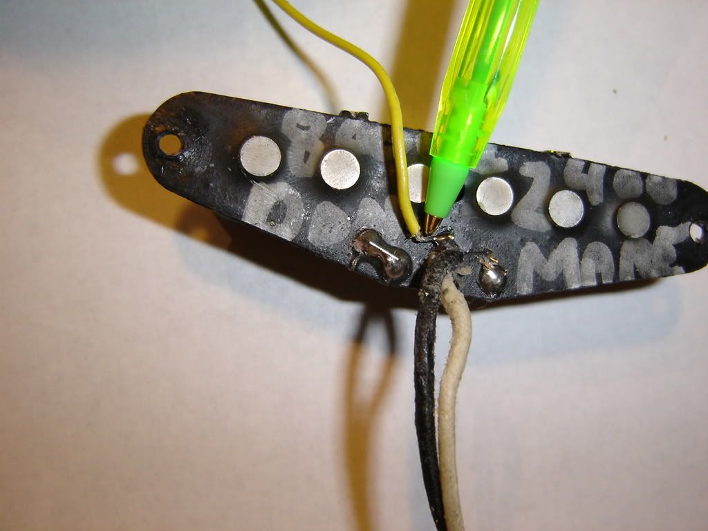

help! my bridge plate is buzzing like crazy when i touch it...
i just did some rewiring on my tele. i have a nocaster bridge and a don mare stelly neck. i had to wire the bridge pickup with the wires swapped to avoid the dreaded out of phase middle position. but there's a problem. the neck pickup sounds great, and the middle and bridge work, but the bridge position hums like crazy. when i touch the bridge it pops a bit and the buzzing lowers some. also, when i touch the control plate. when i run my fingers along the strings, there is a nasty distortion.
what's going on
edit: i should mention that the bridge pickup has a base plate, so it should be grounded without the wire under the bridge. up until the the new neck pickup, there was never a problem there.

Since you switched the wires on your bridge pup...you have to now modify the jumper to the plate, with what is now the ground wire.

thats due to Hot Running into the Bridge from the copper coated elevator base plates adjusting screws,
take and clip away the bare metal ground wire from the base plate (only) ( not the black cloth wire from the eyelet ground )
~next run a separate ground wire to that base plate and it should all be back to normal -
its like the neck - when you switch Ground wires to "hot" you must take out the ground jumper wire to the necks metal cover or in your special case the "base Plate"
usually we only reverse wires at the neck pickup on a Tele-
this is because - sometimes the bridge pickup will not stop grounding out to the base plate
- as it was- the old Fenders will sometimes ground the magnets to the plate - this happend from those pesky partial shorts in the start wires of the fine wire coil itself.

Originally Posted by vanguard View Post
is there a simpler way to keep the neck pickup from buzzing when i touch it?
same trick -- take off the bare wire that connects the coils ground over to the cover - look at the bottom of the pickup - see the shiny solder joint in the middle? - thats hiding a small bare wire - heat that joint and lift that wire away from the covers bent over metal holding tab -- next solder a whole new section (piece) of wire. one thats at least 13" long ~~~ and run it on under with the others, so it runs on over to the cavity - where it then gets soldered to the back of any pot , it acts as a ground for that neck pickups metal cover.
no more buzz
Don Mare is offline   Reply With Quote

Here's a Picture of what the folks are trying to explain for you.
Nice picture, ( i copied it and save it- very helpful indeed!- for future customers)
: but it shows the cover taps on 180* out - normally on all fenders we see just one tab (centered) on the cloth wire on hook up side of the bobbin ~ and so the remaining two tabs from the metal pickup cover are always on the non hook up side of the bobbin ...
actually the cover will not fit on as shown - as the tabs would not bend all the way around the angled part of the bobbin
Add section of wire to that metal covers tab that comes thru that center hole - thats located between the two eyelets that the cloth braided wires solder to
But First:
Remove this section of bare wire that I highlighted with a Red marker - cut away that section of bare wire ( simply clip it away is the safest - that way you do not heat the coils black wire thats soldered into the tiny brass eyelet along with the coils very fine hair wire - thats actually your pickups "magnet coil~ start wire"

thanks, guys. great, helpful pics and charts. worked like a charm, and now everything sounds great!
