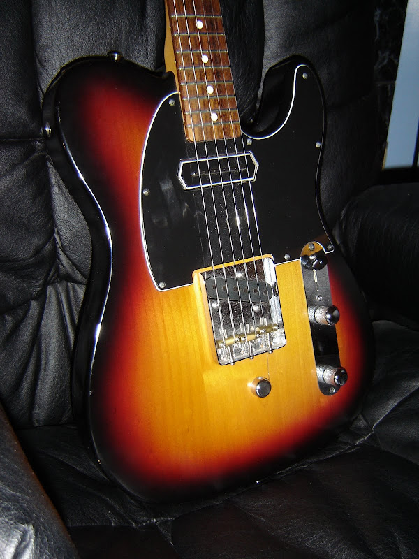

My STL50 with mods
Before:
After:
Here's the list of changes:
  • Graph Tech Tusq Nut ( PQ-5010-00 pre slotted flat bottom for Strat style) from Anthillmusic.com
  • Roller string trees from Guitar Fetish
  • Stainless steel saddles from GFS
  • Wilkinson EZ-LOK locking Tuners from GFS
  • Mother of Pearl Pickguard
  • Copper Shielding Kit
  • Pearl Shell Top Knobs from GFS
  • Sprague Orange Drop Tone Caps
  • 3 Way switch
  • 1/4" Mono Jack
  • "Modern Vintage" Lil Punchers
i just finished withit today and Im feeling pretty good ... on to the next one!!
Or i could paint over those green walls in my basement...

hi there, nice job, lovely guitar
a lot of those mods are on my list
quick questions:
the radius on the sx fretboard is huge (13.7")
did you just buy a regular tele nut?
did it work as it was or did you have to mod the nut?
are you happy with the ezlok tuners?
im trying to decide,i kinda the kluson style if they fit?
many thanks

Thanks
That was the exact model # of the Graph Tech Tusq nut I used. I'm sure the nut has a tighter radius than the SX necks, but not so much that i notice. I did have to sand the bottom down to get the right height, and the string heights across all 6 are working fine for me. If it came right down to it, i could cut the slots a little deeper - but I didn't see the need.
Similarly - I also used the black Tusq equivalent for my SX SST Ash (PT-5010-00) - same positive results.
The Tuners are good - they work. the hole size in the headstock is 10mm so most any 6 on a side machine that fits 10mm should be ok.
I don't know that the locking style tuners is really necessary, but I don't have any complaint about these.
good luck with your project!

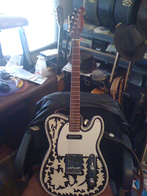

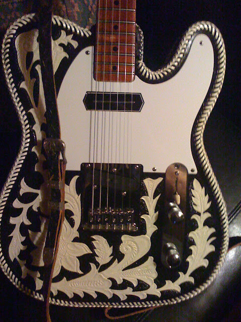

Originally Posted by AtlantaSpike View Post
My SX. Waylon-style leather cover, Lollar Charlie Christian and Special T pickups, Warmoth neck cut down to match the one on my '53. I am quite pleased with the results aesthetically, tonally and financially.
We have exactly the same taste in pickups:
Play.
