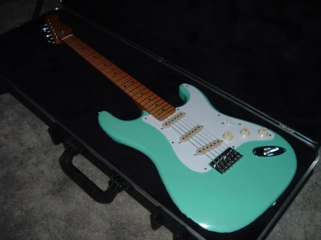

Here's my old MIM strat which I stripped right back to the wood and then sprayed with with a rattle can - the nearest colour I could find to Sonic Blue.
I think it's slightly darker than Sonic but not as deep blue as Daphne.
As I'm not averse to a relic appearance I left some of the original dings in the wood and it's already got a few small nicks and scratches in the new finish - but they're all genuine use marks rather than deliberate relicing.

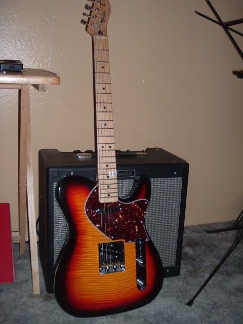

my humble submission
not as beautiful as the more experienced finishes here, but i do love her.
the most outstanding feature is the custom made reverse headstock
medium/soft V neck with a six and a half inch radius. unique and comfy.
