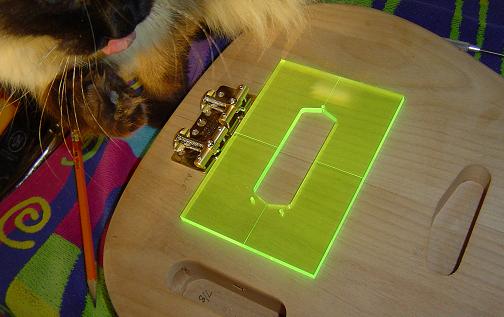

this photo was in the custom shop calendar a couple of years ago. i always wanted a bass that goes with this set.
buckocaster51 was able to match the sparkle and will be helping with the body. i did some mods on the body before shipping it to him. here i'm using one of my laser cut temps as a square to line up the bridge:
(note the shop princess in upper left corner)

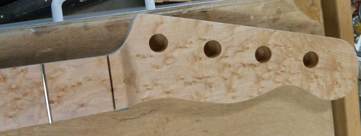

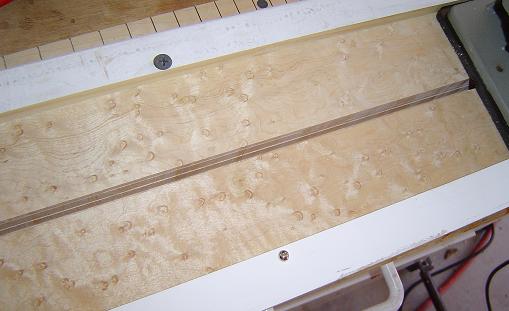

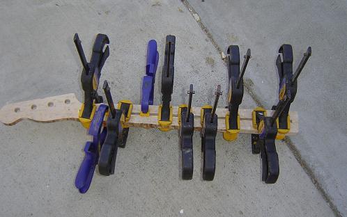

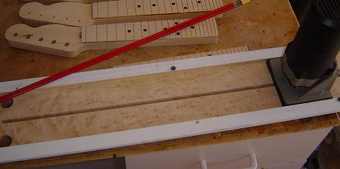

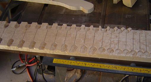

The Neck
mamma bought me a nice birdseye neck blank for fathers day. started working on it:
slotting the scale to the neck
slot for the double expanding truss rod
slot complete, shown with rod
the rod and fillet glued in the neck

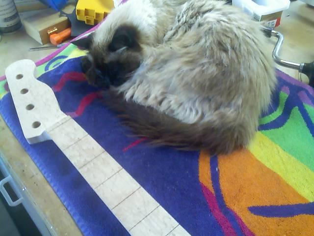

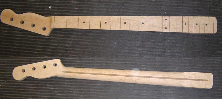

Neck Carved
just need a little more fine sanding, and this one is ready to be fretted:

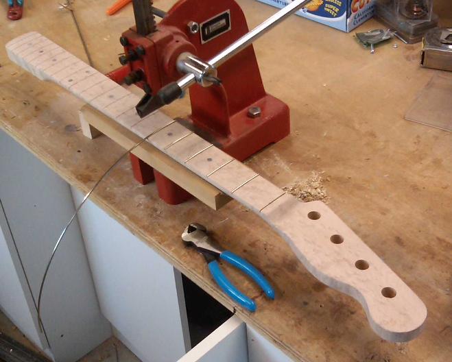

More Progress!
buck has finished the body finish, and it is back in California:
i've been working on his and getbent's mando necks, and figured i better do some work on this bass neck:
pressing in the frets
ahhhh, look at that maple
