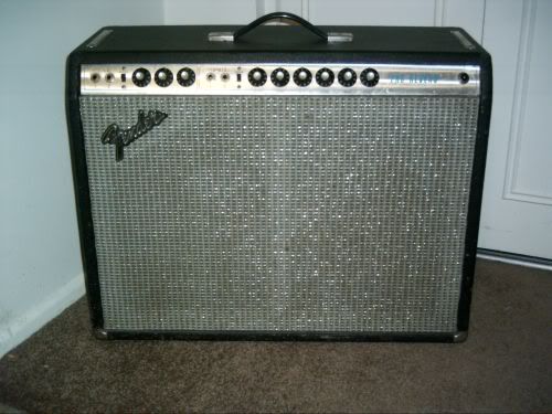

i just scored a silverface pro reverb fpr 150 bucks. works great and sounds good to boot . but i have been reading and something jsut aint right fender told me it is around a 1978 . they dated the transformers. 606 8 12 .but i have been reading that the 1978 pro reverbs have a solid state rectifier and a master volume. mine dont have either it it all tube and no master volume and it says 40 watts on the speaker jack. can some one enlighten me here . it has reverb and vibrato , 2 12inch fender utah speakers . 2 channel

According to the Fender Amp Field Guide, they all had tube rectifiers. I'm guessing yours is a '76 or earlier.

Does yours look anything like this?
This one is a '72. I've had it BF'd by a tech and I've loaded it with Eminence Cannibas Rex speakers.
Non Master, Tube Rectifier, 40 watts, etc.

Yeah Fender didn't do away with the Rectififer on the Pro Reverb until it got brought back with Single 12" C12N speaker.

The 70 watt models that came out from about 78 had a SS rectifier and mid-range EQ as well as MV. However tube rectifier models with the master volume and no midrange EQ started appearing from about 74. I think you have got yourself a pre-MV at a great price. Does it have an aluminium strip around the edge of the speaker cloth? If yes, it is a 68-69. If not, it is a 70-73.
What is the serial number on the back panel? Greg Gagliano has a date-abase that might be useful.

mine has no master volume , no mid , it does have the silver ring around the grill cloth . the serial number is a12179. it look a like the one in the pic just with the stuff i mentioned above.fender told me it was a 78 cause of the date on the traany but when i read the date gudie on fender.com it says 8 would be 1968 . i think he got it messed up. it seems more like a 68 to me.

Silver ring around the grille? You have a 68, not a 78. Fender has forgotten their legacy, they're clueless today.
Paisley plays Dr. Z amps. They're voiced completely different than a Fender. Don't get carried away with too much nonsense pedals. Learn to play and forget that crap. If you want Paisley tone, get a Z.
With that said, a 68 Pro Reverb can be a mighty fine amp with some massaging. Cap job, new tubes, BF mod, elbow grease to clean it up, and of course a pair of Weber speakers.

Is there a tube chart inside the back of the cab? Depending on whether its says AA165 or AB668 you have a blackface circuit if 65, or early silverface if 68 (not all that different).
