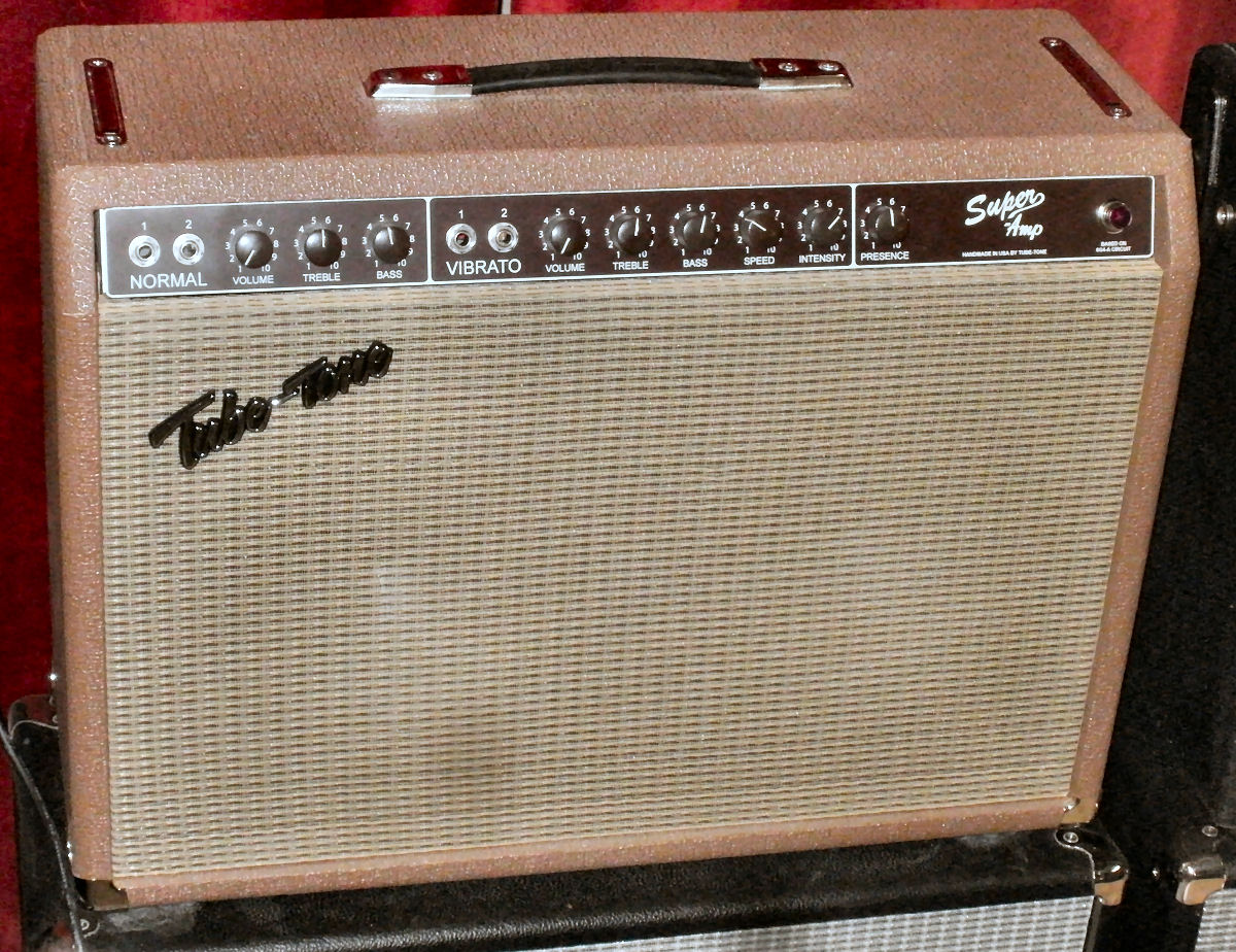

I just finished building our first brown Super at Tube-Tone. It's not on the web site yet but will be sometime next week. Totally amazing. The Fender brown circuit is an overlooked gem, I think. I've always concentrated on the black face Fenders. Built a Tweed Bassman and heard that raw, un-hi-fi sound. As Fenders evolved, Leo was trying to clean up the tone and make it more "hi-fi" as there were no clean steel guitar amps then. Blackface is much cleaner than tweed, but the circuits in the brown Fenders are a SWEET compromise between the tweed and bf, IMO. So much more variation in adjusting the tone controls, especially that tapped treble pot.
Tremolo on the Super is amazing, shifting highs/lows, not loud/soft. Unique to the brown Super and brown Vibrasonic. We'll be adding 3 new browns to the web site at tube-tone.com, the Vibroverb 6G16, Super6G4-A, and Vibrolux 6G11 (with added tube reverb).
Tube-Tone Amplifiers
Raybob is offline   Reply With Quote

Price for the Super is $1850 USD. Shipping Super to UK is $270 USD via FedEx. I do now have one complete Super and one Vibroverb ready to ship. Both amps have Weber (2) 10F150T (broken in on Variac). Need extra day to swap in EU tranny if needed. Normally 4-6 weeks build time from ordering.
