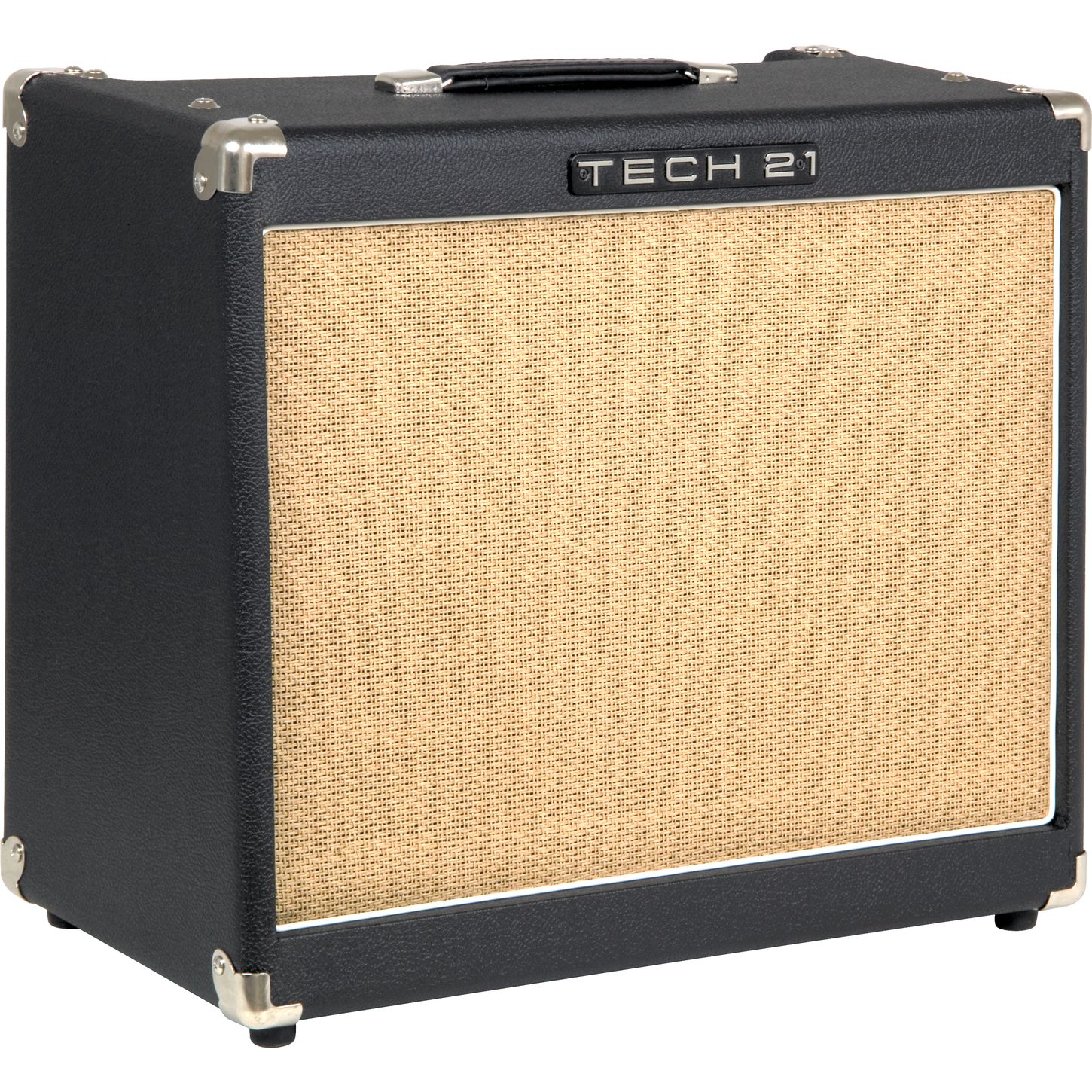

A company built that exact amp. It was a solid state amp with a 1 x 12 and a space on top for a POD. Who the heck made that thing? You could study it online for ideas.
John
"The rock and roll business is pretty absurd, but the world of serious music is much worse." - Frank Zappa
Old March 25th, 2012, 07:34 PM   #5 (permalink)
studio1087's Avatar
Join Date: May 2003
Location: Near Milwaukee
Posts: 13,893
Tech 21 Power Engine. They still make it. 60 solid state transparent watts and a Celestion in a cab for use with a POD or anything like a POD.
http://www.tech21nyc.com/products/po...rengine60.html
John

I recently picked up one of these for low-volume gigs. I run my usual pedalboard into one of these and then into the powered speaker, which has a neat mic stand mount adapter. Works great.
