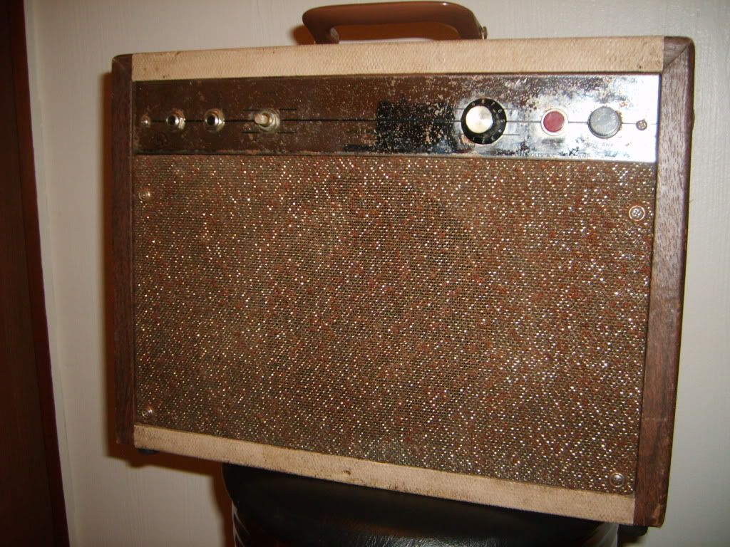

This is a low watt amp, maybe 5watts. I bought it to play the harp through, but I have been playing my new pink paisley tele through it. The tele barely gets the amp to distortion, though when I picked it up the previous owner demo'd it with a Les Paul and it distorted nicely.
It is an Airline 62-9022A made by Valco. It looks to still be all original including the two prong cord. It has two inputs though I can't hear much difference between them. A tone knob a volume know (which turns on the power), the power light and then the fuse.
The tubes are 12AX7 pre-amp (just says USA 12AX7 no other markings), 6V6GTA Power (RCA USA), 5Y3GT rectifier (RCA USA). There is also a metal canister thing between the power tube and rectifier.
The speaker is a USA Jensen 308Y21D1.
The power transformer shows no markings, but the other transformer (not sure what it is called) says T2640, 524 65 37.
Looks like someone taped over a sticker underneath the chassis so I'm assuming it is a serial number, but not sure, 1-44291
Here are photos of the GUTS:
I got a little surprise when I opened it up The inside is very clean.

KIrsten, that map is from 1965. AS for distortion capability, it is all in the input. THe power capability of the pickup/s is one part of the equation. The volume knob on the amp is one part, the volume control on the guitar is another, and the pick attack is probably the most important. That is, you can set the tone and volume controls on that amp at 10 with guitar controls at max; and if you use a light pick attack the amp will not distort. Hit the strings harder and distortion will occur.
Naturally, a more powerful pickup...whether single coil or humbucking....will cause the amp to distortion earlier andmore aggressively.

Wally is exactly right. With a simple amp like this it is all about the input voltage.
A single coil pickup, at full volume and full whack from your playing hand, will typically generate a voltage of somewhere just shy of 0.5 volts, a humbucker somewhere over 0.5 volts (but probably less than a single volt.) A harmonica mic might generate upwards of 3 volts.
Which is also one of the reasons why amps that are voiced for harmonica often sound so bad with a guitar plugged in.

Imho, that little JEnsen is a great little speaker. WE all have our own experiences and ears, though. Observation....a 6L6 would create a mismatch for that circuit.

FWIW, that metal can thingy contains the filter capacitors for the amp. Does the 12AX7 have little white dots etched in a pattern somewhere? If so, it's a GE.

I did have the amp all the way up and the guitar volume all the way up. I think the pickups in the paisley just aren't that hot. It did distort, but not that much. I haven't tried it with the harp yet but will have time tomorrow to do so.

I'm away from home and I only have one guitar with me so I'll have to try some others. I think the issue really is the pick-ups in the guitar I'm using. I've been celebrating my Mom's birthday so haven't been able to play with my toys very much.

Single coils...weak ones as in stock FEnders....often fail to push an amp like this enough to get into that smooth creamy distortion. HEnce the need for pedals to avoid that harsh, raspy thing that WArm Gums describes. A good boost pedal such as the SD pedal that Mike Eskimo mentions woudl work wonders for you. Email me when you get home if you want.

Just nosing around guys. And I happen to notice the Airline 62-9032 in this thread. I have the exact same amp, found in an attic. Somebody covered the original cab with woodgrain contact paper, but after removing it and cleaning it gently, it is now pristeen,, original, sounds great, and sitting in my family room. Original tubes, Jensen speaker and grill cloth. Unmolested. Very plain knobs on the front. Plain brownish black, no numbers. I was gonna gut it, and build a bigger amp. But now I don't know. Any real value here?
