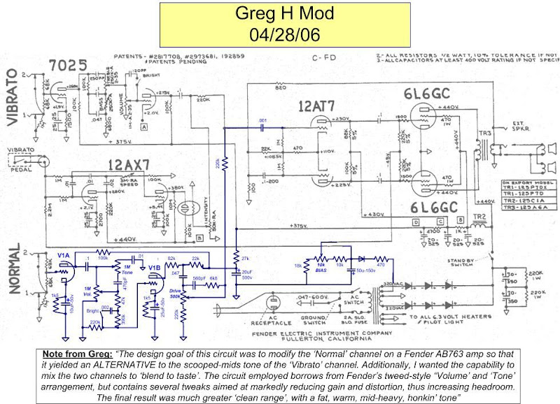

If you dig the brown Fender tone stack, then the GregH mod is a great way to go with the normal channel (linked below). Greg Huntington was a great guy and really knew his brown Fenders inside and out. The amp community lost a major resource when he passed. RIP and thanks Greg.
