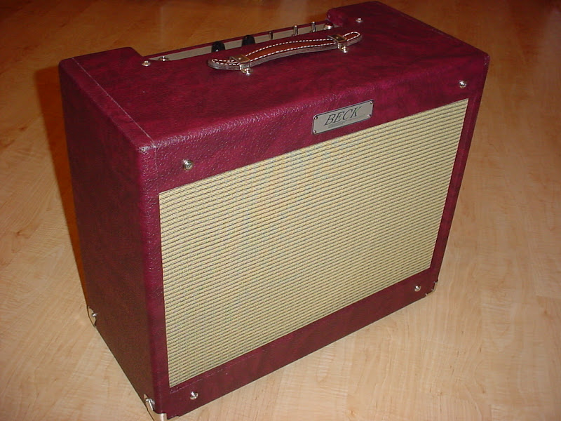

I built a 5C1 as my first DIY as I have a soft spot for 6SJ7s. I modified the circuit slightly to make it cathode biased rather than grid leak biased, but it's basically the same. It sounds very nice into an Eminence 10" alnico (blue frame) speaker, but I wouldn't call it a gain monster. It's very touch-sensitive, so you can easily control the breakup from the guitar, but I don't think it compares to the nastiness of the 5F1 circuit cranked. It obviously depends on the pickup output, also. But for old-school blues, it's absolutely perfect. Indeed, it's raw and loose, and a lot of fun to play. It's the cream tolex amp in the picture.
My second project was an early 50's Gibson GA-20 based amp, also with the 6SJ7 preamp. It sounds very similar to the 5C1, but it does have quite a bit more gain due to the phase inverter adding it's helping of gain along with the 6SJ7. Everyone who's played it goes ga-ga over it. Sort of a one-trick pony also, but what a fine trick it is!

The amp (both of them, actually) is scratch built. Finger jointed pine for the cabinet and the raw chassis for the GA-20 from Komboking, but it doesn't look like he's making chassis at the moment. The 5C1 just used a Bud aluminum box for the chassis. The 5C1 used trannies I had laying around that came out of some sort of Sony tube reel-to-reel, I believe - nice beefy power transformer and 5k primary outputs. The GA-20 has custom Electra-Print Audio Co. transformers.
The burgundy tolex came from Vibroworld.com. I've had two different versions of it, one is more an elephant style, nice and heavy, the other is a more thin, grainy material. I think the Burgandy Crush is the thinner one, and the Wine Taurus is the nice one. Grill cloth is just standard Fender stuff, wheat for the GA-20 and oxblood for the 5C1.
I did have a custom faceplate and nameplate laser etched out of champagne (gold) Alumamark for the GA-20. It really adds the classy touch to the amp rather than rub-on lettering, etc.
Cabinet dimensions are I believe tweed Princeton for the 5C1 and tweed Deluxe for the GA-20. I really like the tweed style cabinet, narrow panel in particular, even if I'm not building a Fender circuit in it. It just works, it's easy to build, and makes servicing and tweaking the amp a snap.
That said, NEITHER of these amps is particularly "home" friendly if you want to turn them up. 5 watts for the 5C1 is loud as heck, and the 12 watts from the GA-20 is just insanely loud at home if cranked. But, if you can live with a big, round, warm tone at lower levels, and maybe a hint of grit, either will be great. With decent parts and transformers, and a matching alnico speaker, these amps will breathe, shimmer, moan, and bark. Every nuance comes through due to the low parts count - there's not much in there to screw up the tone.

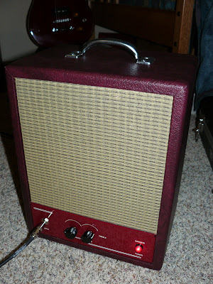

If you want to crank it up and be the dirt-monster - build one of these: Moonlight amp I recently finished it up using yet more junkbox parts, and another Bud box, burgandy tolex and grill cloth. Speaker is a Weber Sig 8S. Clean headroom is about zip except at a whisper, but it will do some great old-school distortion for blues or classic rock. I'm not sure of the cause, but it's a darker amp than either of the other two. Could be the cheap Allied output tranny, maybe just the circuit EQ, but it sounds great cranked up because that darkness keeps out any harshness. Even still, it's pretty darn loud.
